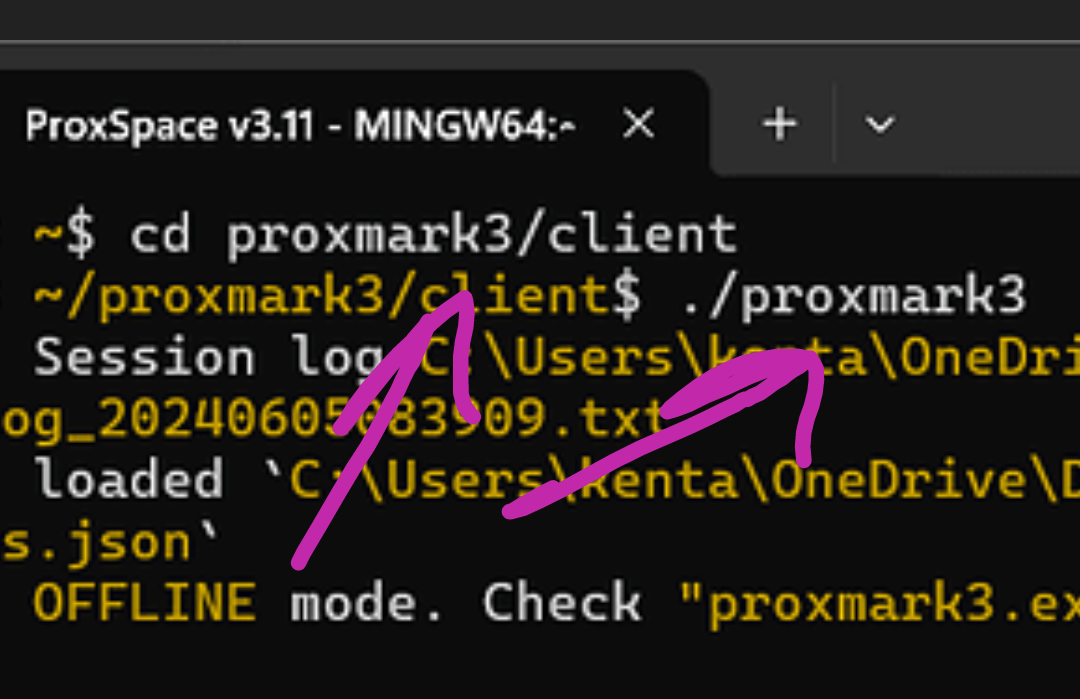

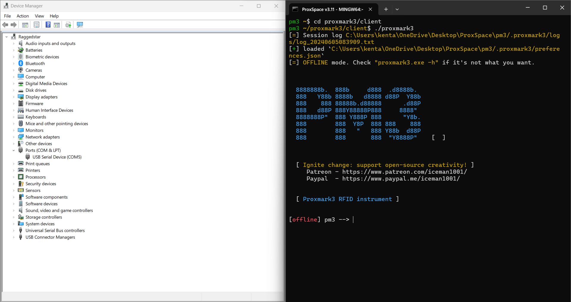

After a fresh boot of proxspace, it shows that the pm3 is offline. On the left it does show that it is connected (the set up tutorial says it should be com6, but mine shows as com5), Near the top of proxspace it says its in “offline mode and to check “proxmark3.exe” if its not what you want.”

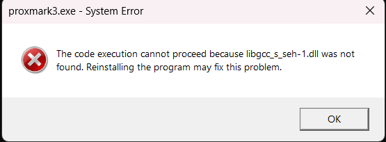

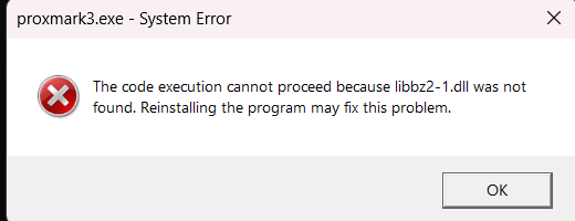

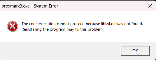

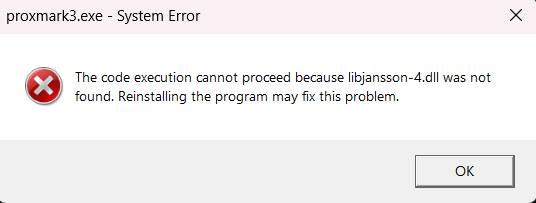

After searching the proxmark3 file that was downloaded and where im pretty sure everything is kept, these are the errors that pop up when I run the executable. When I ok through them all, it just closes the window.

So to start, the video tutorial did say that one of the ports on the PM3 is the “correct” port and used the bottom port for the tutorial. Im pretty sure I used the side port for my original flashing and re-flashing when I was at work as I wasnt (and still am not sure) there was a difference and what each was for.
However, after unplugging the PM3 and letting it sit for a couple minutes, the problem seems to only persist and show as “offline” when plugging it into my laptop. Plugging it into my PC does show the PM3 as connected.
From here, Im assuming it might be something to do with proxspace on my laptop and am going to try a full reinstall of proxspace on my laptop
One of the ports, I believe the one on the short side, is for data and power, it’s the one you use with your computer
The other port is just for power, it’s for using the PM3 in standalone mode

Why are you launching the client this way? Use the ./pm3 script instead as the script will find the port for you… I think this is your issue. You are starting the client without specifying a port so it goes to offline mode by default.
At the end of the walk through I was using to originally set up the PM3 (this one thats listed in the product description), it lists near the end to do it that way.
However, in the file that came with the new binary on the PM3 when launched, I dont have to do any of that, it just waits to see the PM3 to be plugged in and does everything it self.
