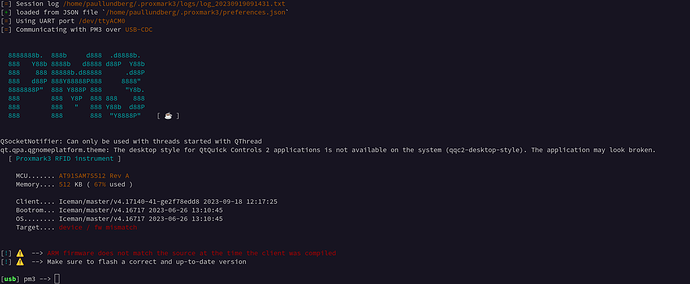

Im still pretty new to the proxmark3 but I ran into an issue. After succesfully flashing and running the PM3 on windows without any issues i later installed it on my linux machine. After doing this everything worked fine untill i ran the ./pm3 command and got the “Target… device / fw mismatch” warning. I cannot for the life of me figure out what the issue is. I double checked my Makefile.platform file. I have run the Make clean && make all command countless times and reflashed many more times. Even when i try to correct the damage on my windows machine i cant get the mismatch error to go away. There are no other errors either while flashing so i dont know why this is happening.

In order for your proxmark to work, client, bootloader and os/firmware of the proxmark must be the same.
What proxmark do you have and what is in your makefile.platform
Also sharing the exact mismatch message would help a lot :slight_smile:

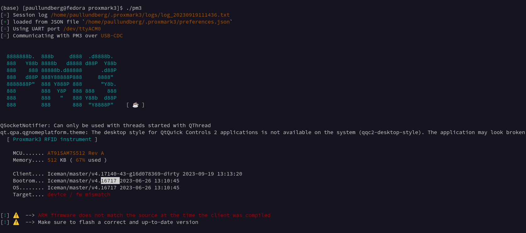

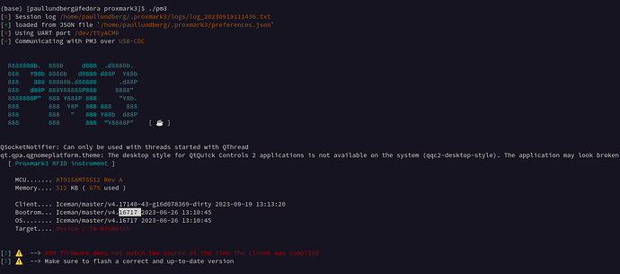

I flashed the bootrom and fullimage in dfu mode but the issue persists. here is a screenshot of what the pm3 software shows at startup

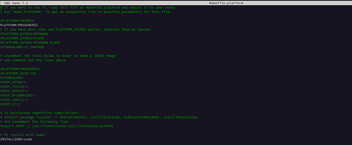

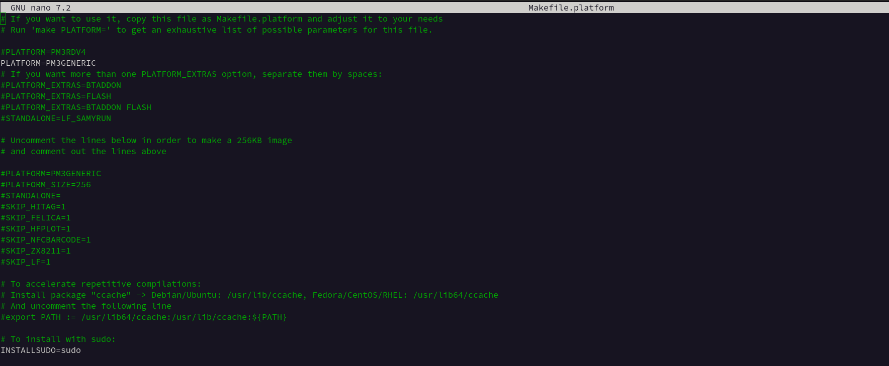

I dont know if the qt warning has something to do with this or not. As per your second and third questions, I have the proxmark3 easy that was sold by dangerusthings and here is the screenshot of the Makefile.platform
Hey,
if you see in the screenshot, the client version is diff from the bootrom and os. This is the cause of the issue. In order to address it you need to flash your proxmark as I mentioned.
It seems you’ve cloned the latest master branch on the linux box, and build from it. That’s fine.
On the windows box it seems you’re running the previous stable release.
Unfortunately this wont work as is, in case you want to have both windows and linux using the device.
My next suggestion, reinstall proxmark on windows - current stable is 17140, then flash the divice bootrom and firmware, go to your linux box and clone from 17140 tag, then make it.
This will make both os clients the same and they will be able to comm with the device just fine.

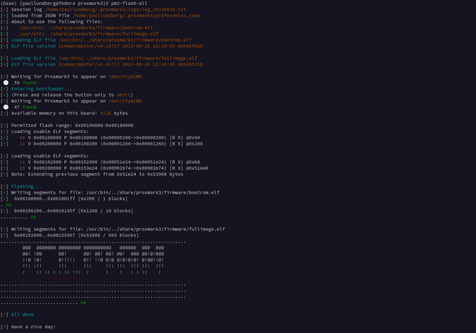

Nvm my previous question. I am however still having troubles flashing the pm3. Whenever i flash it i get "ok"s however when i then start the pm3 software it says it is still using the old 16717 version. I have tried the button trick but the issue remains.

I think I know what is going on here.
Check the output of the flash command.
It takes the files from /usr/bin/…/share/proxmark3/firmware bla bla
By any chance you did make install ? or installed the pm from a package or something.
go in your proxmark3 dir, from which you’re executing the ./pm3
put the device in dfu, then ./pm3-install-bootroom after this is done ./pm3-flash-fullimage
This is default linux behaviour. if you exec in a shell ./pm3-flash-fullimage it means run it from the current dir, if you do pm3-flash-fullimage it will look into your executable paths.
