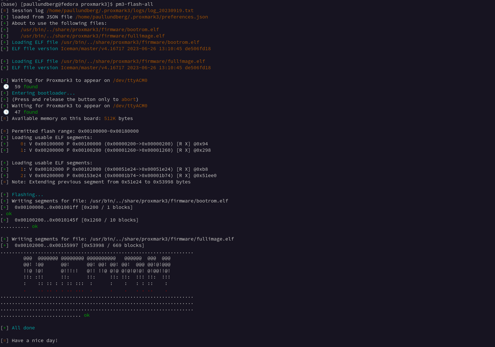

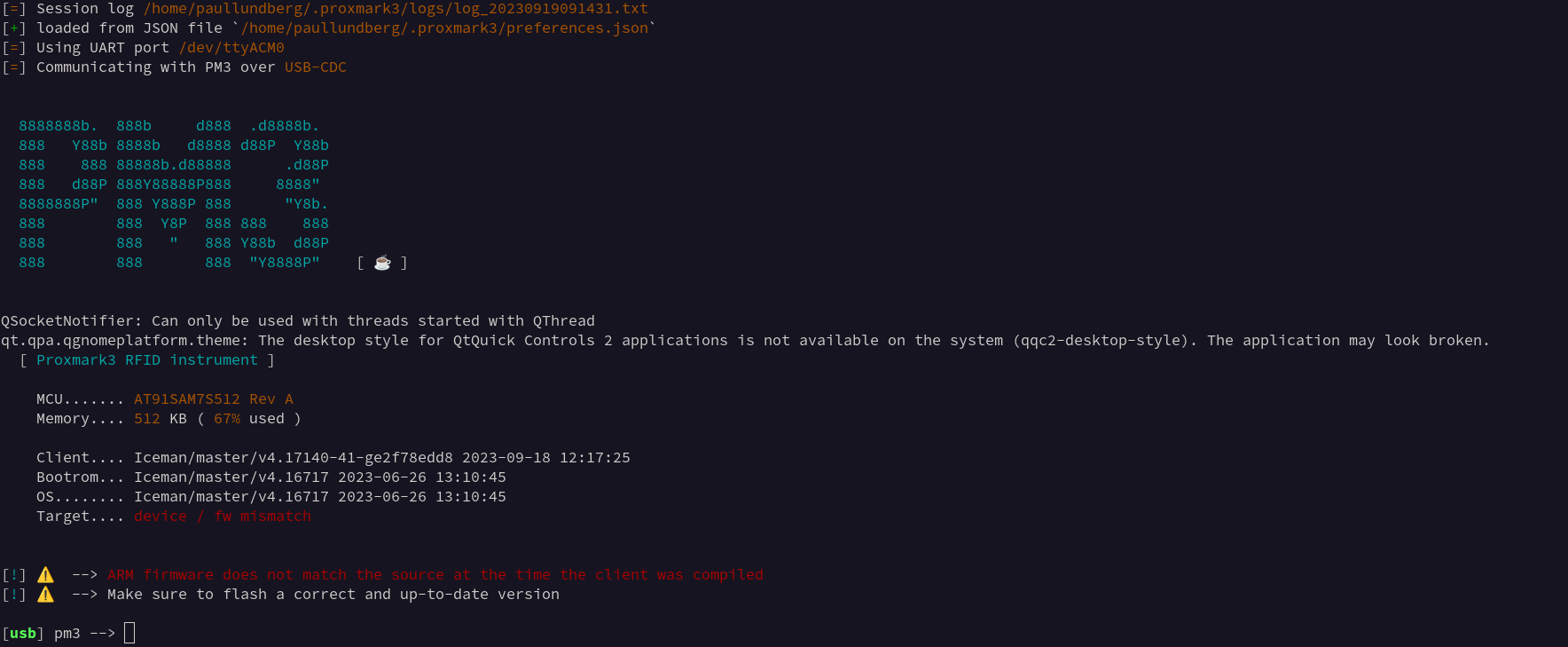

PM3EZ device / fw mismatch after flashing on linux [SOLVED]
You can check this out.
In order for your proxmark to work, client, bootloader and os/firmware of the proxmark must be the same.
What proxmark do you have and what is in your makefile.platform
Also sharing the exact mismatch message would help a lot :slight_smile:
