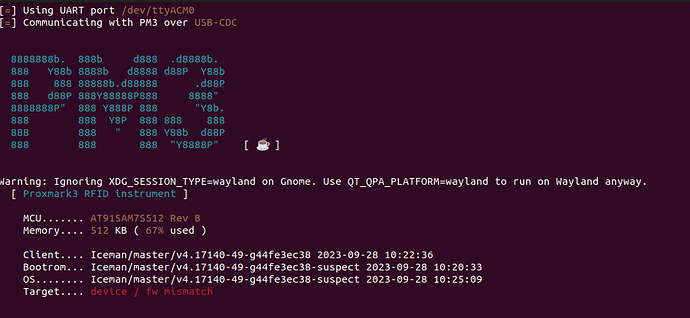

Hi evryone , I have installed my PM3 Via Brew and everything was working find .
Unfortunately I tried to Install it on my Ubuntu via VB and I have the message after flashing .
Target device /fw mismatch .
Please can you help me.

you must have flashed the version for the rdv4 instead of pm3generic

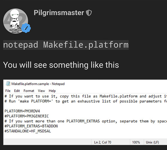

notepad Makefile.platform
You will see something like this
Change this ( just move the # )
PLATFORM=PM3RDV4
#PLATFORM=PM3GENERIC
to this
#PLATFORM=PM3RDV4
PLATFORM=PM3GENERIC
File - Save - Close

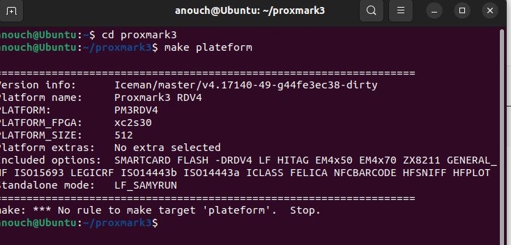

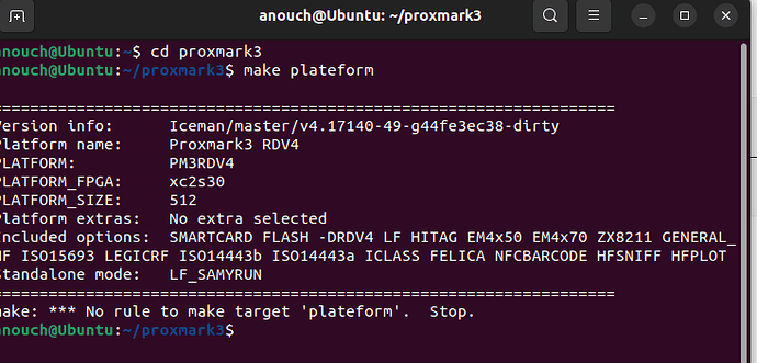

but when I do Make platform and I still Have RDV4 …
I went back To Terminal on my Mac
It’s not “make platform” it’s just “make all” … you can see the compiler errors out saying “no rule to make target ‘platform’”
I did make. make clean && make all and even sudo make install
and then Flash still the same message so then I went to Make plateform to see what was inserted .
This might be a problem as well because now you have an “installed version” alongside your compiled output… future updates via git pull may compile but likely won’t get flashed. I found this out the hard way after hours of confusion I had to blast the whole thing and start over.
It is the one Pilgrimsmaster showed me

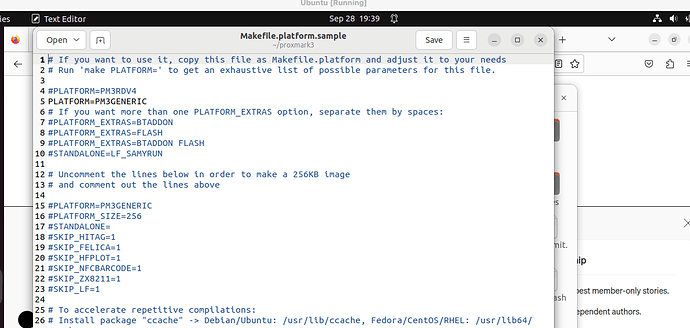

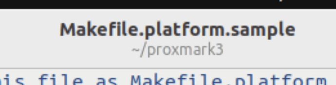

You’re supposed to copy the Makefile.platform.sample file to Makefile.platform and edit that. The reason for this seemingly extra step is so a git pull later on won’t overwrite your platform file.
If you’re not aware of this, it’s easy to assume you just edit the file that is there… but he did indicate the correct file.
… kinda. His notepad image does indicate the sample file haha
Edit… embarrassing… he got that image from my guide… I will need to update that image.
its fixed now ![]()
