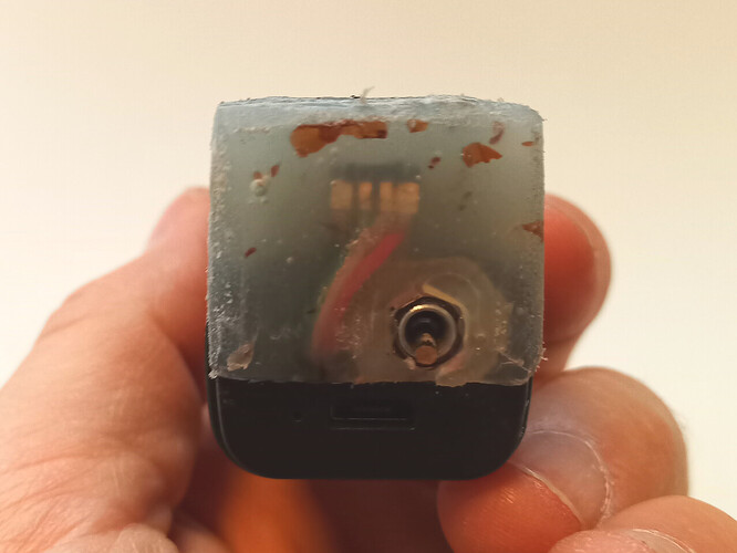

What this is is a slightly modified Fonekit 2500 mAh single 18650 powerbank that I found at my local big-box electronics store in the clearance bin, mated to a Digital Logic uFR Nano Online.

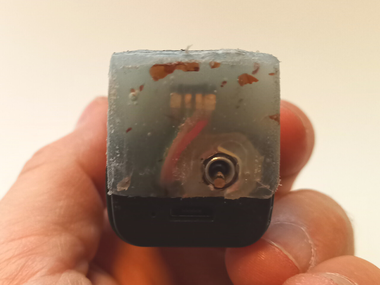

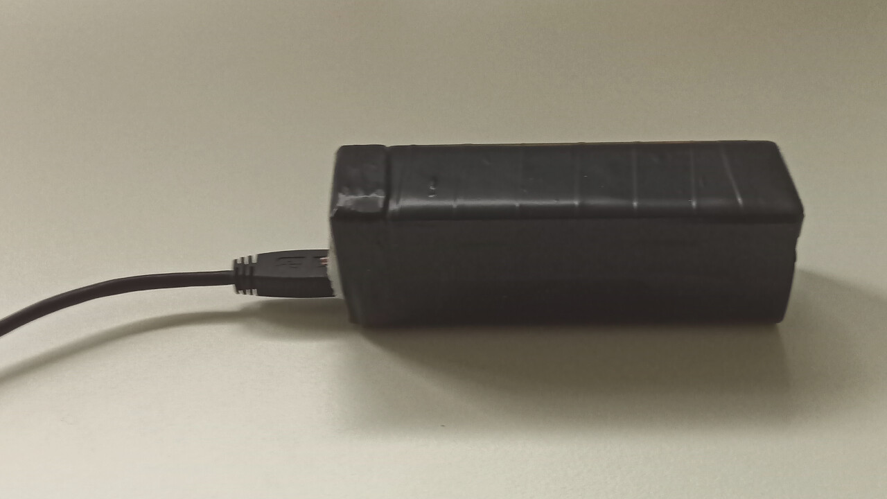

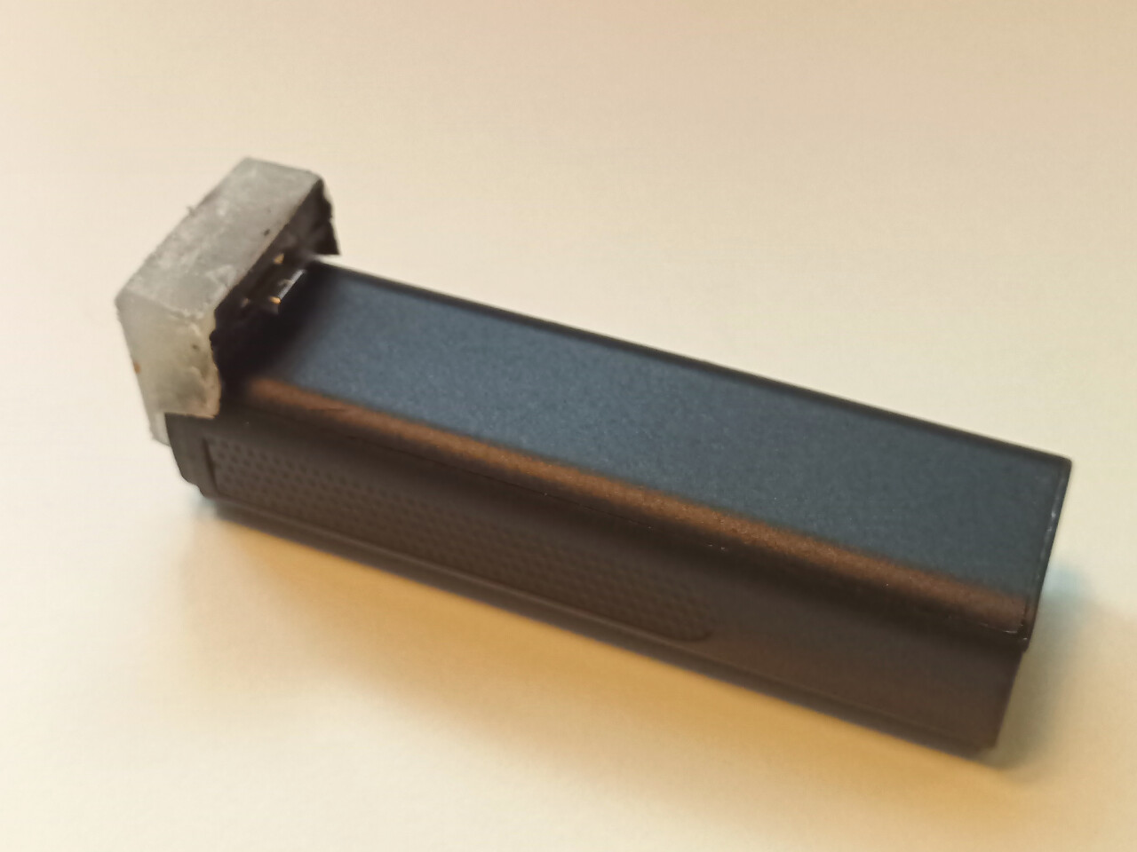

By sheer luck, the powerbank and the reader have the exact same width, and almost the same length. It’s like they were made for each other. I cracked open the power bank, added an ON/OFF switch, removed the regular USB-A socket and soldered the end of a micro-USB cable that I stripped bare and bent the soldered leads of 90 degrees, as close to the go-go end of the plug as possible.
I mounted the reader onto the powerbank at the right location, plugged the micro-USB plug, then potted everything in hot melt:

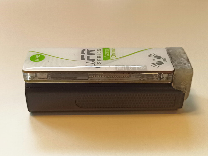

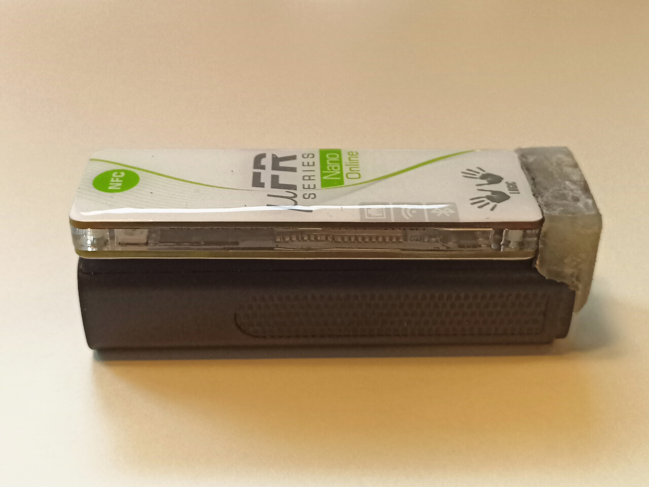

The uFR Nano Online is totally unmodified but mounts smartly onto it:

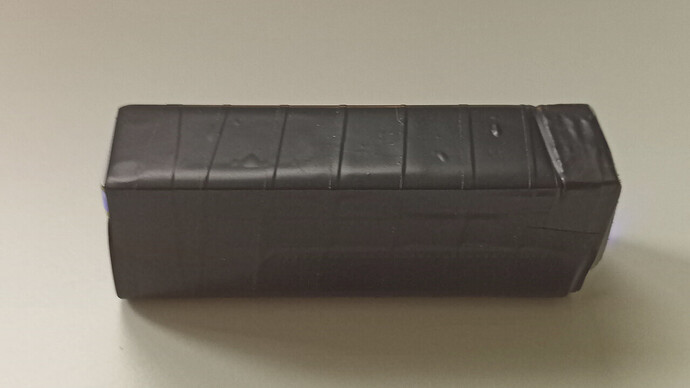

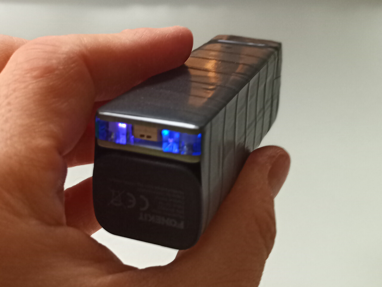

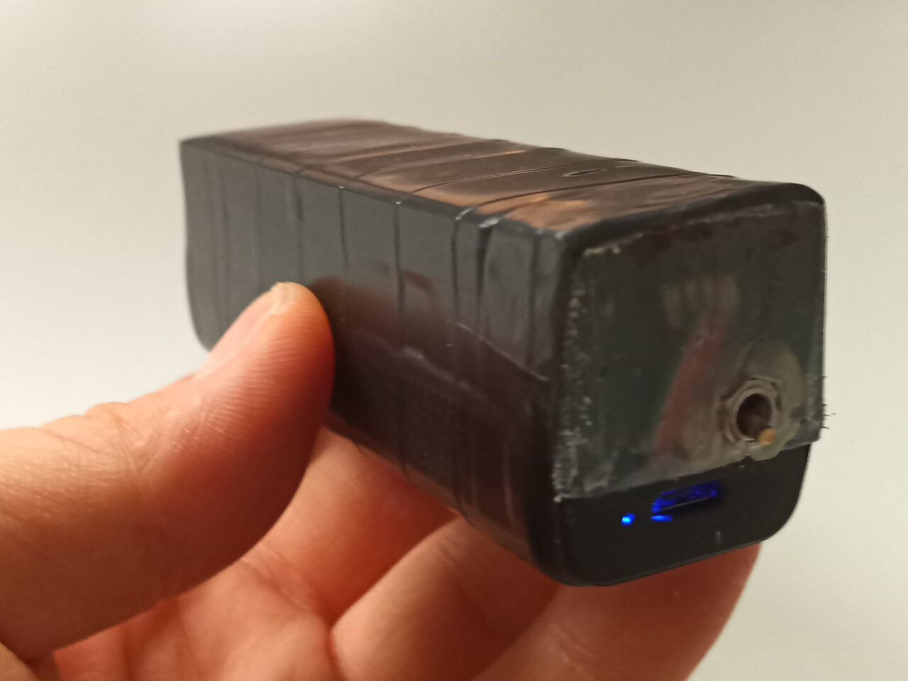

A solid helping of electrical tape secures everything in place and masks the ever-annoying flashing light on the side of the reader when it’s on.

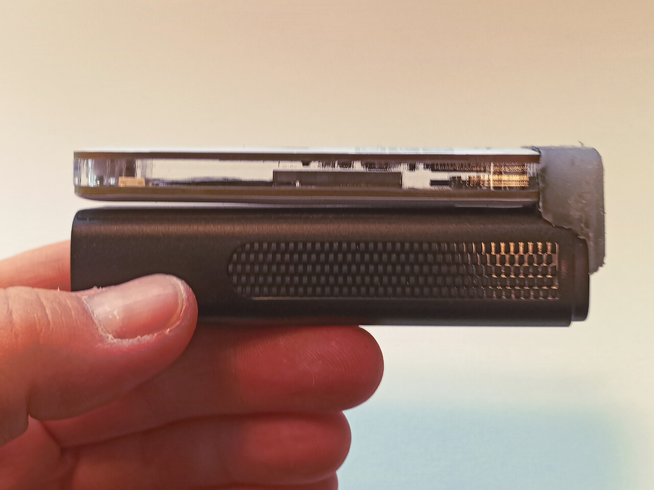

Concerns about taping over the vent holes?
No vent holes. It’s a transparent plastic spacer
Pff hah ok :slight_smile:
I am fearless. I shall tape over ANY vent holes - even fake ones :slight_smile:
Joke aside, those are grips - or something moulded to look like grips. Cuz you know, precise handling is important in the world of powerbanks.

You can disable the green flashing LED by running the command GreenLedBlinkingTurnOff.
You can find more information about this function on page 321 of our API document.
