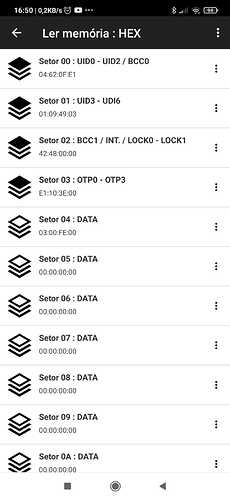

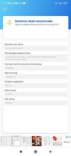

The first question is; what kind of chip is your source chip? Try scanning the source chip with
and sharing the full scan data here.
Here is a link to the reading file.
I understand your dilemma, but as we are looking for a technical question, thank you for your help.
https://drive.google.com/file/d/1nPXX5KYmNCP4J51ao4WDFYEHwJB4blUu/view?usp=sharing
Ok so it’s an ultralight tag. There are some magic chips that can work for that… one is called a magic ntag chip that can be programmed using a dngr.us/proxmark3 to look like an ultralight chip, set the ID, and copy the data. We don’t sell it though.
