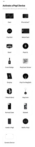

A while ago, I was fucking around with POPL, and whilst you can easily setup a POPL link and write that to your implant as an NDEF URL link; I also know they sell various NFC products, In the app, you can enable a new product, so I thought I would try a “bring your own” ( which they don’t offer by the way)
