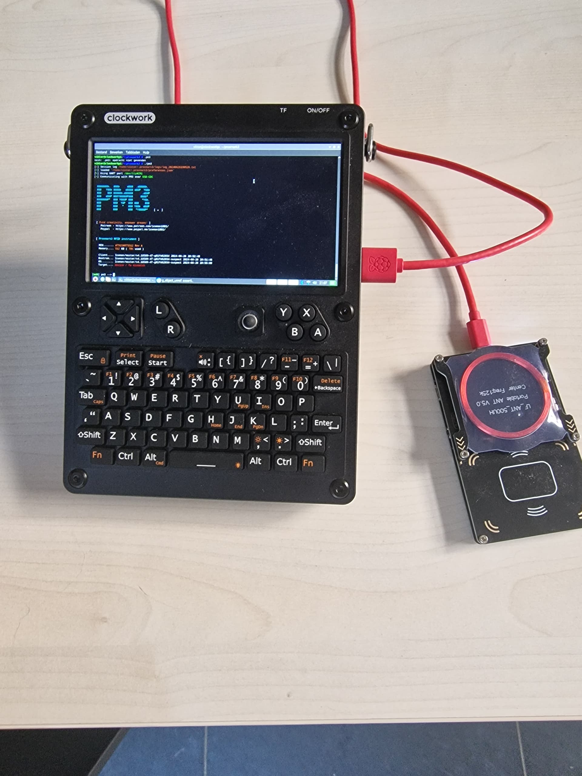

Hi guys,
I got my hands on a Clockworkpi Uconsole. Seems like a good way to use the proxmark3 easy on the go. The uConsole is based on a raspberry pi cm4. When i tried to run the program i keep getting the “fw mismatch” error. Tried the flash-all command, the flash-bootrom command without success.
Anybody got experience with raspberrypi and proxmark3?
I’m running bookworm at the moment. But I’m flexible :slight_smile:

Yes!
Compiling after the adjustments did the trick. Damn, my bad!
glad to hear it’s up and running!
Sounds awesome! What a great idea!
