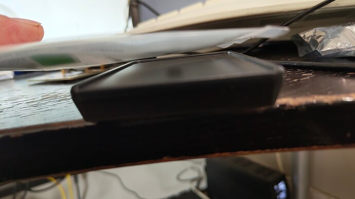

My FlexUG4 just arrived and I am seeing exactly the same behaviour and errors as above trying to read and program it with my PM3 Easy.
Do you have a Flipper or anything else to read it with?
If you do try and take the foil lube packet off, be super carefull, it’s glued on like crazy and easy to rip open the packaging. I sent mine back today, according to USPS tracking, they should get it Friday. Not sure how long it’ll take for them to do testing and re-sterilization so I can get mine back.
Alignment is key. You don’t want it in the center of the HF part. It should be alone the edge where the antenna traces are.
Thanks all for the prompt replies and help. I had the alignment correct but was receiving “BCC0 incorrect” and “card select failed” errors still. Giving it some pressure and pushing the PM3 down a little against the chip has it reading and configuring as expected now. I’m off to go book in the install. Thanks again!

Pressing onto the antenna i feel may be reshaping the field allowing it to read better, i doubt it is bad solder joints and i am wondering if there is a batch of chips that had the capacetence change.
Also note the Proxmark antenna is not amazing. and does benefit greatly from an RSP or one of @XEMON circular antenna’s
When the foil packet was still connected to the bag, the only way I could get any read at all was with the Flipper and a small MFGC.
After the foil packet was off, I could get a read with Flipper and chameleonultra but it still had to be touching. Tried a MFGC with the PM3 but didn’t get a read at all, that’s when I was thinking I had a problem with my generic PM3.

I have noticed though that the Proxmark3 Easy HF antenna is just not great at picking up most flex designs. I think this has to do with that magnetic field shape issue, more than raw power output or anything like that. There are also some oddities in the antenna design which twist the magnetic field up a bit in some key places;
Typically only one via is needed to cross over the spiral loop coil on a PCB to bring both ends of the coil to the oscillator, but for whatever reason they make the coil traces here do looptyloops not once but twice… it’s like forming a twist-knot pastry with the magnetic field, and this will fuck shit up with small antennas trying to magnetically couple with that mess. Larger transponder antennas will do ok with it because they have plenty of inductor spread across a larger area… and smaller x-series can avoid the mess by straddling just one small straight section of the coil path… but flex antennas are right in the shit zone.
The best place I have found for flex on the PM3 Easy is basically right over the serial number on the sticker on the back. Not the barcode, the serial number itself.
Having not looked specifically at placement, best guess is that’s about the only spot I was able to read it with my PM3, but also had to push down slightly on it. Of the 4 things I tried reading it with, the PM3 was the worst by far.
