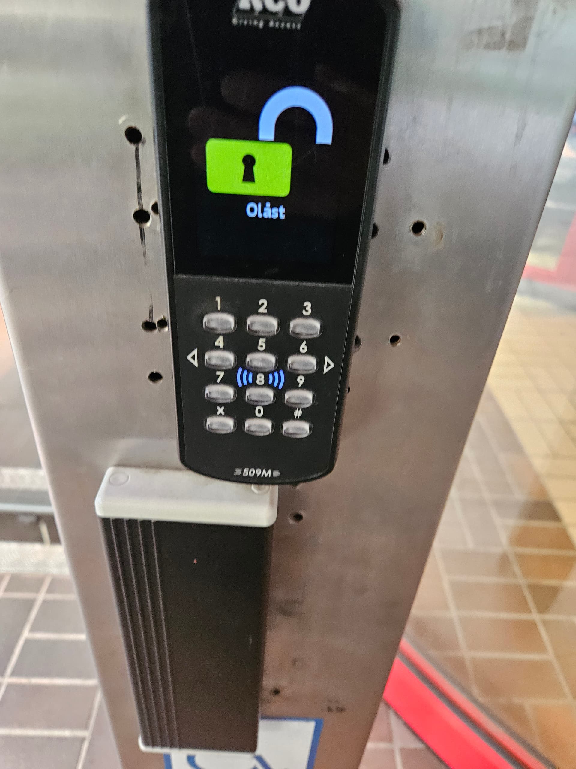

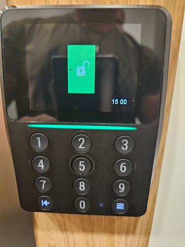

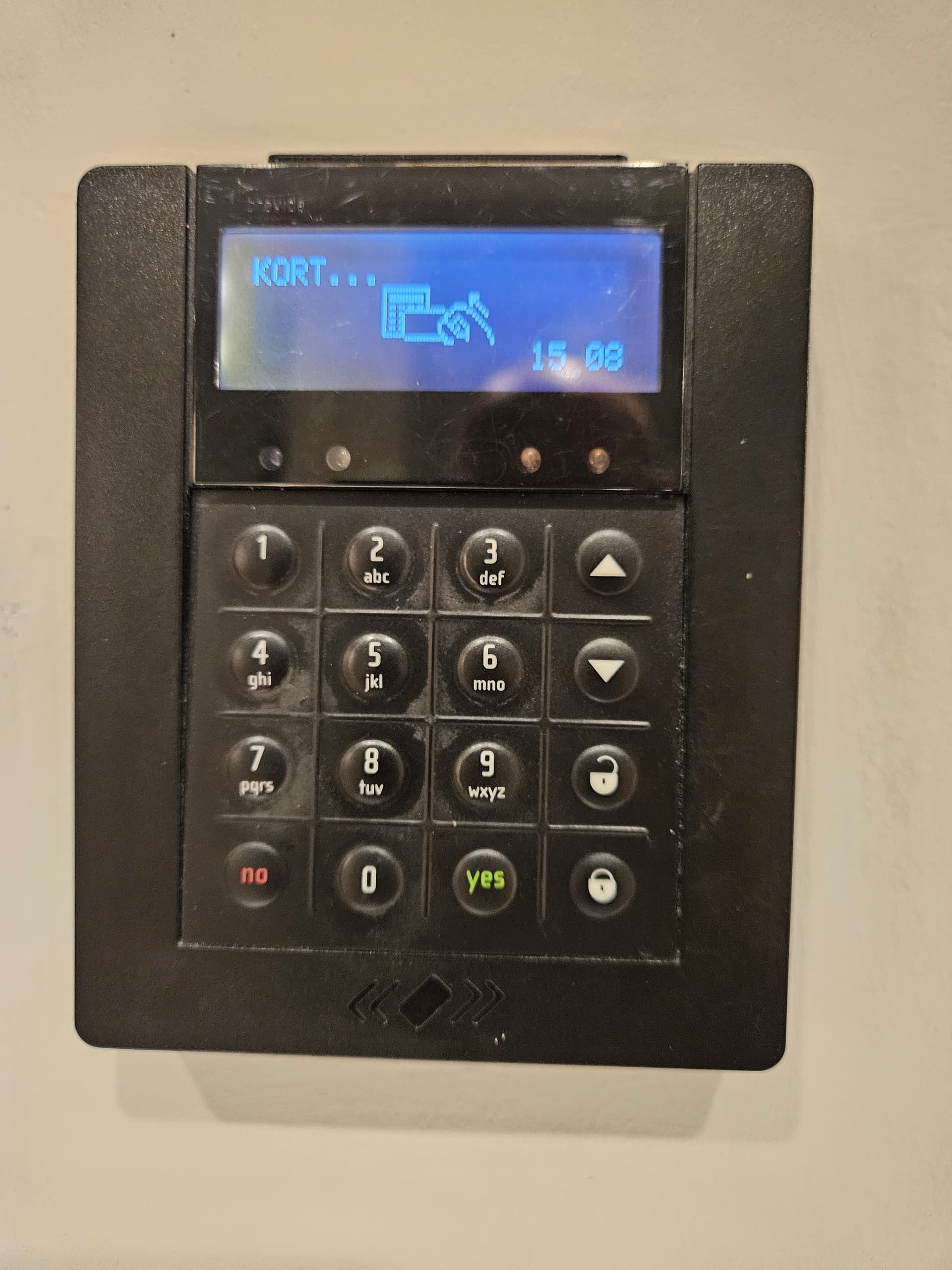

I’m unable to get the readers on work to recognize my UG4 (MIFARE 4K, 4-byte UID), but the readers don’t seem to care as long as the ID is the same. It works with Chameleon Ultra, Flipper Zero, MIFARE 1K Gen1a ring, and an XM1. I’ve tried two different brands of readers.
The hotel, which uses MIFARE Ultralight EV1, works fine on all the readers.
At the gym, it works on 2 out of 3 readers from different brands.
Can I ask what readers you have at work? Maybe I (or someone else) can provide some suggestions for placement and orientation
Unfortunately this is the first time I’ve ever seen any of those readers. Hopefully someone else can help.
Me too.
But definitely seen very similar ones.
I’m not too surprised you are struggling to read on some of them, but #1 looks like a reasonable chance, and #4 after that, but you really cant tell untill you get hands on.
What diagnostic tools have you run over them?
is there a posibility to get some old/broken ones to disect?
#1 I searched for the sweet spot with an X Field Detector and then tried the UG4. When I found the sweet spot, the XM1 worked. My Chameleon Ultra, Flipper Zero, and NFC Ring (Gen1a) work without any problems at all, but never got any success on the UG4.
I’m thinking of buying a FlexM1 v2 to use with the MIFARE 1K instead. It’s disappointing that I can’t use the UG4 everywhere, as that was the original plan. My FlexM1 v1(now broken) worked without problems on all readers for MIFARE 1K, so I assume the v2 will work at least as well. Can anyone confirm?
Unfortunately the x field detector is primarily meant to show the best location and orientation for x series implants, which are cylindrically shaped antenna coils. The flex series are not shaped this way, so the x field detector isn’t necessarily going to give the best result.
That said, x series must be presented to the reader antenna in such a way that it crosses over the reader antenna coil lines (perpendicular to), but the long narrow shape of the flexUG4 basically requires that it be presented parallel to the reader antenna coil lines. So, in this way, it should be obvious that if you present the x field detector at a specific angle (orientation), and get a string light from it, then you’ll want to present the flexUG4 in that exact spot, just rotated 90 degrees. Make sense?
