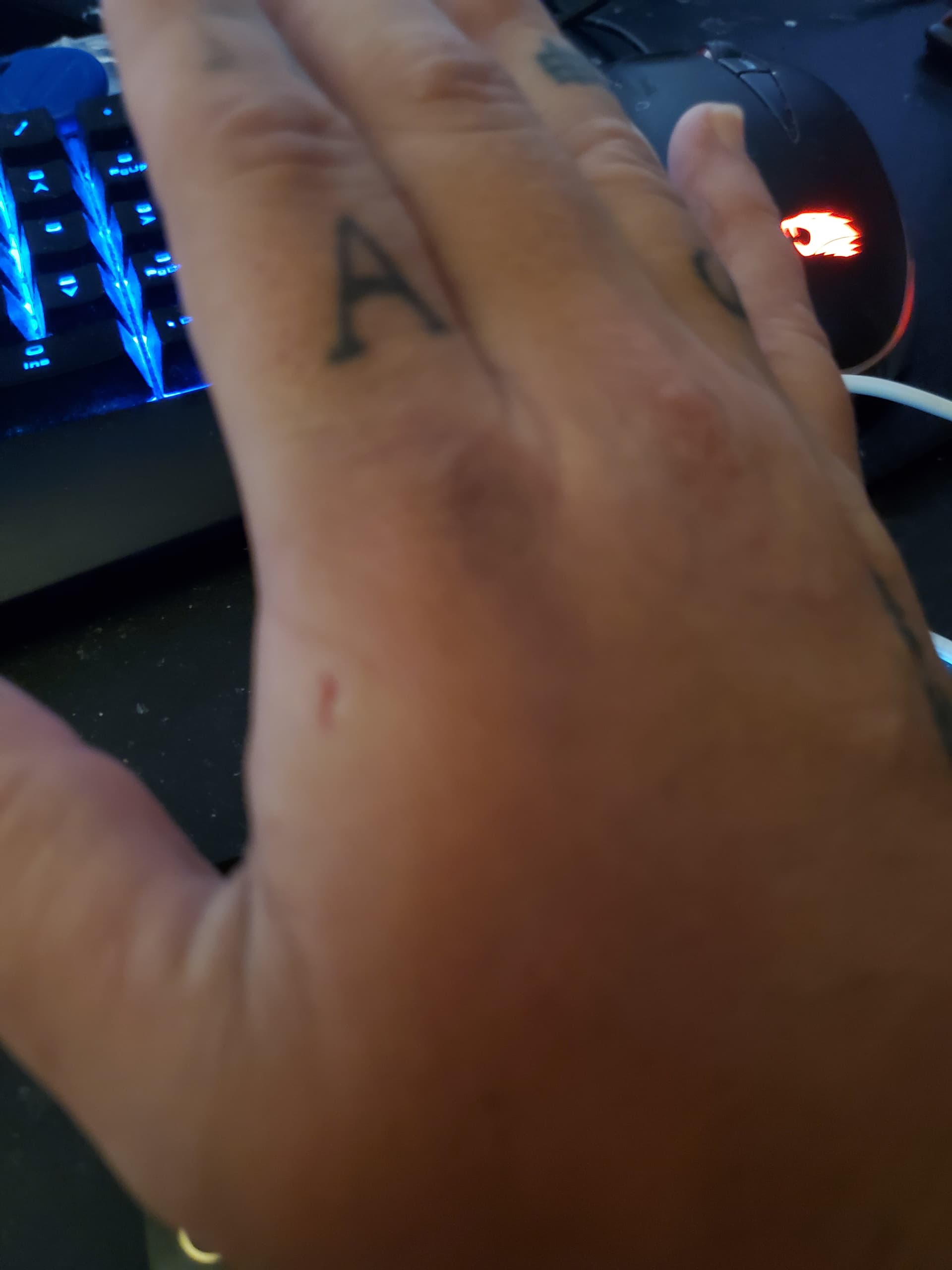

I tried through the needle to make a clone of the lf card. But the signal was weak so I thought I would do it through my hand. I was able to write data to the NFC with no problem. So I am trying to write the card from work to the chip. When I type lf tune I get something between 24V-26V and I canât read anything. What can I do?
The best thing you can do is wait for the wound to heal, and swelling to go down
Itâs extremely common for implants to be unreadable for a little while after the install, and I havenât personally heard of one that hasnât become readable over time
Another common issue however is the chip migrating, and trying to scan where there isnât a chip anymore, so do try gently feeling around for it or perhaps shining a bright flashlight through your hand to look for it
If you have any follow-up or other questions, feel free to let us know!

Thank you very much for your reply. This is my first chip and I am stressing out. Every next one will be easier. I donât have the swelling anymore, I even marked myself nicely with an eye spin where the chip is. The scanning area of the chip by proxmark3 is very small. Maybe there is a possibility to make it bigger. Then I can hit it easily.
It will never work through the needle. The needle acts as a Faraday cage. For the rest, just as @Aoxhwjfoavdlhsvfpzha said.
Welcome on-board!
Youâre not the first and you wont be the last.
You installed yesterday, I can almost be certain that you do have swelling, you may not be able to see / notice it, BUT under the surface will be some inflammation where your body is fighting / recovering from the trauma.
Trust us when we say, just wait, give it about 2 weeks to heal.
Even then, the PM3 can be a difficult bitch, you will need the antenna to be right in the correct spot, millimeters matter.
Let us know how you are going in 2 weeks.

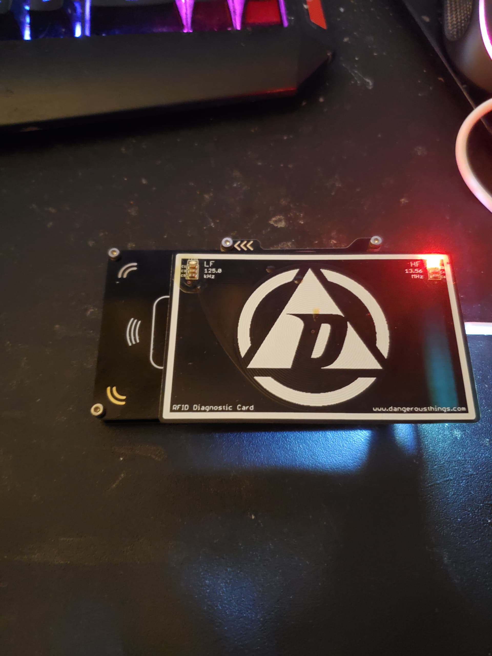

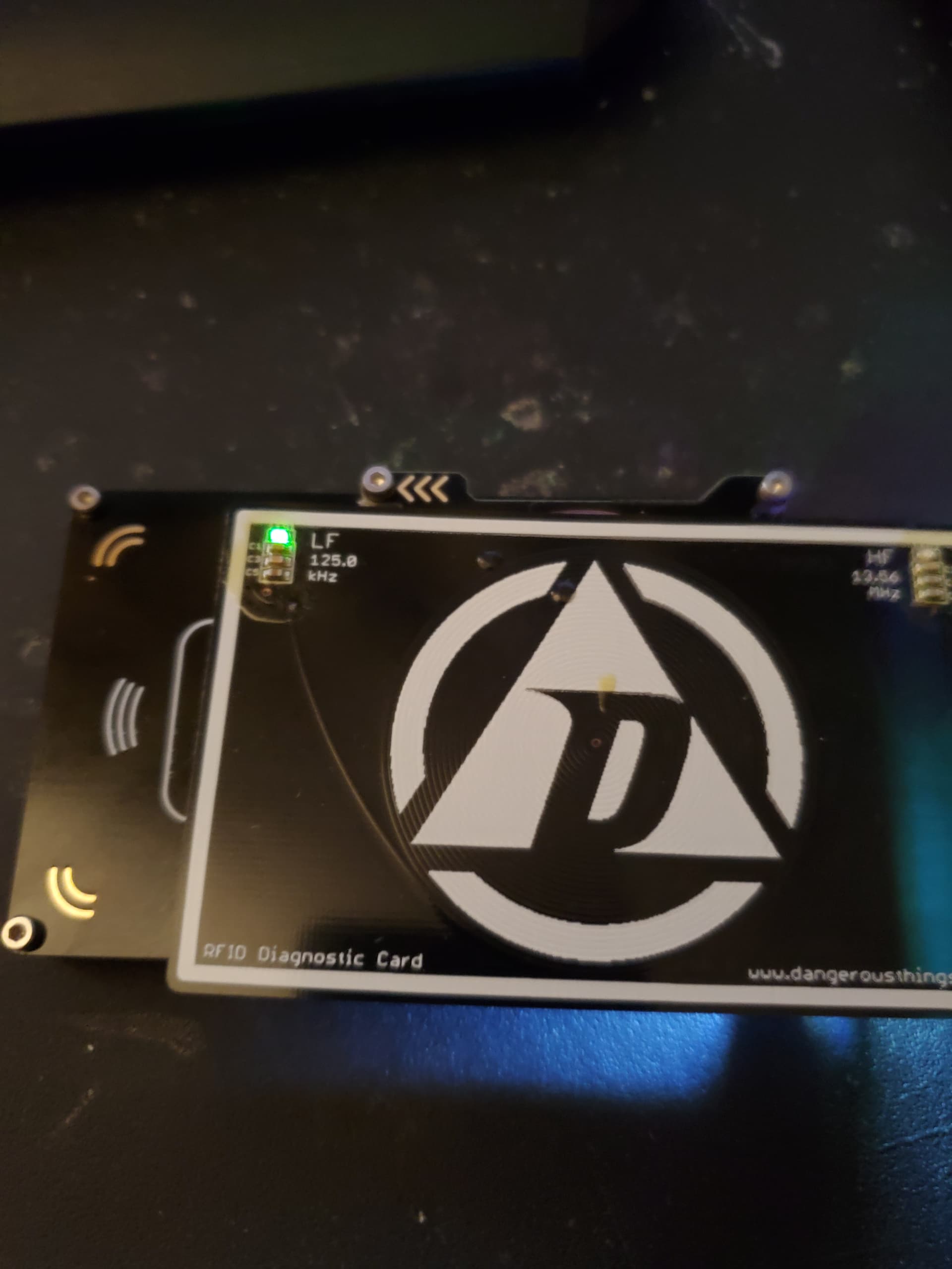

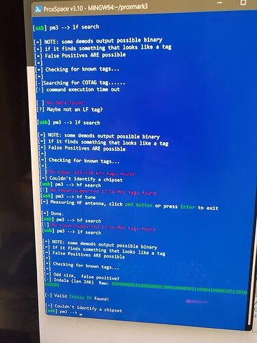

I am also having issues with my NExT install. I purchased an proxmark3 easy with my chip and verified that the proxmark is working as expected (can read HF and LF cards and tags, clone, tune etc) When I use tune I get from 21-20V but when I put the test card up I get 6V.
I run a lf search and the screenshot is a return of that. I also verified with the test card that the proxmark is searching both LF and HF when I do auto command. I tried to see the implant with my flashlight but no luck. Thank you for the help in advance, I love these tools and chips!
