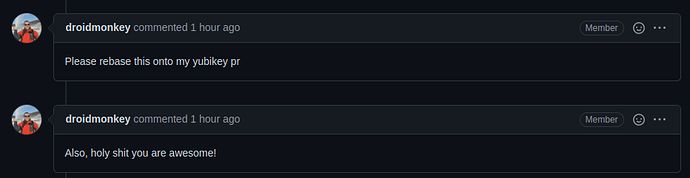

Good news, after some more discussion and development, the PR has been merged and is on track to release with KeePassXC version 2.7.0 (the next one). You can test is by compiling the offical “develop” branch by yourself.
Wolf 200 (2)
Seriously, fantastic work.
