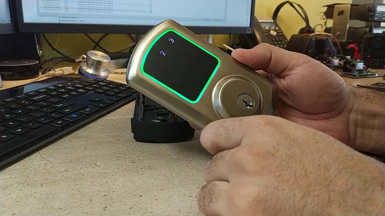

@turbo2ltr could you please do a TagInfo dump of the access card ( Or NFC Tools since you prefer it )
Now that I’m off work, I can give some more details.
It comes with a keychain card and a couple sticker tags.
It does not read ISO15693 tags.
Tested Reads with MiFare classic 1K, 2K, EV1 , NTAG216, JCOP
As you can see from the video, the reading is just “ok”. It definitely seems like the strongest read pulse is right when the screen turns on so if you can nail the placement right off the bat, it works best.
Controller is based off an “NXP” CV520. Think its a knockoff but it’s a ISO 14444 front end.
The touch side of the keypad is very sensitive and responsive which is not the feeling I got with the samsung. The RFID antenna is somehow embedded in the black keypad part. I didn’t want to take it too far apart.
Unfortunately they committed the cardinal sin… they put the reader guts on the outside of the door.
At least it’s not a lock/unlock signal going to the back side of the lock. It’s serial data I could not decode in the 30 minutes I worked on it.
I was able to pick the cylinder that it comes with without too much trouble. Though the keyway is pretty tight. What is nice is you can swap it out with anything you want as it has a standard core. I do wish the core had a better fit… It’s pretty loose in there.
The keyway is actually a standard Schlage. The keys are marked “do not duplicate” Which is kinda dumb. Even dumber, it appears they have the bitting stamped on them.
Some pics…
Scan of the tag it comes with.

Great write up @turbo2ltr
That will be amazing help to @Steven1727
He has a few implant options to choose from

So a lot like a CB radio antenna… :thinking:… would be really cool to make a remote antenna that would be a plug and play… :thinking:
Could you not use a LCR meter to get the inductance of the existing antenna and then simply wind one of the same size? I know that for the HF LED Power Bracelet I built 1 oscillator circuit and for the most part did not change it at all I just trialed multiple different coils with the same inductance and they all woked.
