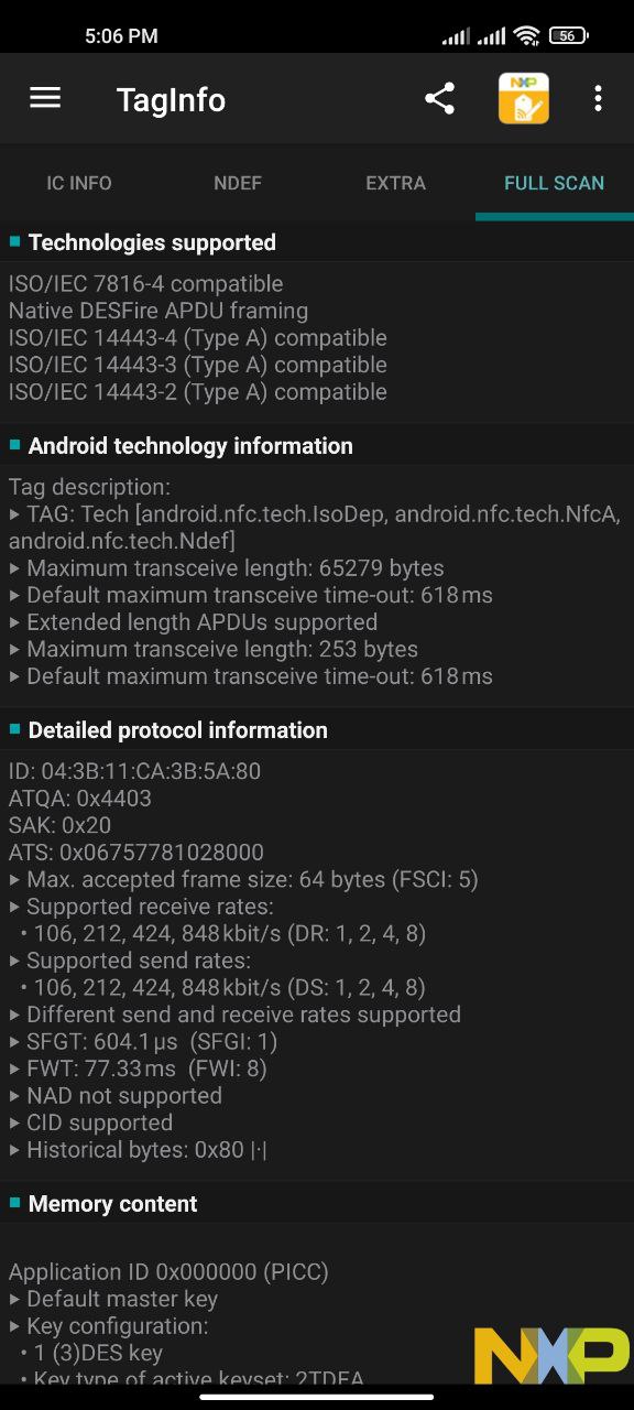

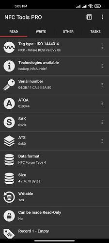

I’ve already implanted chip into my hand and other Tools from my phone are see the chip.

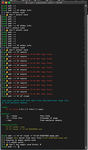

Promark3:
Here I tried many different hand positions under and above a device.
Other tools:

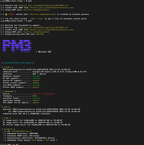

Ok… so it should be easily read by the proxmark3, and now we dive into firmware and client version and other potential issues that might cause it to fail a read. Can you send a screenshot of the client startup screen where it shows the firmware versions and client version?
Yes sure)
The firmware is built for RDV4 you need to rebuild / install the firmware for PM3GENERIC
