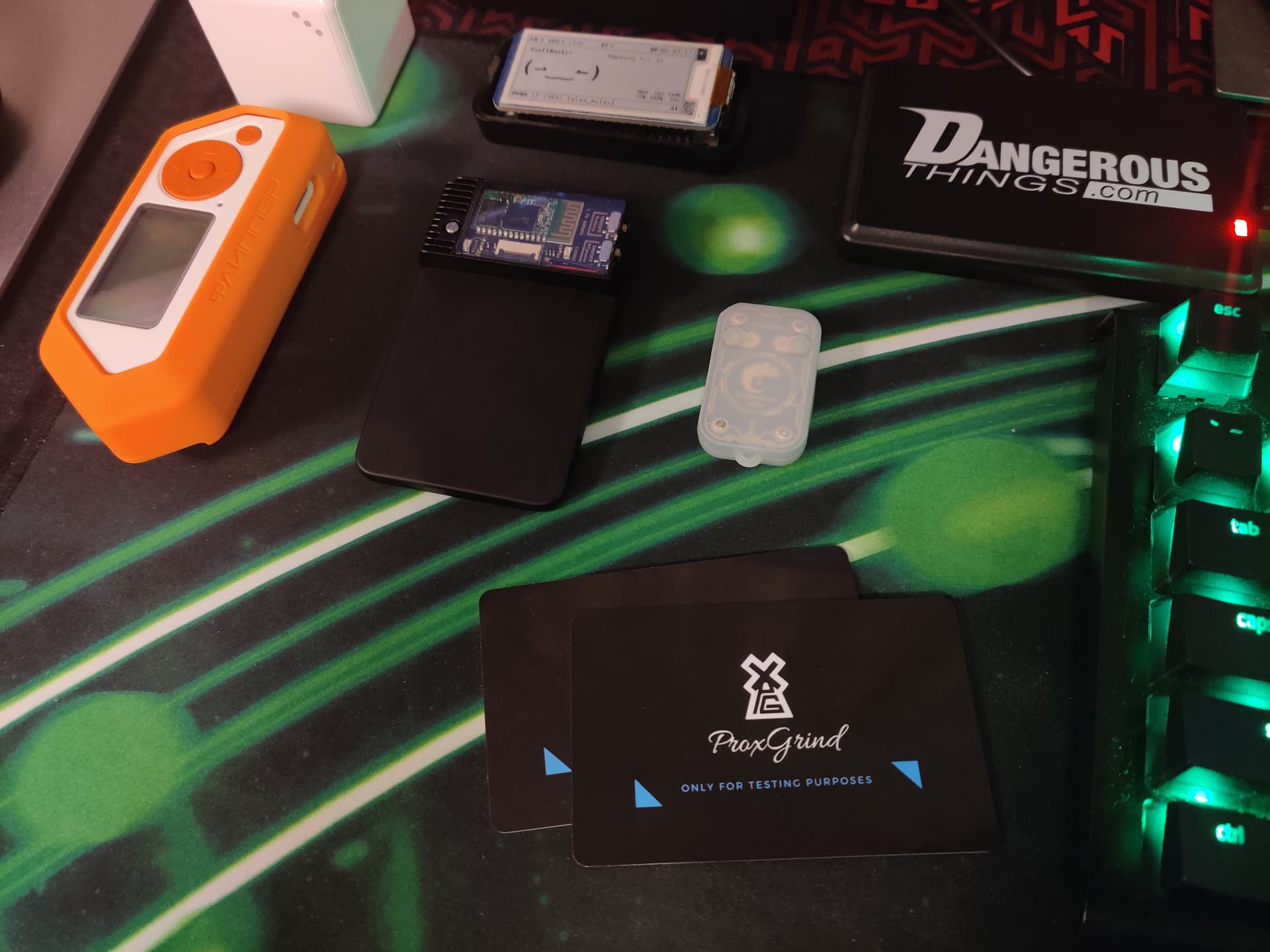

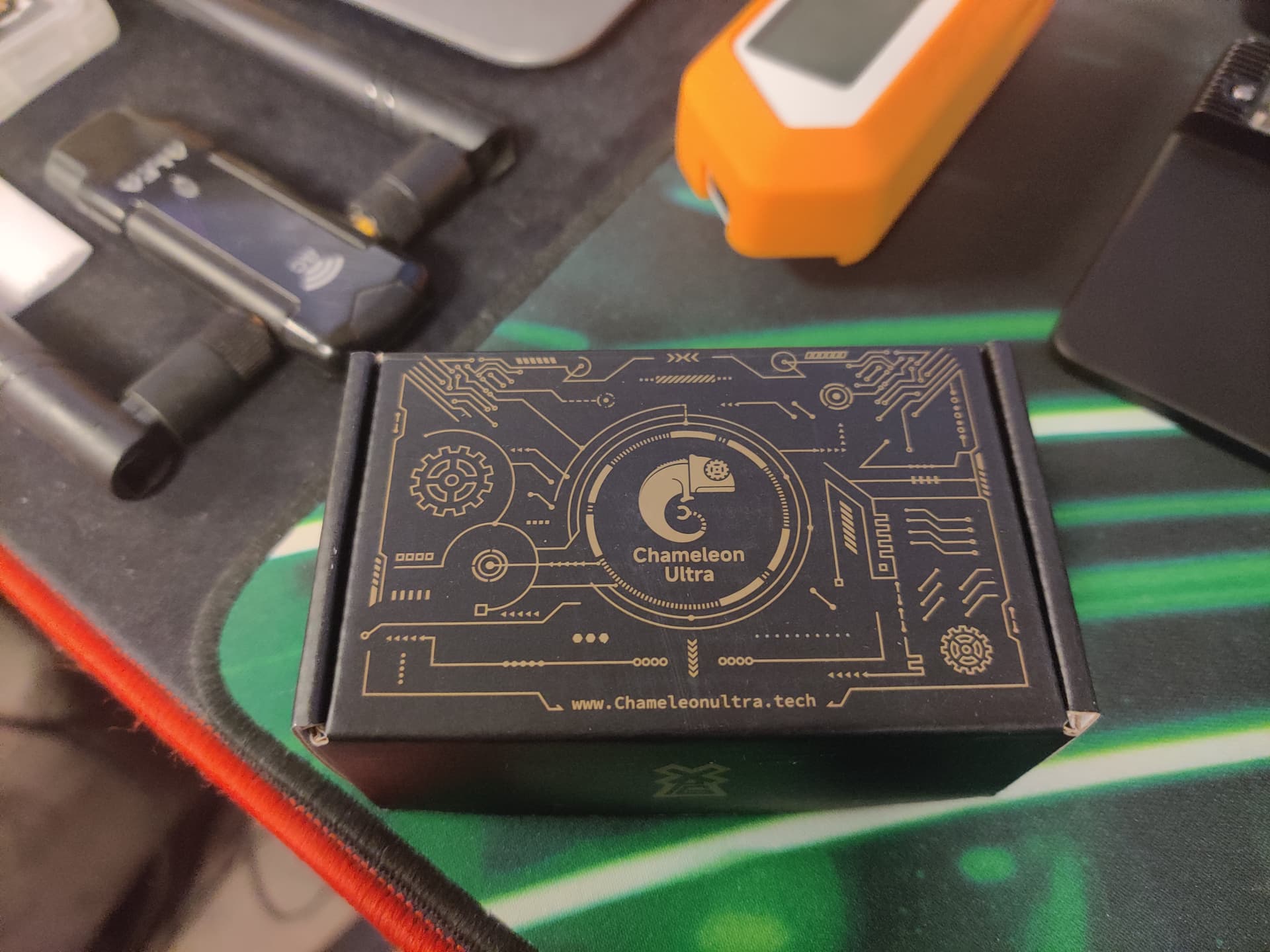

After some serious consideration do I need a chameleon ultra, I’ve decided to purchase one.
Ordered it last week, and after some drama with customs, as usual, it arrived at my door today.
What the Chameleon ultra is ? LF/HF emulator, in a tiny form factor.

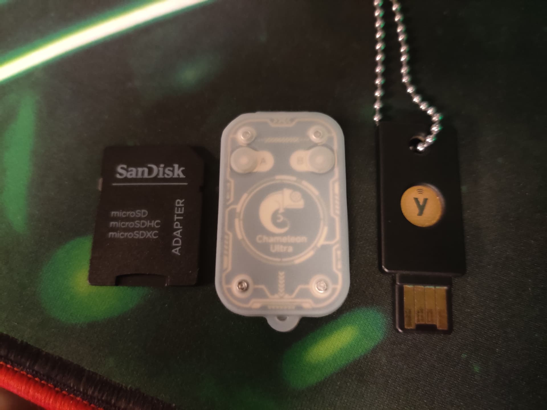

The product comes in a small black box. Inside you will find the device itself, a silicon case(which is great and prevent the clear coating from scratching, usb-a to usb-c cable, a small screw driver with two spare screws in case you need to take the thing apart.
First impressions - it’s small and it looks beautiful.
Device has 8 slots which can be configured to run lf, hf or both per slot. On paper battery should give you 6 months of juice.

I did not took it apart because I think if I try to take it out of the silicone case it may damage the case.

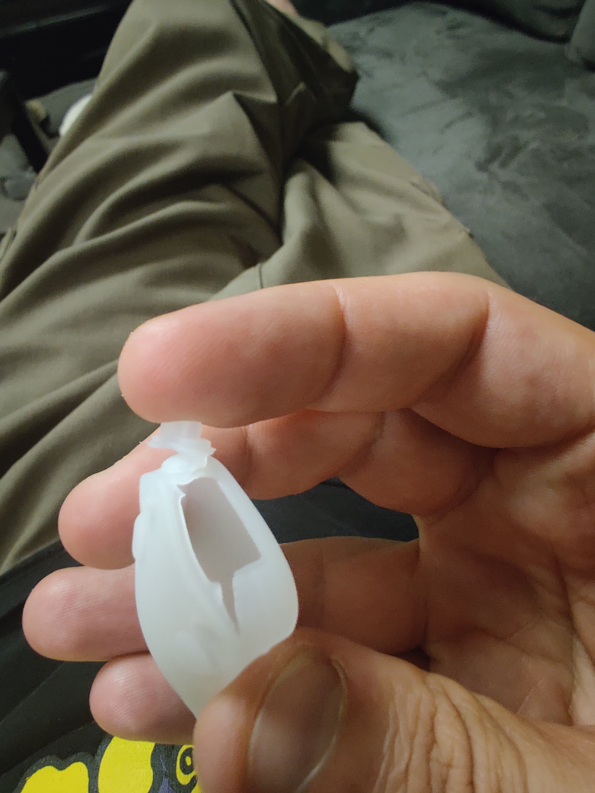

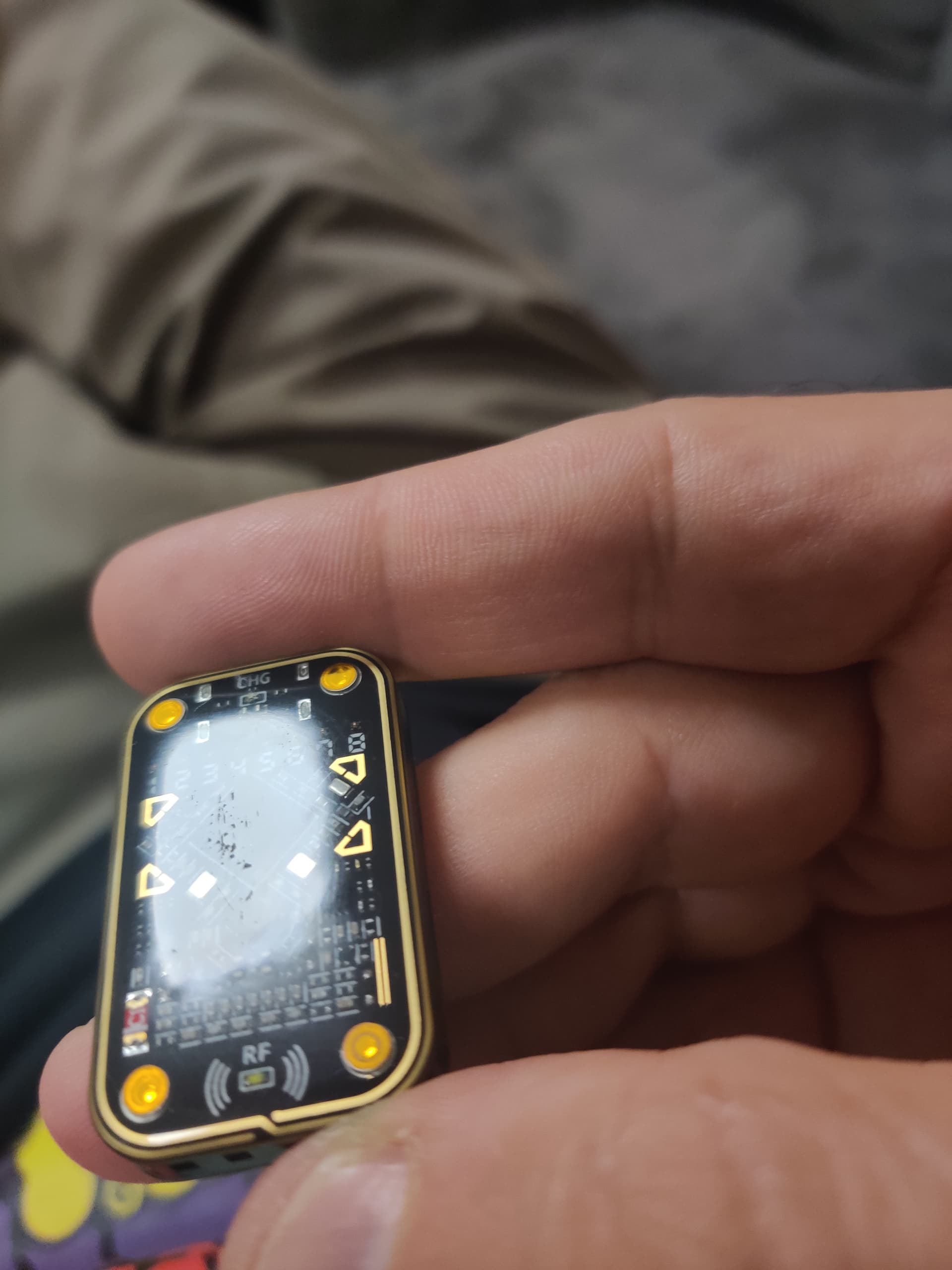

Second day of usage. Decided to take off the silicon case to check the device internals. Well silicone case got busted. The antenna PCB edges are pretty sharp and they will cut the silicon. Next the resin on the back is soft as butter. As you can see it got already scratched. How it happened, I have no freaking idea. Device was in my pocket for two hours and it was sitting on my desk the rest of the time. What a shame.
Same resin as it’s precessor. But mine came with a little leather case that protects it pretty well
This resin design sucks so bad!
Another thing that really sucks is, there are no replacement silicone sleeves for the device which is insane. They would cost cents to manufacture and yet they are not available.
Btw, I got some wet sand paper grid 2500 today and sanded the resin. At least there are no scratches that annoys me like hell. I would try to get more fine sandpaper and sand a lil bit more.

Next, I never worked with epoxy resins before. After educating myself on the topic, it seems the way to go is to sand the scratches then polish till you reach mirror finish. Found a store that sells resins and consumables, then ordered wet sandpaper grid 3000 and 4000, also two polishing pastes for finishing the process.
Since I got already grid 2500 I’ve started sanding with it, then I went up to 3000 and then 4000.
Finished with the polishing paste on some special sponge they provided delivered amazing results.
Also I was able to sand a remains of a bursted bubble that was on the surface of the resin.
Hopefully someone finds this useful. Here is the finished result.
