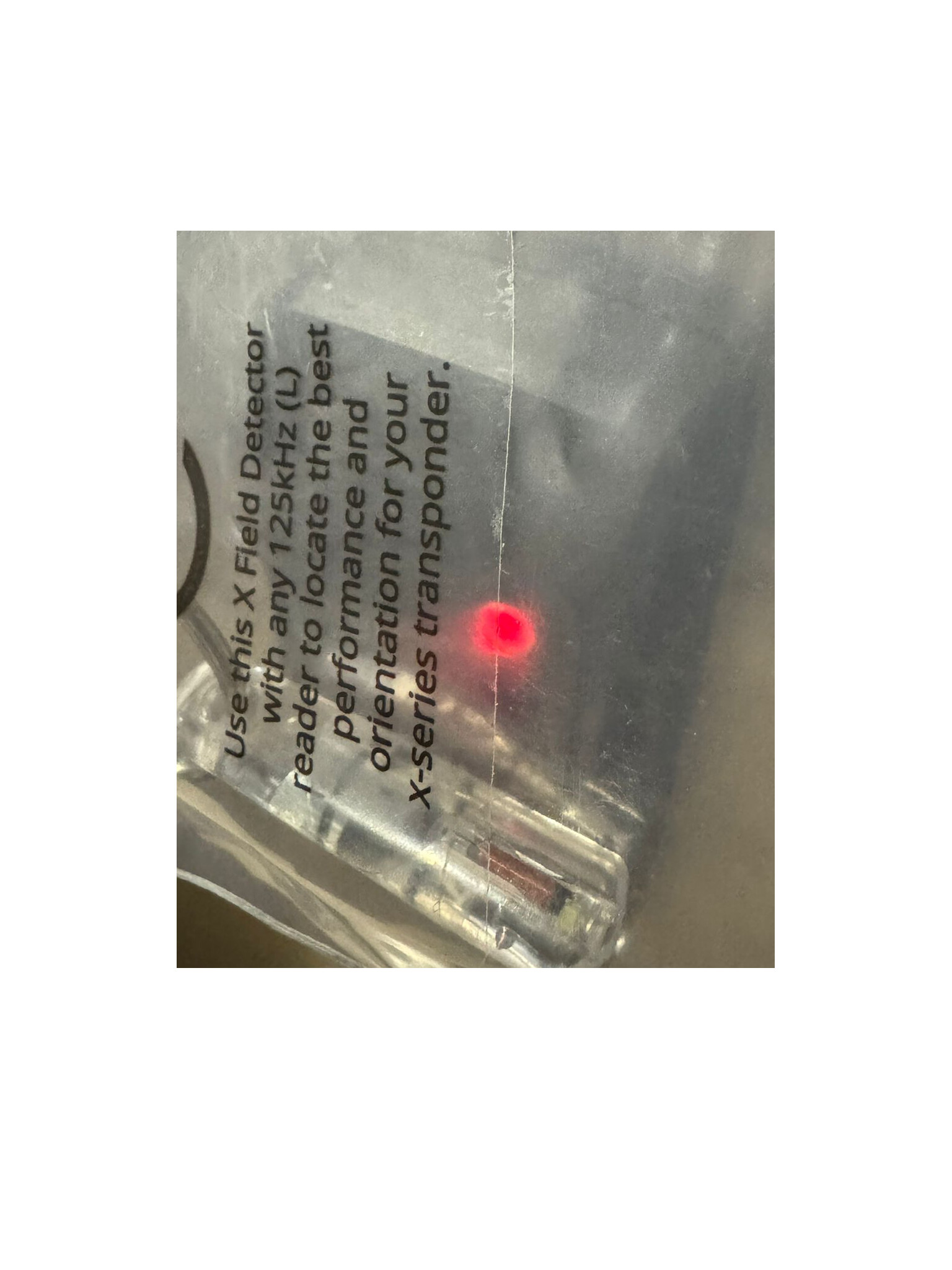

I tried it with the implant in the keychain as in the photo, it does not react.
I tried it with the test diagnostic card , the device is lf 125khz. Honeywell Proximity Card Reader

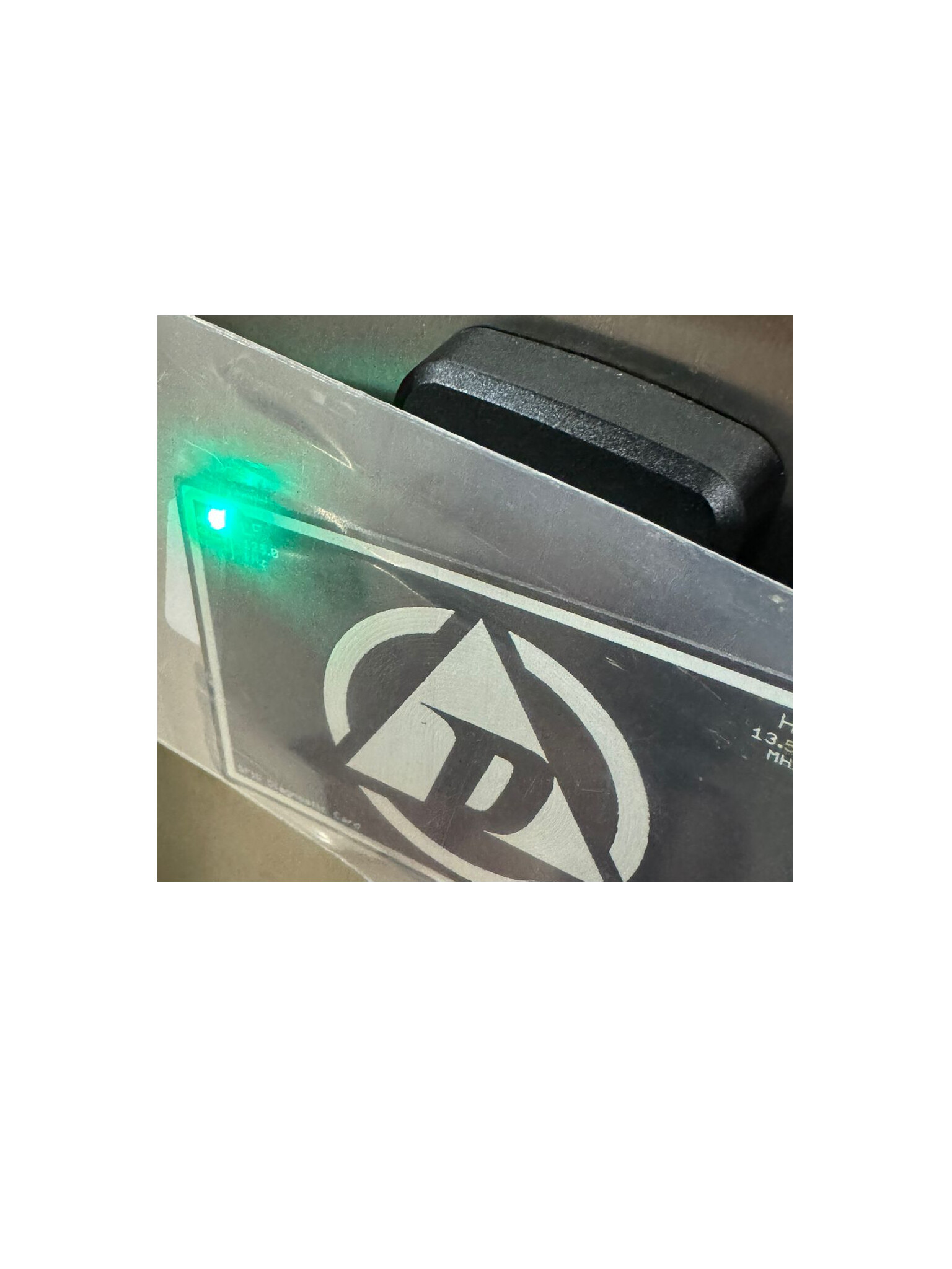

Just another thought for you, when you presented the xFD, they are the best analog for an xSeries and to locate an antenna
BUT
On occasion, the xFD wont light up, but an implant will read.
There is a possibility that you might still get a read but dont getvyour hopes up.
This is what I have done in the past and suggested to others and it has worked.
Swiping acrosst the face was what worked for me.
Like this
Swipe across the face
SLOWLY
make sure you are keeping your implant perpendicular to the antenna.
It may not be the right aproach for your specific reader, but I think it’s worth a try.
(the reader above, you can see the placement of the antenna would normally be against the wall, and thats quite likely the same for yours and why you are struggling)
excuse the crap photoshop but along the top and sides of the reader you would want to try placing the field detector perpendicular… like this;
