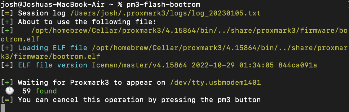

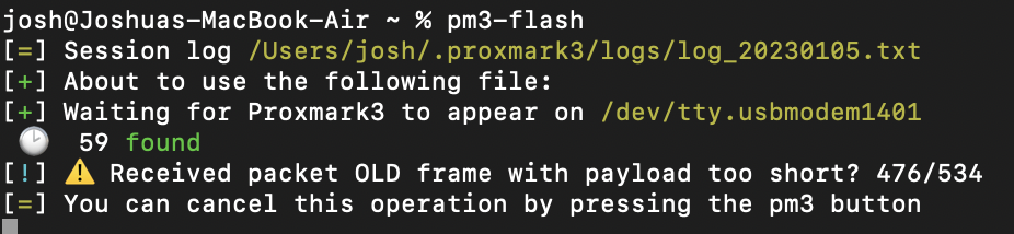

I have faced some problems when connecting my Proxmark easy to my MacBook
I followed this tutorial: https://poetsec.medium.com/getting-started-with-the-proxmark3-easy-macos-4dee228067e0
For the flashes, it doesn’t seem to work and it just says:
[=] You can cancel this operation by pressing the
pm3 button
When I pressed it, it doesn’t terminate and I think it got stuck.
There seems to be a problem with the connection

Thx, it fixed the problem with flashing, but the pm3 command still doesn’t work.
awesome, snd a step in the right direction
can you share a screenshot of the error and a few of the preceeding commands?
