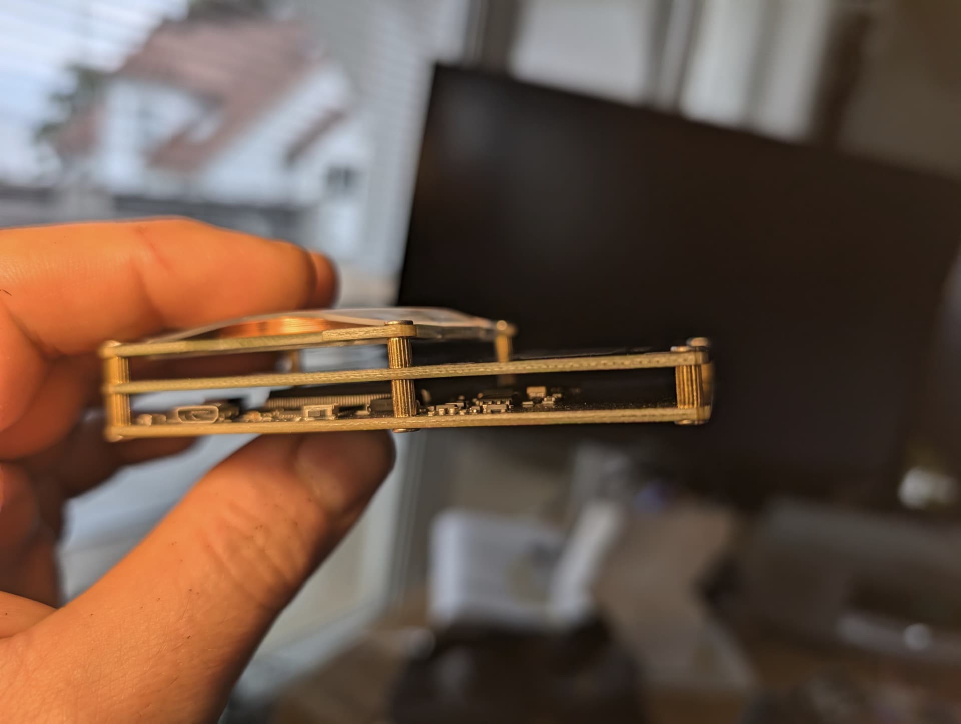

Small addition: It also seems that my proxmark looks slightly different from the ones i have seen videos/pictures here. Mine has the HF antenna on the middle board, while the lower mainboard has some components that are directly under it.

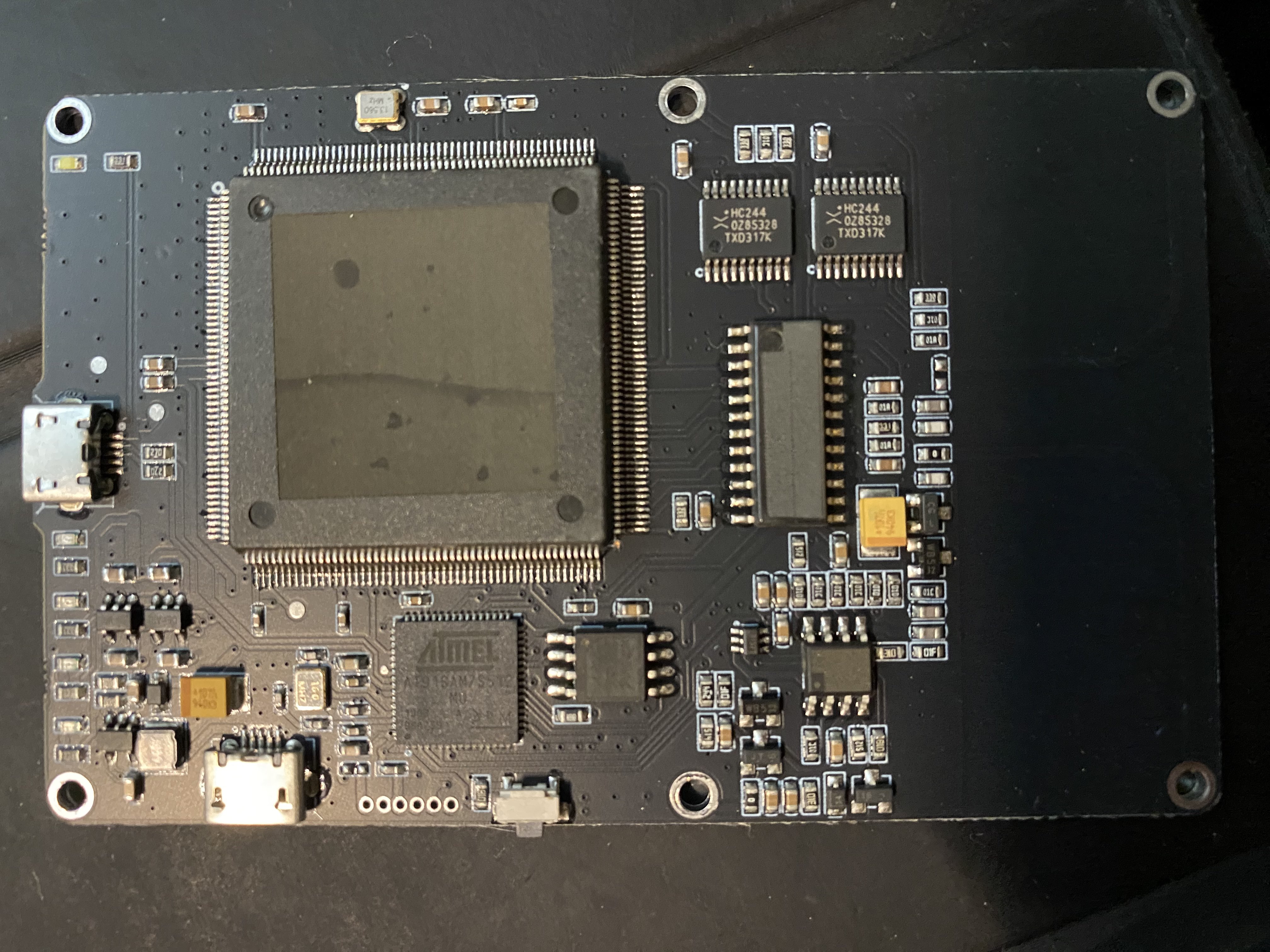

uh no not really, it’s a recent revision of the hardware with a fat FPGA on the base board and has known to have a lot of issues.

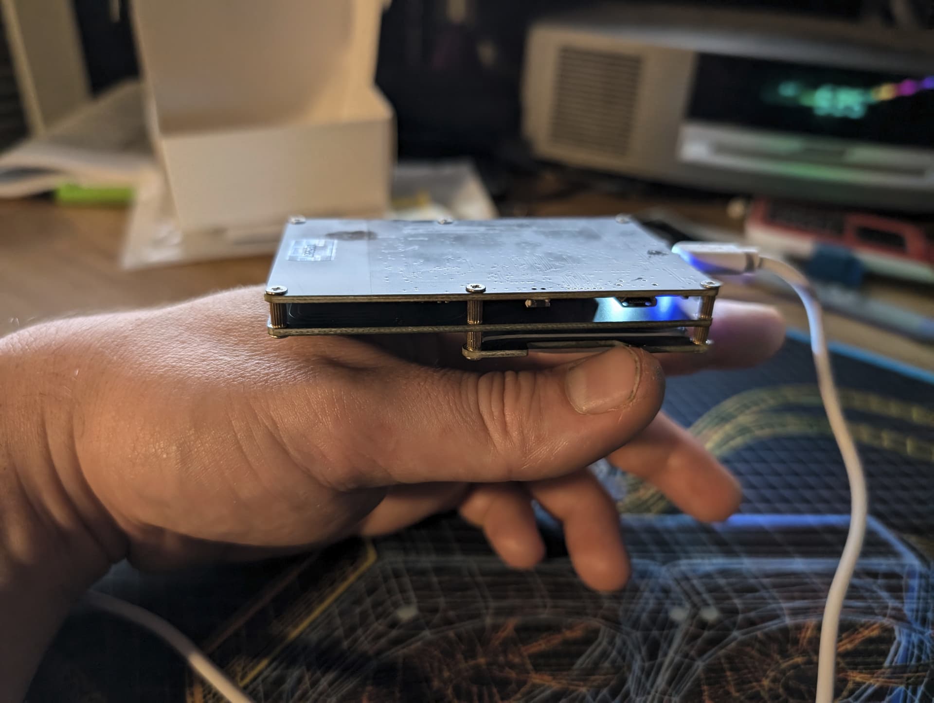

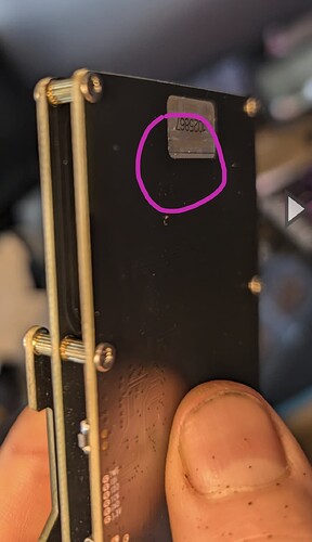

Let’s get down to basics… post photos of how you are presenting your xNT to the proxmark3
This made me wish i had a 3. hand but in roughly this position i just got exactly one read while trying to take this photo. The Implant is at a right angle to the “upper” part of the antenna.
I tried to find the spot again for a minute or so but could not do it.
Ok, so the funny thing about the HF antenna is… it’s on the bottom PCB. Even though that middle PCB has a silkscreen design on it that indicates you put the cards there, for implants you want them up against the actual antenna trace, which is on the top side of the bottom PCB.
On my proxmark3 easy I’ve removed my middle PCB which is more or less a spacer to keep the LF and HF bits from interfering with each other. You can see the antenna trace clearly.
Basically, you’ll want to flip the proxmark3 over and put the bottom PCB on your hand instead. Also, be sure you take advantage of the delay command;
I thought so too but on this proxmarks this seems not to be the case.
It is difficult to see but the traces are on the middle board and there is no space for the antenna on the lower board.
The delay command did not help me, i have not been able to get a “single shot” read from the chip with it, i tried for another hour last night. I only got the one reading from continuous search.
(bottom board) these new design revisions hitting the market are monsters. the HF antenna actually does live on the middle board and uses standoffs to run data & power much like the LF antenna.
the bottom board has been fully reworked and instead of resistors and flash where they tend to be, there’s this “the thing” esque FPGA that eats all available sunlight

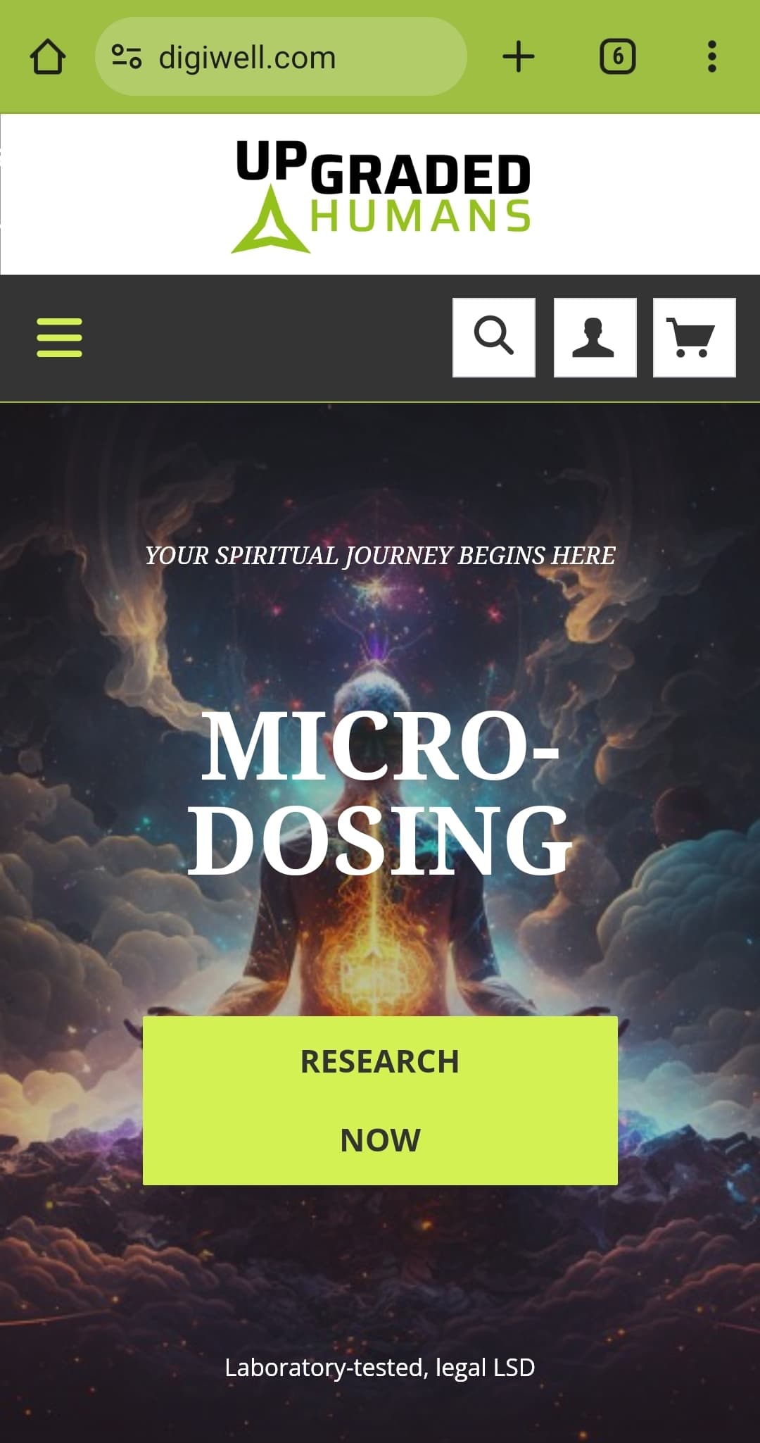

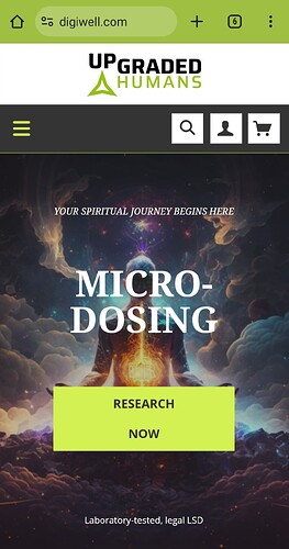

I’m pretty sure that the DT implants are the only products that company sells that are not sketchy
WTF!?
:emoji_mindblown:
I’d recommend ordering directly from DT or from Ksec if you want to keep your sanity… That website reminded me of a certain thread.
Oh i know the site is a bit urm “special”. But they are a source from inside germany so that made ordering quick and shipping cost extremely low. They did use all the dangerousthings guides and videos so they look(ed) at least somewhat like a official partner.

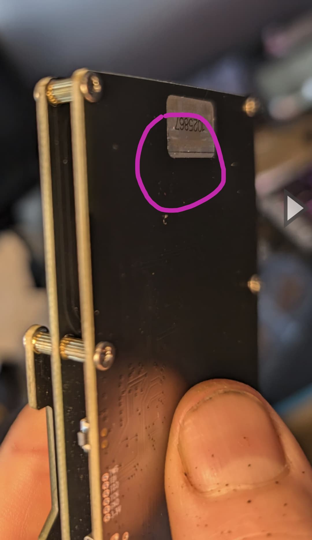

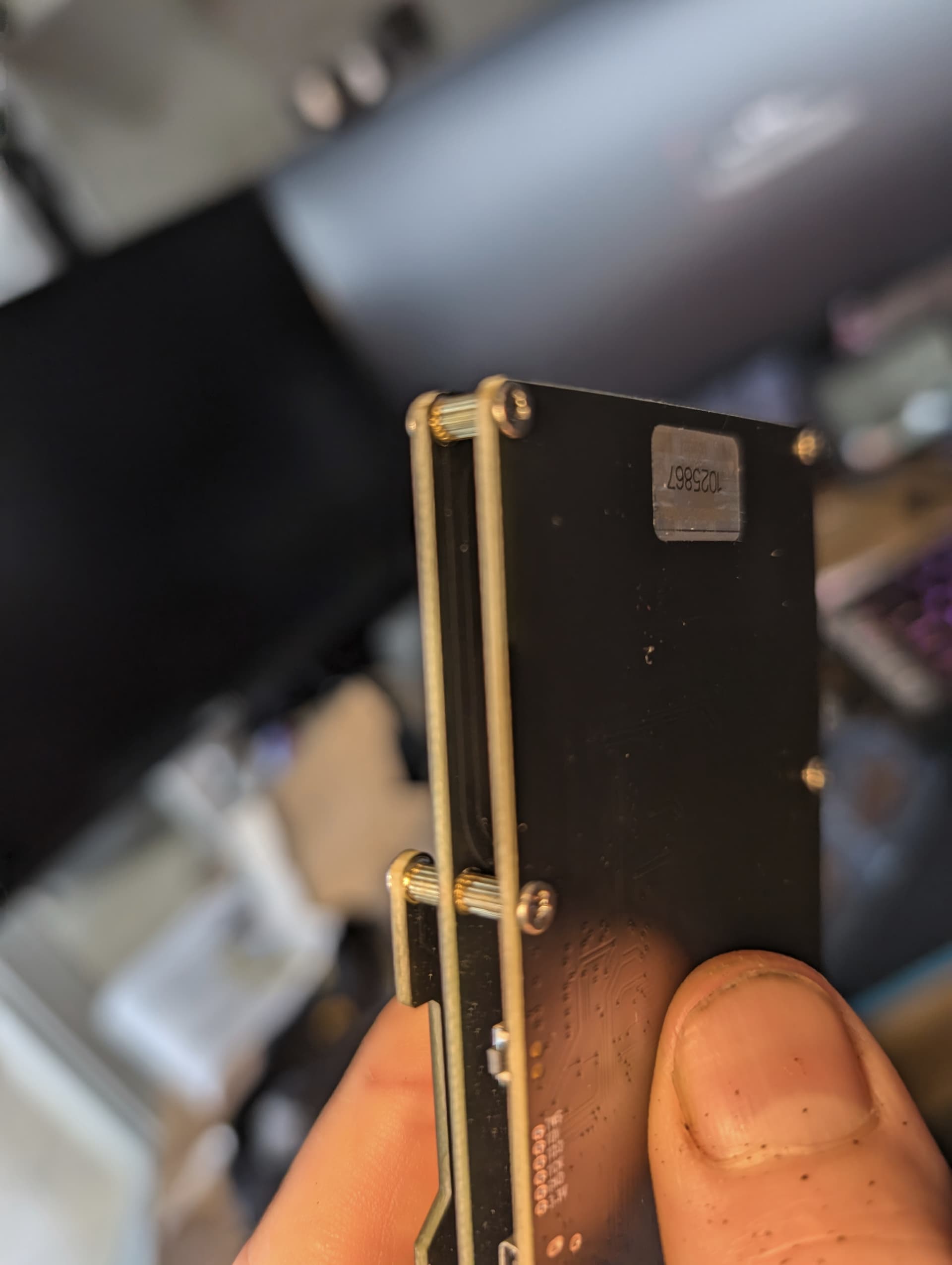

You might consider putting an dngr.us/rsp sticker on the bottom PCB;
Is there a source for those from inside the EU?
Not at the moment but if you order from us and that’s all you order we will send them out in a plain letter envelope for a few bucks shipping. No tracking but cheap.
Huh, digiwell just offered to send me one of the stickers to test out, looks like they sell them as well i just did not see it. I will report on the results when i get them.
