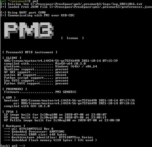

Now let’s confirm the firmware matches… what’s your proxmark3 output when you first launch the client?

the cards are scanning but none of them show the ID. I tried scanning the tags that came with the xem access controll board and those were the only ones that gave an ID. hw tune shows both antennas are OK but operating at about 26V for Lf and 15v for Hf. I’m running hw tune on a wooden table away from metal and any tags. haven’t checked the screws yet.
Ok can you post exactly what’s happening when you scan but don’t get an ID? Screenshots will help bring some clarity I hope.
