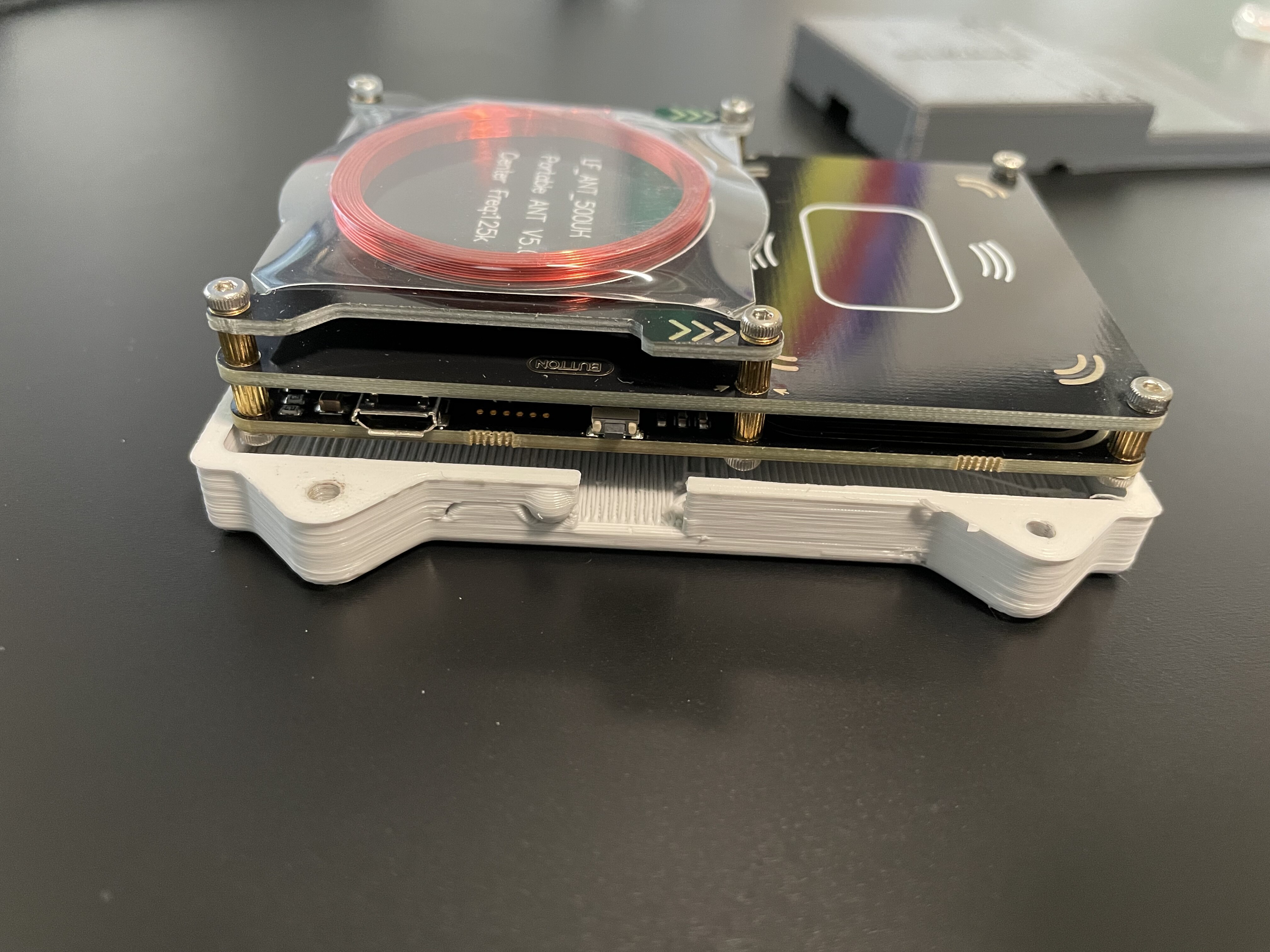

Anyone have an STL file for a case that fits the PM3 Easy? I printed two different ones on Thingiverse, but it seems the design and layout have changed on the PM3 I got now recently, so they don’t fit at all.

Yeah, I printed that one as well. Didn’t fit my version, so it would need modifications
Can you give some specifics about how it doesn’t fit? It looks pretty close so maybe a few tweaks will get you were you need to be

As you can see, the second USB port is far more to the left. The screws are not matching up with the case, and the whole unit is slightly too large to fit
Yeah, the Easy version is purely a product of the Chinese hardware maelstrom. No one company is heading the designer development of the Easy, it’s a loose conglomerate of various factories taking a shot at productizing open source hardware. As such, even the sources we get ours from change things up. What’s most noticable is the side USB port and button placement.
Try to scale it around 105%
Wouldn’t help, as many components are placed differently
I made another case, included the source files. This fit the version I got April 2022 from here. Sorry to necro but this thread is where I landed before I made the new model
saw this in the rrg server and just finished printing one of these its great nice snug fit and levels the device nicely which is good for what I’m using one of the pm3easys for, brutalising lf tags

As long as we’re sharing, here’s another that I made about a month ago, but I just posted it since there seems to be interest – the main differences versus @Xmutantson’s, is that it has holes so that all of the indicator lights are visible, and the antenna areas are made as thin as practical.:
I’ll try yours, I was using translucent ABS so you can still see the lights without having to make holes (though it does tend to turn anything white blue). Yours looks really nice, by the way.
I don’t have an enclosure for ABS. Your design looks great and if yours had been available, I would probably have just modded it by adding holes and been happy! Or I’d have used it as an excuse to buy a roll of translucent PLA.
@ Xmutantson, here’s a remix of your case, adding holes for the indicator lights. I made one in black, but then I made one in translucent/clear PLA that I really like.
hey @Concorde i really like your case and it seems to be the only one to fit the Proxmark 3X. i was curious if you would be willing to further modify it for me.
The 3x has a battery and a switch to activate the battery, as well as Read and Write buttons. Also the separator you have for the button on the left needs removed to access the USB-C connection.
I mocked up a quick diagram using your case, shaded areas would be spots for the proposed cutouts.
@Hamspiced — did you actually 3D print a case yourself and try it? I’d be glad to mod the model, but you can easily do it yourself… import the STL into TinkerCad (free online at tinkercad.com), and then just add the “blocks as holes” to cut out the areas you have in mind. MIKE
Yessir, i actually printed 3. one on Thingaverse which didnt fit at all, then i scaled it to 105% and it still didnt fit, then i pritned yours. The diagram above is with your bottom case attached. I was actually in the midst of modeling it on fusion360 when i saw you posted yours. i havent played with tinkercad yet. i can give it a try i just dont want to end up wasting more filament again.
I underestimated how easy Tinkercad is. I went ahead and made the edits and uploaded to Thingiverse. For anyone searching this case should fit a Proxmark 3x with access to all buttons, switches, and cutouts for the lights, labels for button function, and antennae.
