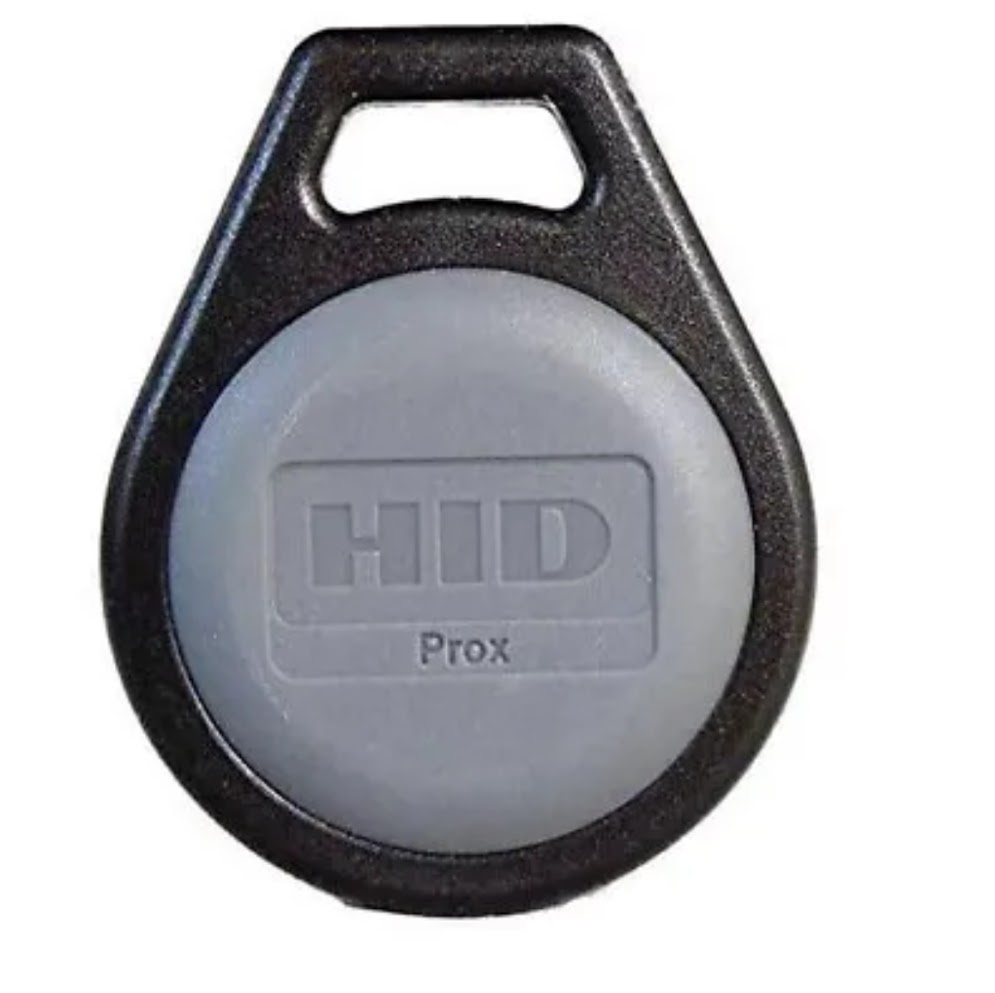

I have a HID Prox Key fob which I tried to clone but unfortunately couldnt’ figure out how.

I tried a few different ways to clone it to the same type of key fob with no luck:
command tried so far:
lf hid clone --em -w H10301 --fc 2xx --cn 111xx (also w/o --em)
lf hid clone --em -r 2007e056xx (also w/o --em)
lf hid clone -w ind26 --fc 38xx --cn 29xx --em
lf indala clone --fc 38xx --cn 29xx --em
lf indala clone --fc 38xx --cn 29xx --4035
all these commands execute ok without error but it didn’t write to the new card.
Any help will be much appreciated.

what new card? what did you buy specifically? is it another hidprox fob exactly the same?

Thanks Equipter, yes the new card looks exactly the same and the “lf seach” command produced same sort of information.
I added “–em” sometimes not as the last parameter but hope that doesn’t make a difference.
oh then you’ll need to wipe it with the password before you can write to it.
Hid prox creds are em4305 with the password “PROX” in ascii converted hex (hilarious right)
lf em 4x05 wipe -p 50524F58
lf hid clone -w h10301 --fc [fc] --cn [cn] --em
you don’t need to put the password back on. it’s not used by the system it’s just there for HID to be able to configure the chips to be different hidprox bitlengths and formats
hope this helps! let me know if it doesn’t (it should) and we will investigate further

Hi Equipter,
Legend!, it works like a charm after running the wipe command. I actually tried the wipe command without the password but it didn’t work as expected.
