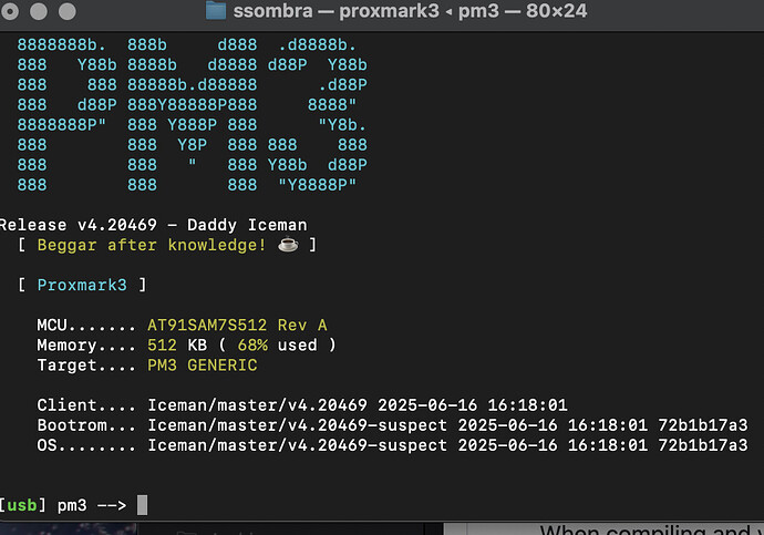

I just got a Proxmark3 easy (Ali) and I am getting some issues. I followed an installation guide and I managed to flash the device and install the client using a Mac. However, when I run pm3 from the terminal, the client starts, it reads some info from the device:
MCU… AT91SAM7S512 Rev A
Memory… 512 KB ( 68% used )
Target… PM3 GENERIC
Client.... Iceman/master/v4.20469 2025-06-16 16:18:01
Bootrom... Iceman/master/v4.20469-suspect 2025-06-16 16:18:01 72b1b17a3
OS........ Iceman/master/v4.20469-suspect 2025-06-16 16:18:01 72b1b17a3
and then the following prompt appears:
[usb] pm3
However, I can’t write anything there, no matter what I press on the keyboard.
Thanks in advance for any help
Which one?
Is there a flashing cursor or nothing?
Hi,
This is the guide I followed:
No flashing cursor. There is a cursor but it is not flashing at all (it is like a gray rectangle)
That seems so odd. What if you run the client and then type in a command like lf search and press enter… does it respond with anything? I’m trying to figure out if this is a terminal echo issue or some other input problem.
It just doesn´t respond. The only thing I can do is CONTROL + C to go back to the terminal.

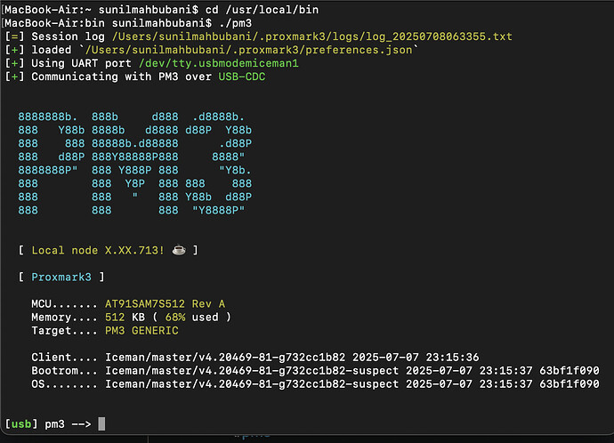

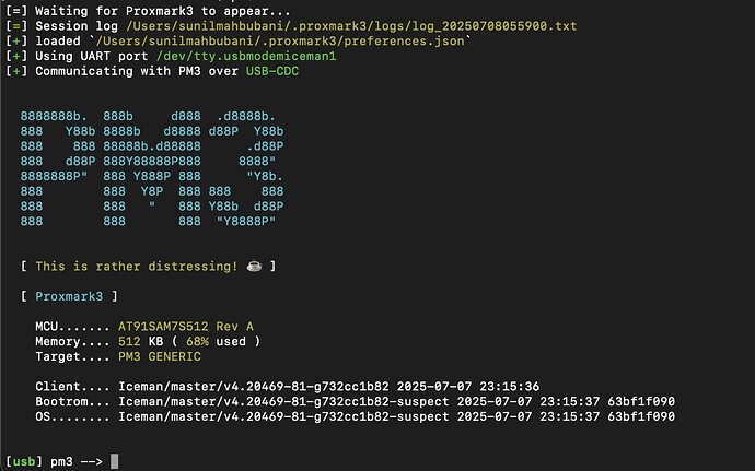

Whoa… i’ve got this exact same problem!
In terminal, I run “pm3” and get the following after doing the installs
I type commands but cant get anything to show up. I thought maybe this is just an error with letters being displayed, but even after entering valid commands, nothing happens.
I’ve got to ^c to exit
