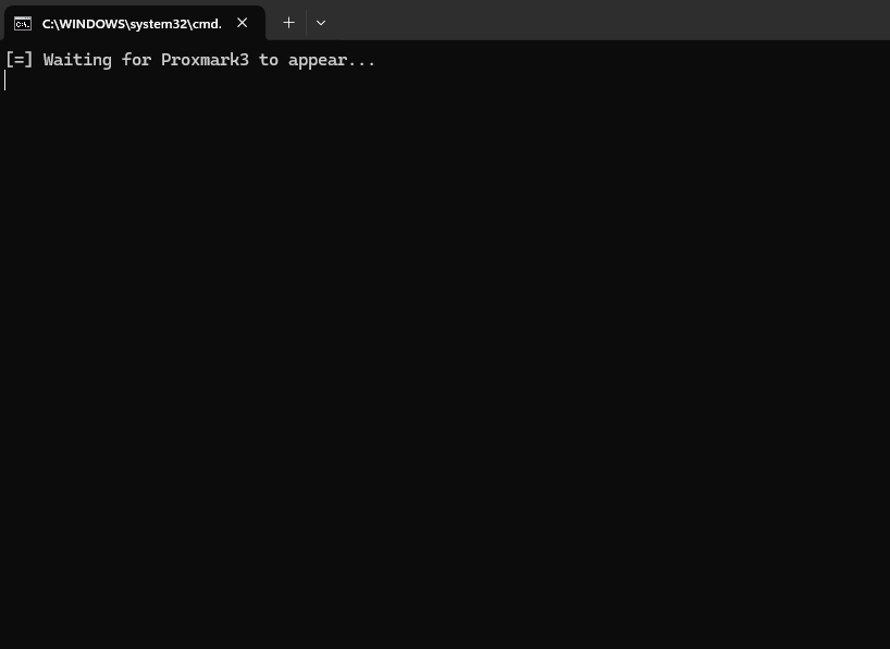

Proxmark3 help!
anyone able to help me

Hey so it’s usb 3.0 it’s showing up in my Device manager in COM3
What about the button thing? tried that?
Yeah tried that still saying the same

It didn’t come with firmware so I just downloaded from Proxmark builds and tried it on a usb 2 as well
Have you tried ./pm3-flash-bootrom and then ./pm3-flash-fullimage?
You might also try client/proxmark3 COM3 --flash --unlock-bootloader --image bootrom.elf --image fullimage.elf
spoke on disc, it’s a wmic issue we are gonna sort it when they’re next awake (port spec needed, auto find doesn’t have deps on windows 11 by default)
I’d love to hear more about the troubleshooting for this, if it’s easy enough to share
oh word i teamviewer’d into his computer (at his request) and we used proxspace and just did port specification (./pm3-flash-fullimage -p COM3 etc) because port specifying in the batch files of the pre compiles didn’t work.
