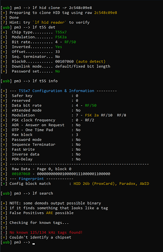

I am using a Proxmark3 Easy to try and clone to a t5577 chip. When I try to do “lf search” it just says that there no chip detected. But I can do all the other commands like “lf t55xx detect”, “lf t55xx info” and they all work properly. I am not sure what is going on
That’s because LF SEARCH can only find well defined or known emulations and a factory blank T5577 is not set up to emulate anything. Once you set it up as an EM or HID Prox or anything known, LF SEARCH will detect it just fine as that thing… so clone an em410x ID to your T5577 and LF SEARCH will find an EM410x ID.
Yeah I cloned a card with the lf hid clone -r 2” command and lf search still doesn’t work

Can you do a lf search of the card and share the screenshot
is that all you sent? just -r 2 or is that the start of the raw ID?
what kind of T5577 chip is it? is it an implant from us or a card or fob or something else?
basically when you issue a clone command you are shotgunning bytes into the ether… there is no check going on to ensure the clone was actually accepted and successful, so it might just be that you haven’t actually successfully programmed your T5577 chip. Any video of the process or just photos might help.

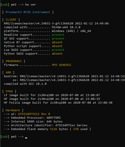

hmm that seems strange… could be a T5555 chip? also are your firmware and client versions matching properly?

can you screenshot the output of the lf search of the real HID card, it may be that you’re formatting your syntax incorrectly.
i just ran lf hid clone -r 2c548c09e8 and it returned a 35bit std with fc 676 and cn394484.
what I suspect is happening with yours is either syntax or coupling. like amal said its firing bytes out into the ether so if your tag isn’t collecting those properly you need to adjust your positioning
yeah i get that output, is that your original card or the t5577?
That’s doing the lf search with the original card. I posted the screenshot of the lf search with the t5577 as a reply to amal.
ok cool, can you do hw ver and post the output plz
