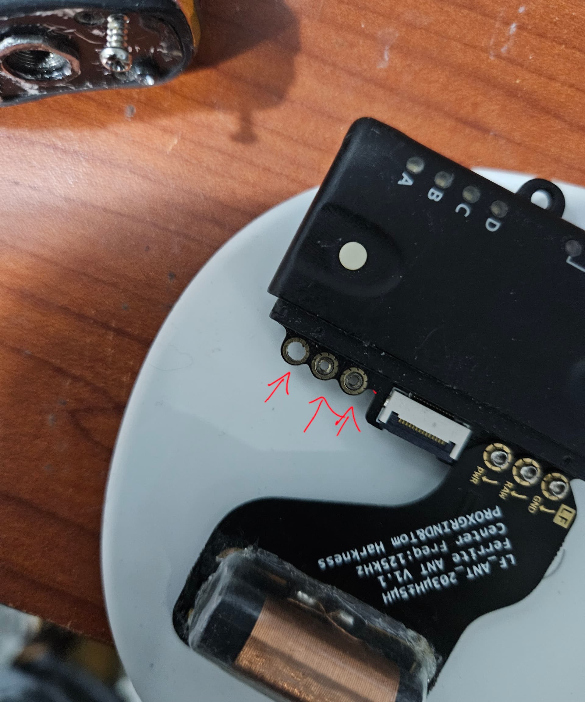

I’m looking for a replacement parts for my Proxmark3 RDV4 I happen to have lost one of the screws for the antenna The High Frequency want to be specific.
I lost it and I also lost the insert threading for the same screw I’m just wondering what are they called exactly so I can go about finding a screw to replace and the threading ring to fit the module.
I’m not sure exactly what these screws are called I know they are commonly use for electronic devices if anybody could help me out and point me in the right direction that would be much appreciated
Here is a pic
USE PCB in your search, but ive heard them called a few things
  • Flush mounted threaded through hole
  • Zero height threaded inserts
  • Broaching nut
I dont know if you’ll be able to buy just one
:man_shrugging:
That should get you started
good luch with your search
