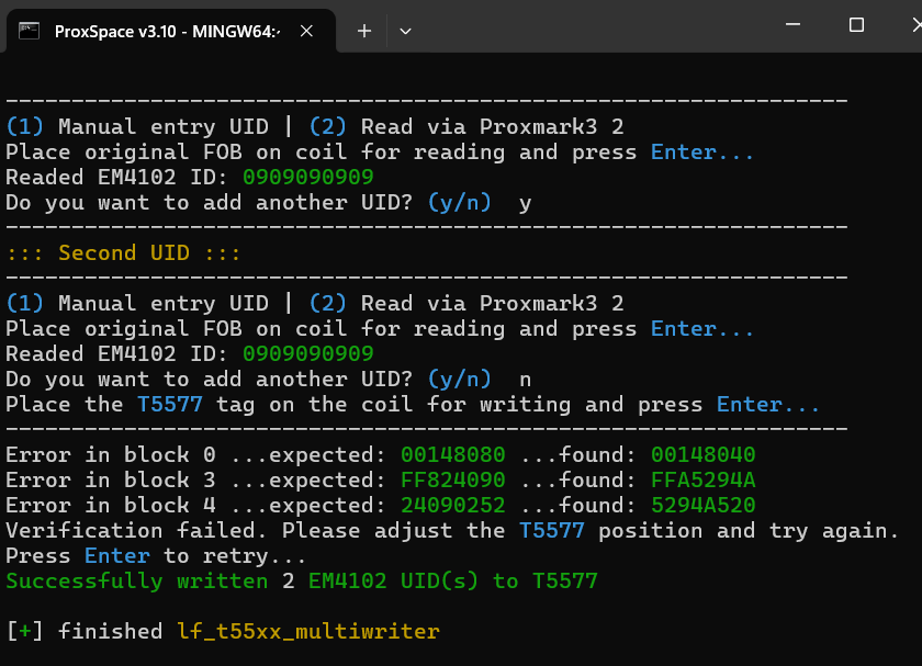

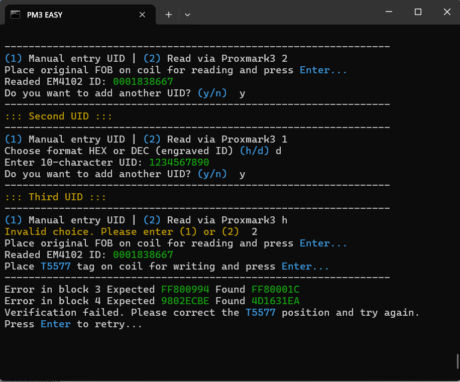

lf_t55xx_multiwriter.lua (7.1 KB)
This simple script stores 1, 2 or 3 different EM4102 on a single T5577.
There is an option to enter the number engraved on the fob in decimal form.
The script can therefore be useful if the original EM4102 doesn’t work but
has an engraved ID number. By entering such an ID as a single EM4102, we
can create a working copy of our damaged fob.
A tag T5577 created in this way works with the following USB readers:
  • ACM08Y
  • ACM26C
  • Sycreader R60D
  • Elatech Multitech TWN4
v1.0.1

lf_t55xx_multiwriter.lua (9.3 KB)
Added - verification blocks
If someone doesn’t want a timer - I made for tag swapping to test - just add “–” in the timer(3) lines
       write(blocks)
	   timer(3)
       verified = verify_written_data(blocks)
v1.06
Fix verification block 0
lf_t55xx_multiwriter.lua (9.4 KB)
Verification will be useful for anyone who has an RFID implant :wink:
