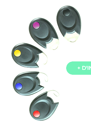

Is a pm3 the only way to read data off a 125khz fob? I’m wanting to clone a noralsy fob. When I read with my flipper the indication lights go green and it just keeps looping trying to read the ask and psk.

The flipper should work for most 125khz RFID cards. The noralsy looks like access control specifically which may use some other chips under the hood that the flipper doesn’t support. Do you have any other 125khz cards you can test with? The flipper does have a sweet spot that can be difficult to find if you haven’t read anything with it before.
edited to add: rfid is mostly used for access control, what I meant was this looks more like an all in one solution. I can’t read french but if their site has any docs on how the tech works you may be able to find out the specific chip and see if the T5577 (what most of us use to emulate) supports it.

Does the product sheet → Access Control section of this page have the card data? I got google to translate the page but the PDFs are on a whole 'nother level:
https://www.noralsy.com/documentation/#FICHE-PRODUIT
But from a cursory glance at the names, it looks like the cards may be high frequency cards

Thanks for the link. I didnt know noralsy were a european company. No wonder i couldnt find much info. Mostly marketing docs rather than datasheets, but i will start from there for my search. Unfortunately it does look like one of their anti clone fobs, but i dont know if it can be hacked or not.
That close up makes me think its not that then. Same design but blue. If it was hf then i would have found out by now.
