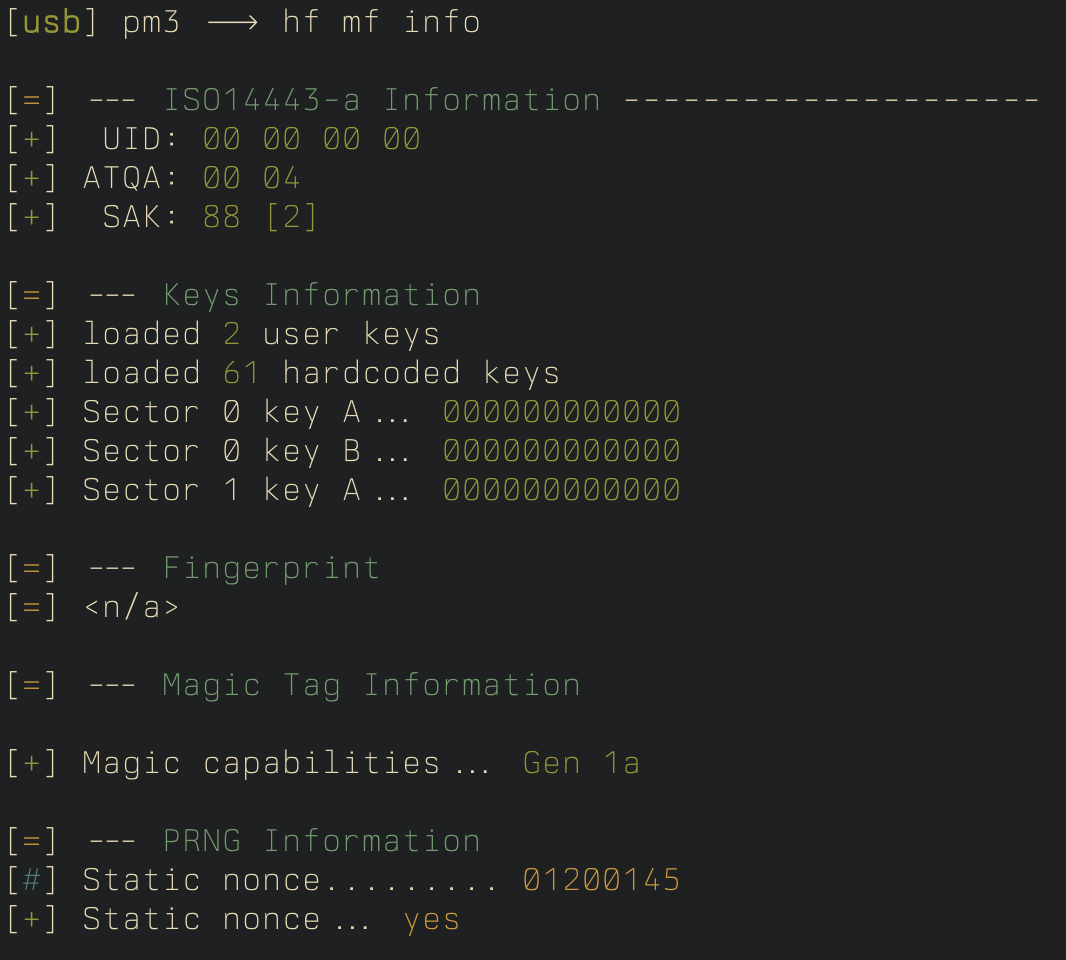

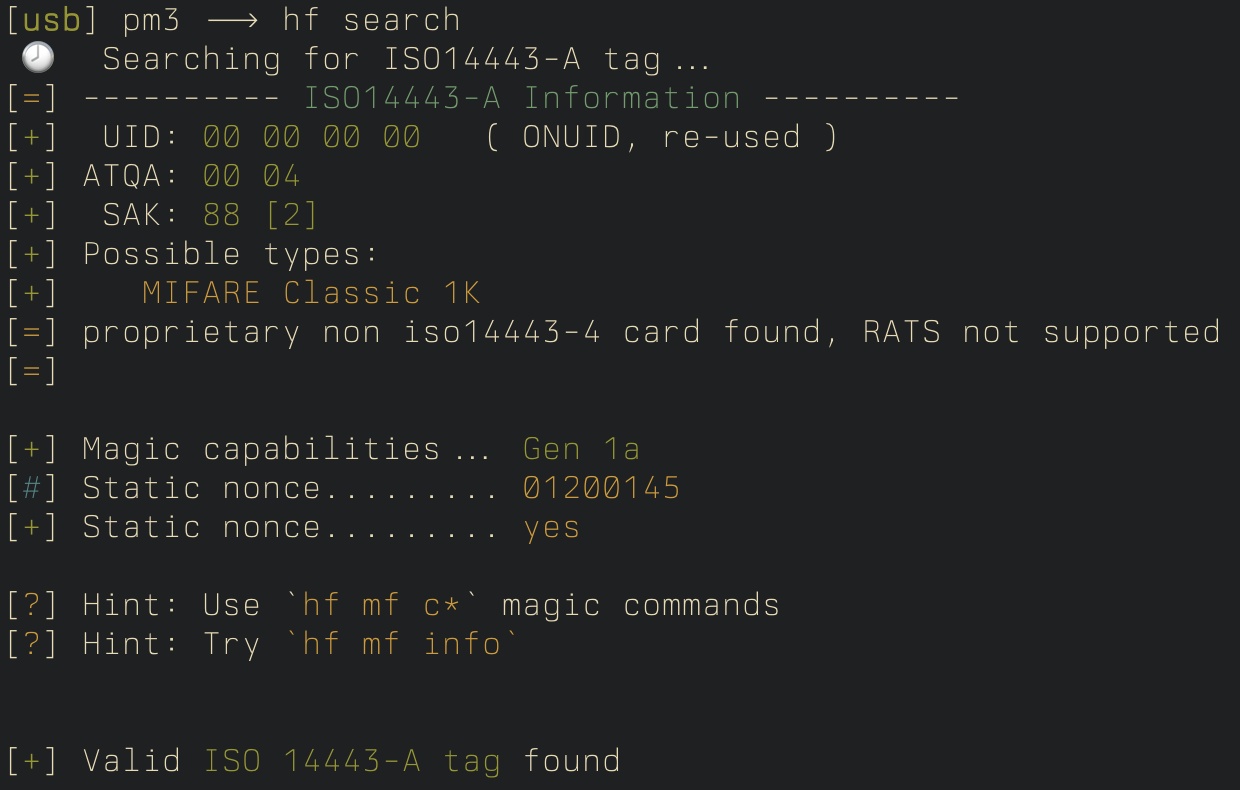

Welp I’m pretty sure I screwed myself with some admittedly careless writes when trying to clone a card, but I’d appreciate a second opinion. This is on the magic ring listed here.
But seems like I can’t read anything.
[usb] pm3 --> hf mf rdbl --blk 0 -k 000000000000
[#] Block   0 Cmd 0x30 Cmd Error 04
[#] Read block error
But at least I can still change the uid?
[usb] pm3 --> hf mf csetuid -u deadbeef
[+] old block 0... 0000000000880400C814002000000019
[+] new block 0... DEADBEEF22880400C814002000000019
[+] Old UID... 00 00 00 00
[+] New UID... DE AD BE EF  ( verified )
Any suggestions on a path forward? (if there is one)

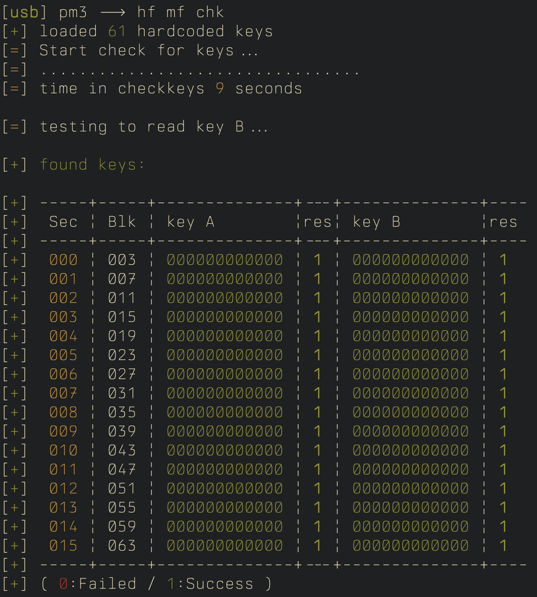

[+]  Sec | Blk | key A        |res| key B        |res
[+]  000 | 003 | 000000000000 | 1 | 000000000000 | 1
[+]  001 | 007 | 000000000000 | 1 | 000000000000 | 1
[+]  002 | 011 | 000000000000 | 1 | 000000000000 | 1
[+]  003 | 015 | 000000000000 | 1 | 000000000000 | 1
[+]  004 | 019 | 000000000000 | 1 | 000000000000 | 1
[+]  005 | 023 | 000000000000 | 1 | 000000000000 | 1
[+]  006 | 027 | 000000000000 | 1 | 000000000000 | 1
[+]  007 | 031 | 000000000000 | 1 | 000000000000 | 1
[+]  008 | 035 | 000000000000 | 1 | 000000000000 | 1
[+]  009 | 039 | 000000000000 | 1 | 000000000000 | 1
[+]  010 | 043 | 000000000000 | 1 | 000000000000 | 1
[+]  011 | 047 | 000000000000 | 1 | 000000000000 | 1
[+]  012 | 051 | 000000000000 | 1 | 000000000000 | 1
[+]  013 | 055 | 000000000000 | 1 | 000000000000 | 1
[+]  014 | 059 | 000000000000 | 1 | 000000000000 | 1
[+]  015 | 063 | 000000000000 | 1 | 000000000000 | 1
[+] ( 0:Failed / 1:Success )
[!] ⚠️  Invalid Access Conditions on sector 0
[!] ⚠️  Invalid Access Conditions on sector 1
[!] ⚠️  Invalid Access Conditions on sector 2
[!] ⚠️  Invalid Access Conditions on sector 3
[!] ⚠️  Invalid Access Conditions on sector 4
[!] ⚠️  Invalid Access Conditions on sector 5
[!] ⚠️  Invalid Access Conditions on sector 6
[!] ⚠️  Invalid Access Conditions on sector 7
[!] ⚠️  Invalid Access Conditions on sector 8
[!] ⚠️  Invalid Access Conditions on sector 9
[!] ⚠️  Invalid Access Conditions on sector 10
[!] ⚠️  Invalid Access Conditions on sector 11
[!] ⚠️  Invalid Access Conditions on sector 12
[!] ⚠️  Invalid Access Conditions on sector 13
[!] ⚠️  Invalid Access Conditions on sector 14
[!] ⚠️  Invalid Access Conditions on sector 15
hf mf cwipe
Works like a charm. Solved, thanks.
