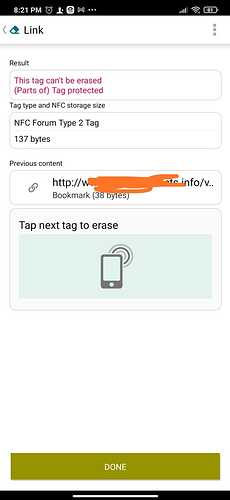

I have password protected my nfc card.
Now when I try to remove the password.
I got this error
Please let me know if there is any solution for this error

I have tried NFC tagwriter by NXP to remove password,
1st:- it this app is not letting me to type my password e.g I type “T” ?nothing happens I type “C” it types C.
no able to type some words.
2nd) my password consist of more then 10 words, this app has only 8 words limit.
I have tried to remove protection it did not work.
I have tried to formate my ntag it did not work either.
Why I want to remove password?
I want to add different function in tag that’s why. but I don’t know why I am not able to remove password I have tried other apps too. entered correct password still not working.

Let’s forget about your password for a moment, have you tried simply writing a new dataset with TagWriter by NXP?
This sounds like the input is only accepting hexadecimal numbers, which are 0-9 and ABCDEF … usually two numbers equals a single byte value, which can be translated to an ASCII value.
But, I can tell you that the NTAG213 only supports a 4 byte password value, so for you to say you entered 10 words… that seems to fundamentally break the 4 byte limit.
How did you set the password in the first place? What tool or app or software did you use? Can you walk us through that process?
