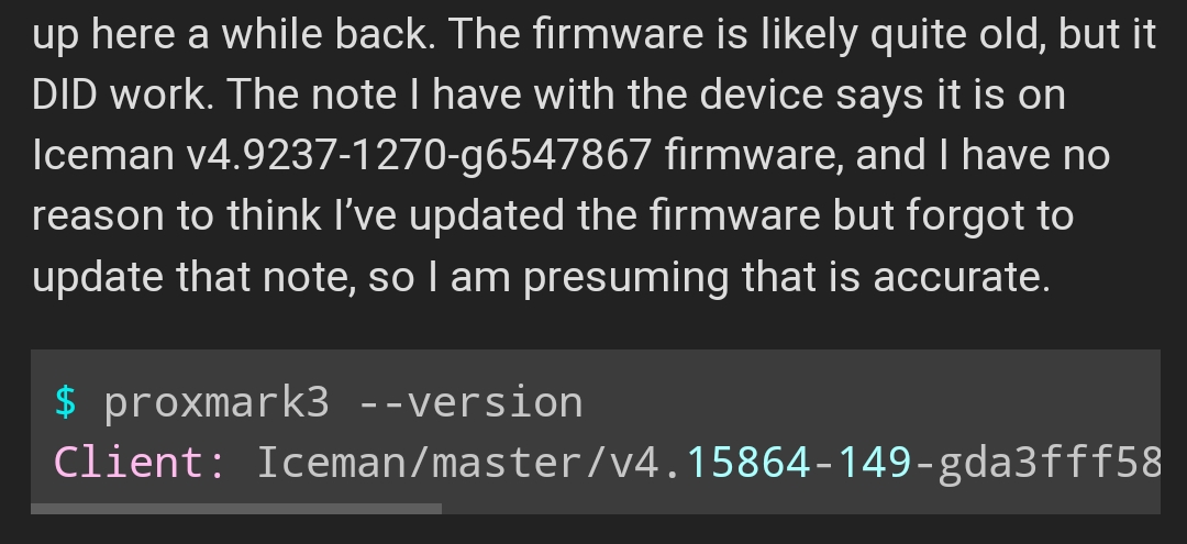

I’m running up-to-date Pop_OS! (an Ubuntu derivative) and have a Proxmark3 Easy with the Iceman firmware I picked up here a while back. The firmware is likely quite old, but it DID work. The note I have with the device says it is on Iceman v4.9237-1270-g6547867 firmware, and I have no reason to think I’ve updated the firmware but forgot to update that note, so I am presuming that is accurate.
$ proxmark3 --version
Client: Iceman/master/v4.15864-149-gda3fff58f 2022-12-18 12:17:56 a3d49350c compiled with GCC 11.3.0 OS:Linux ARCH:x86_64
I have verified that all dependencies are installed, ModemManager is not installed.

Is it a firmware mismatch? The note for the firmware and what the client version says is different. Are you able to pull the latest release and flash the bottom first, then the full image?
right! That’s likely the issue. Thanks. I’ll give it a shot when I get some time and let you know.
That, and plugging the proxmark into a different USB port did it. For some reason it wasn’t getting mounted at /dev/tty*** until I plugged it into a different port, then I was able to flash and update. Cheers!
Oh shoot! Didn’t think about the USB port. Glad you got it working again!
I’m 99.9% sure I tried other USB ports on the laptop before, so I’m sure it was the firmware but figured I’d mention it for posterity if someone finds this later.
