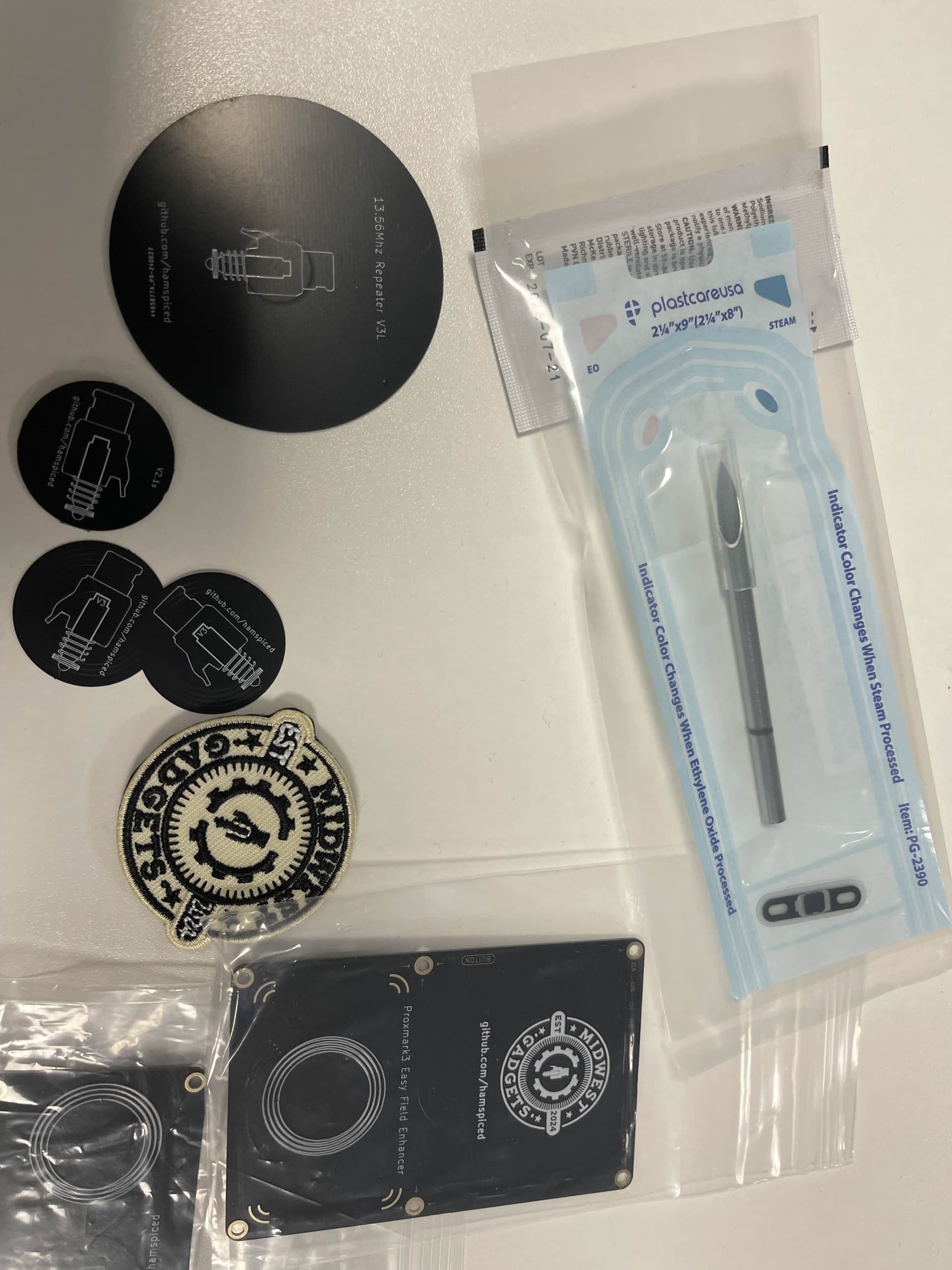

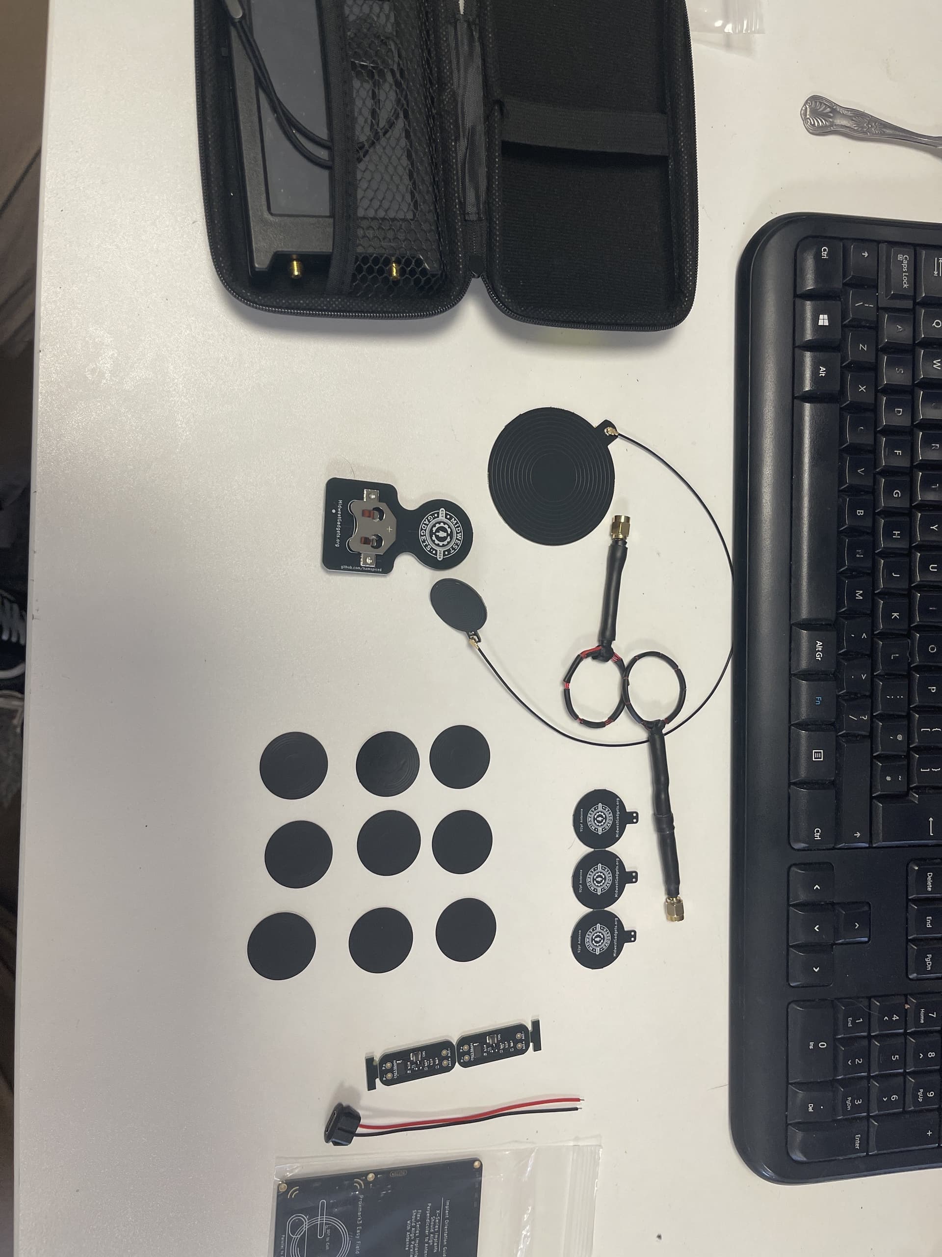

DT sent me some items from Widwest Gadgets with my UG4, and @Hamspiced himself sent me a hoard of items when sending me a VNA to borrow to diagnose some issues I was having.
And this is my review.
Below are the items I received:

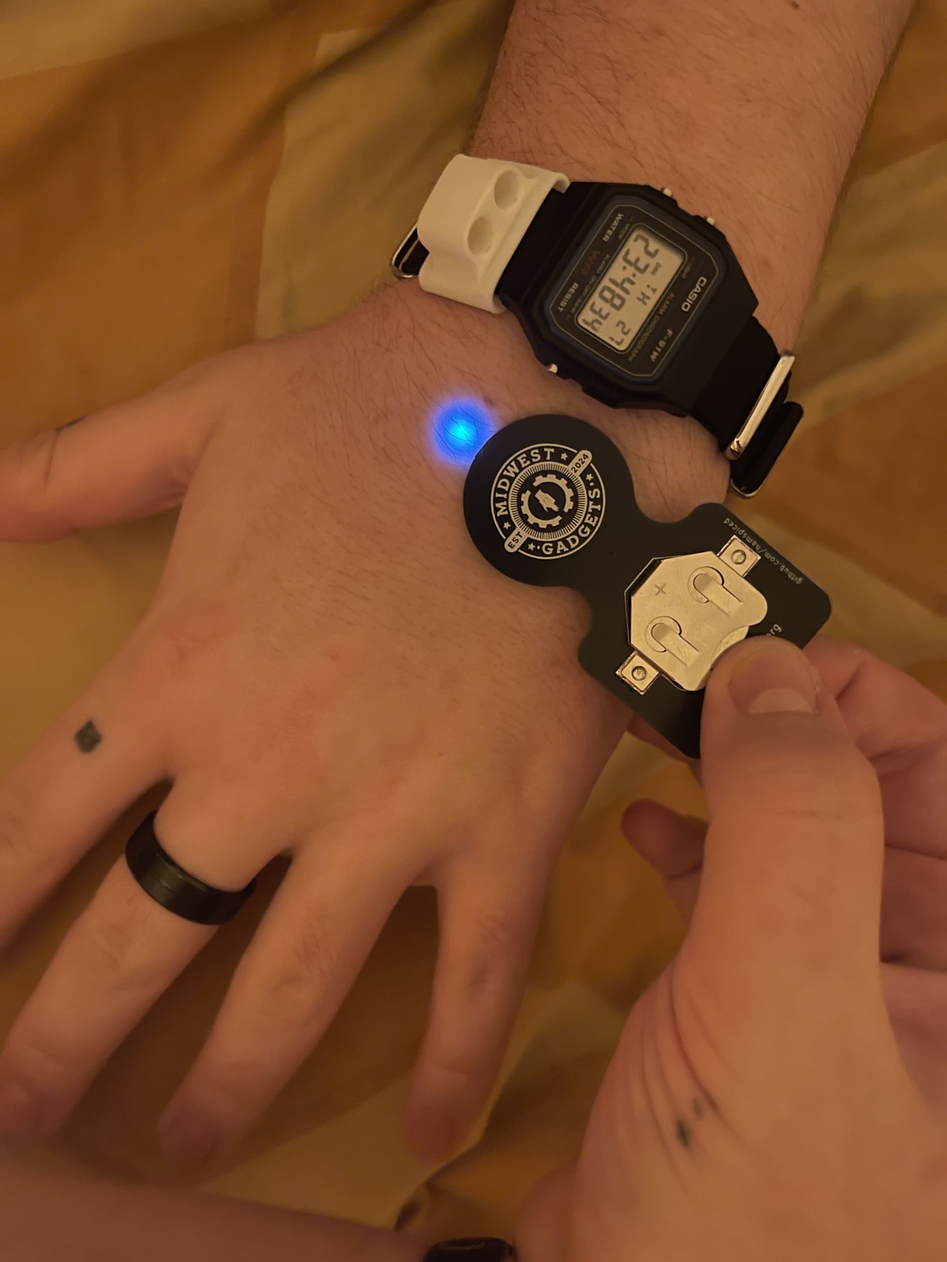

These things are nuts, usually showing off my LED’s involves twisting my phone around, using an app to produce a field, having to quit the app and go back to the main screen because it scanned the implant and turned the field off, a whole bunch of annoying and kind of embarrassing fumbles to show off my lights.
The field generators are tiny and powerful. Anyone I have sustained contact with has been forced to see my implants glow because I always carry this bad boy with me, and having it lets me control how long it stays on, which means no fumbling and tumbling with my phone.
If you have an LED implant, you need these; they speak to the whole reason we HAVE LED implants, to show the fact our skin glows, they’re convenient, cheap and make the experience so much cooler.

Now, this one won’t be for everyone but for those of us who can use it, this extender is wild.
Connecting two passive coils together via a wire which you can choose the length of, lets you hide whatever device you are using to read and process a tag or reader and instead present a discreet non obvious pad instead.
I’ve already used this to palm a cred and a reader during a red team engagement, with the other end tied to my proxmark in my bag. It currently sits with one antenna taped to an ACR, with the other side running onto my desk to keep it out of the way and to ensure good quality coupling for while i do mass tag provisioning.
