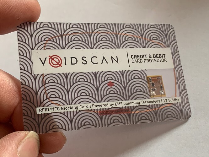

I don’t know how scientific this experiment is but if I place the RFID blocking card (image at start of post) on my ACR122 reader it goes completely blind.
This card appears to have a chip and an antenna and made big claims when it launched on Indiegogo. Not proof exactly but seems legit.
I don’t see an actual chip in that card, but a couple passives and a transistor (?) package. Educated guess is that it randomly modulates the field to prevent data transfer.

I can’t get the FAQ page to load so I can’t see much. I can see this “What is RFID Theft?” page but I’m not educated enough to know how real their claims are. As a laymen all I am hearing is “your cards are at risk from hackers who can be up to 20 feet away”. Not knowing any better I bought six cards in their Indiegogo launch and gave them to family members.
Was I duped? It seems to work (with my somewhat simple test).

If it functions, you weren’t duped. But 20 feet away is BS and contactless credit card theft is not a super big concern.
They probably work, but certainly not worth $20. You can accomplish the same thing by putting another 13.56 MHz card in you wallet such as an old hotel room key.
