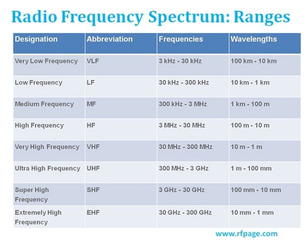

maybe it will be clearer with these pictures
picture 1 (https://www.advancedmobilegroup.com/blog/whats-the-deal-with-rfid-frequencies)
picture 2 (What are Radio Frequency bands and its uses? - RF Page)
What is the difference between : Range (picture 1) and Wavelength (picture 2) ?

Wavelength is the distance from peak to peak of the wave. Range is the distance at which the RFID tag can be used.
Like radio, sound has a wavelength and a frequency, but they also have an amplitude. So here is a thought experiment.
You take two people and put them on a stage. Now you stand at the back of the theatre. You get one of them to sing a low note, and the other to sing a high note at the same volume (amplitude). You can hear them both from the back of the auditorium.
Now you get one of them to whisper. You can’t hear them. Then you get the other to whisper. You still can’t hear them.
The wavelength hasn’t changed but the amplitude has and thus the range has.
The speed of a wave is calculated as the frequency multiplied by the wavelength. As the frequency drops, the wavelength increases. But the range is more to do with the amplitude.
The lower the frequency, the greater the wavelength
The lower the power, the lower the transmission distance (excluding other factors).
