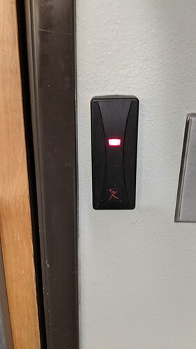

So every reader in the building works with my new NeXT, except this one. Any idea if there is a sweet spot or something I’m doing wrong? All the readers are ProxCard II

Looks like a GE T-500SW. I don’t have any hands on experience nor have I ever seen one in person.
Double check with the diagnostic card, those are migration readers which can have HF and LF active at the same time. Since you’re using a NExT, it might be getting confused which one to read.

If I could open it up, is there a way to disable the high freq side?

Yep, that will tell you what frequencies are operating.
You will also want to use your xFD to find that sweet sweet sweetspot
