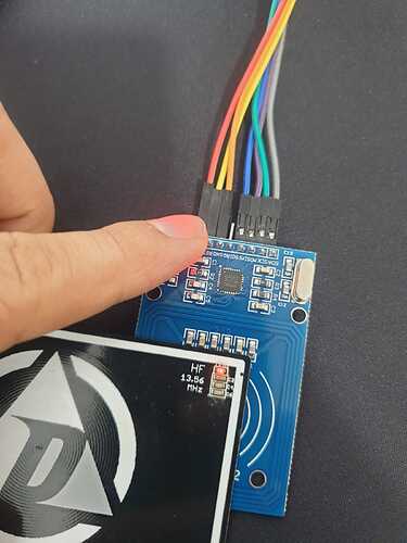

This is the PN532 from DT.

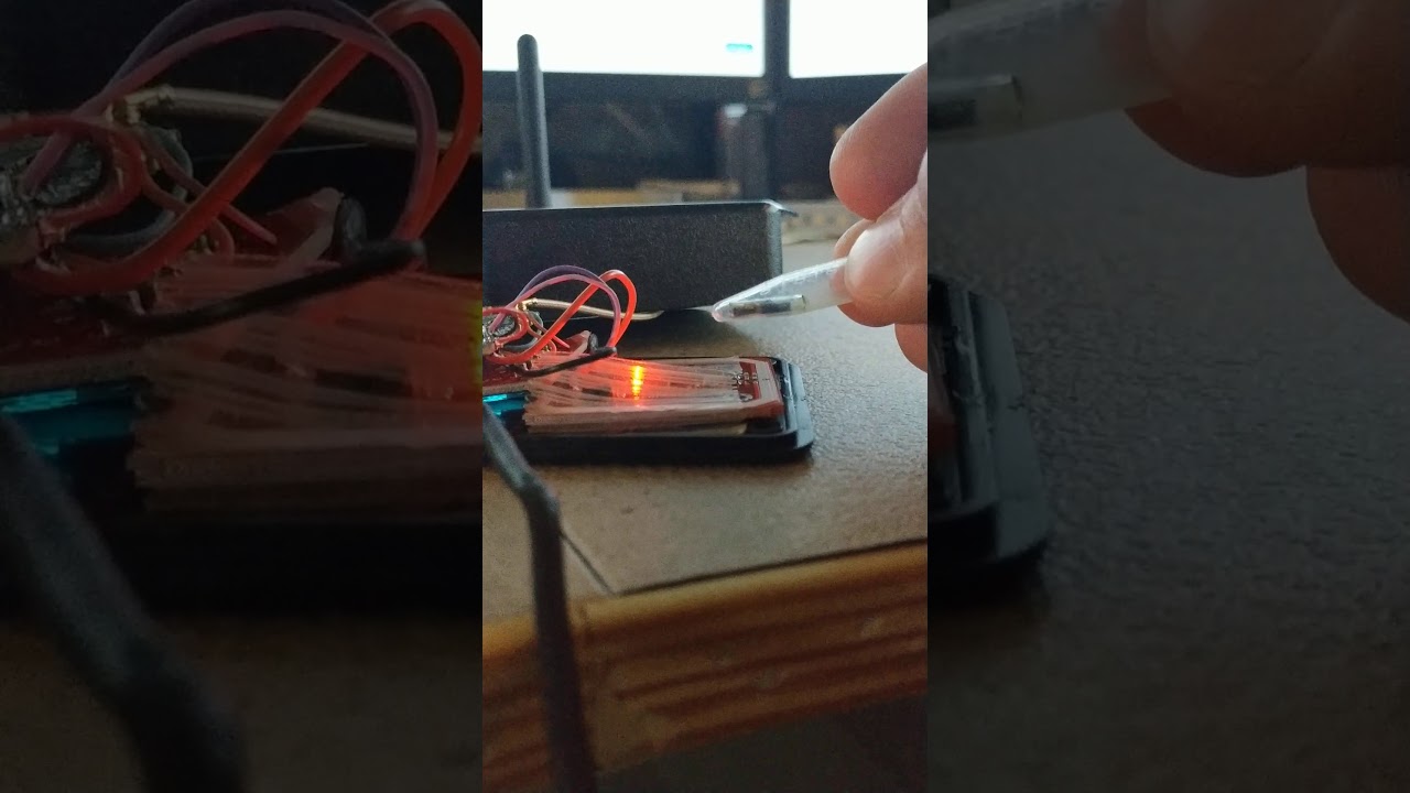

Showing xLED
My implant needs to be less than a centermeter to read even though the xLED starts to light up more than a cm away. But it will read NFC cards about 12cm away.

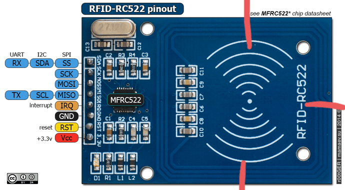

Ive had the same problem with my RC-522 that was included in some kit from aliexpress.
The problem was solved when i tried using 5V instead of the recommended 3.3V. Now it works without any problem.

Have done that, but still no response, with 3v3 and 5v, also I just put the diagnostic card and with 3v3 got a small light only when i put the led near the antenna of rc522, with 5v the led bright a little more.
WHat else could it be the problem? I am posting the image of the diagnostic card

The next must lie across the coil I.e. if the coil is square one of the edges put the next half on half off the pcb.

You want to lay the chip like this
