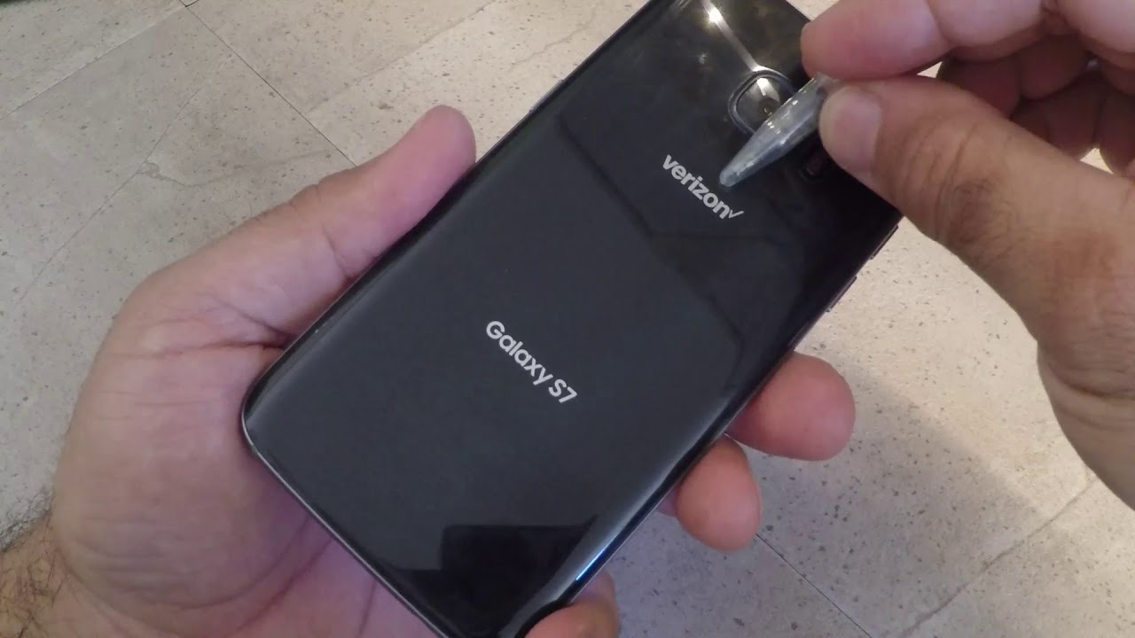

The NeXT comes with a password by default, so you can’t use the DT app to set the lock bits. Try using the X-field tester (if you got one) to find the best position to have your NeXT put to it, and the best orientation. Since it was implanted relatively recently, the read range may not be at it’s best condition yet.
The NeXT is already locked. You do not need to set a password with the DT app.
See this video for your other question.

If the field detector doesnt light up alt all, then its a good indication it will be very difficult to get it to read a tag. Did you watch the video I posted? Unlike a card or a fob, the glass tag’s location and orientation in relation to the antenna is very critical.
