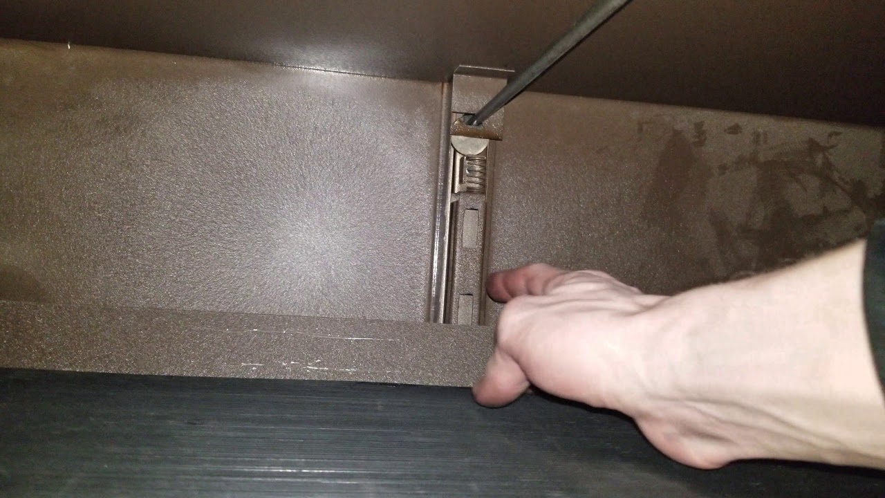

To be able to contribute, I would need to see the locking mechanism, I am assuming it works on a cam?
Regardless of that, If I felt like I needed to lock my toolbox, The first thing I would do, would be to remove the tubular lock, However, if you ever lost your key you could still very easily get in ( Under 10secs )

Please note the spring. It allows the mechanism to raise up when locked, so that a drawer can be pushed shut if it was open before locking it. WDTSF is going to exploit that, by rasing it up with a solenoid, allowing the drawers to be opened, EVEN THOUGH, the lock is still in the locked position.
Good video, So yes it uses a cam.
SO another train of thought would be taking a lineal force and converting that to rotational
or better yet a Rotary solenoid
Nice find! I was wondering why it took so much force to raise it, that spring in there could probably be reduced.
I do want to keep the tubular lock, I don’t need actual security just want the cool factor of the rfid and the backup to get in if the batteries die.
You could also use a cable and pulleys to move the actuator / solenoid / motor someplace more convenient.
Sorry to say this but there’s a ton of options, and it’s gonna hafta be up to WDTSF to find something he’s comfortable with.

I ordered some stuff on eBay to play with, like a mini linear actuator that has the right stroke length and size to fit in that space, but I still don’t really know much about this kind of thing. It probably won’t arrive for months. I should get the rfid access control system soon. This is going to take me a long time to put together I think. Looking at rotary servos too. I played with removing that spring entirely and it seems to self lock just fine with gravity alone, so I think a lightweight servo could work too. Wish I could find someone in the PDX area to trade skills with that can put this together for me, haha.

now as a mechanic with an oversized and flashy Snap-On toolbox that has many sections and drawers I’m thinking an electromagnet and a spring on the opposite end. i’m not sure yet which goes where as to if the magnet should lock or unlock and the spring return to position.
with an electromagnet when the system is powered it would deactivate and the spring would push the lock bar up causing all drawers to unlock and remain that way. when the chip or fob is removed then the magnet would reactivate. the problem I see here is the distance on the striker plate from the magnet as once the power was removed there’s a potential for the magnet to lock the toolbox automatically and each time a drawer needed to be opened you would have to swipe the fob or chip to unlock it
