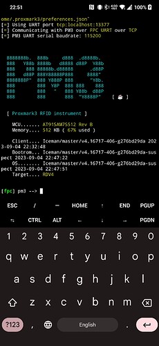

Install F-Droid then termux
aftrerwards pkg update, then proceed with install steps - installing compiler and deps, cloning the repo and build the client. Because I do not have root on my phone, I also needed the TCP/BT UART bridge app. Install it and set it up as document suggests. Open tcp server with listening port on device A and select bt device/the blueshark on device b. Then go back in the termux and connect the client to the tcp listening port on localhost. Open a beer and enjoy the show!
it literally is that simple. I just finished up the install on my s23 ultra a couple days ago. FINALLY got away from iPhone and immediately remembered why I preferred android all those years. Works great with termux.
