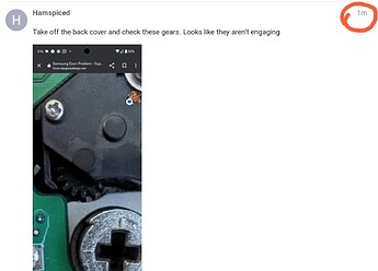

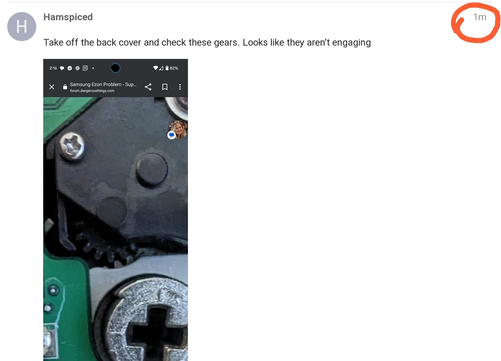

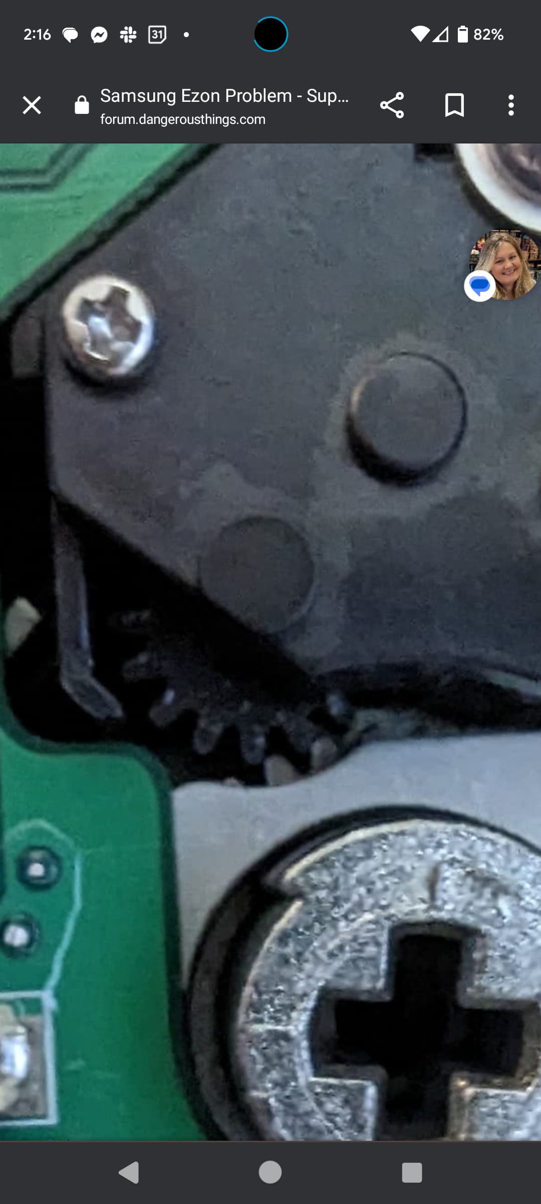

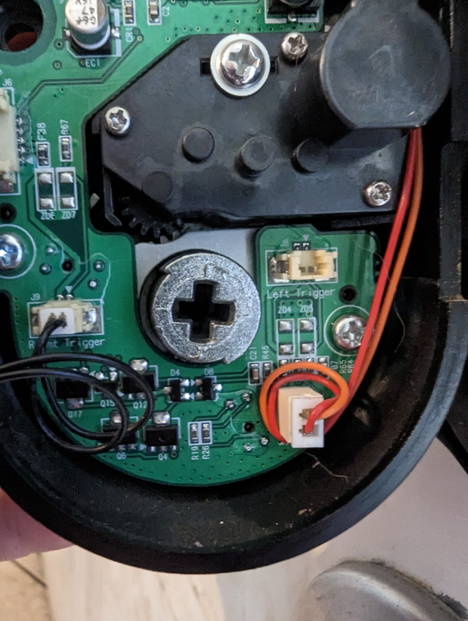

Take off the back cover and check these gears. Looks like they aren’t engaging

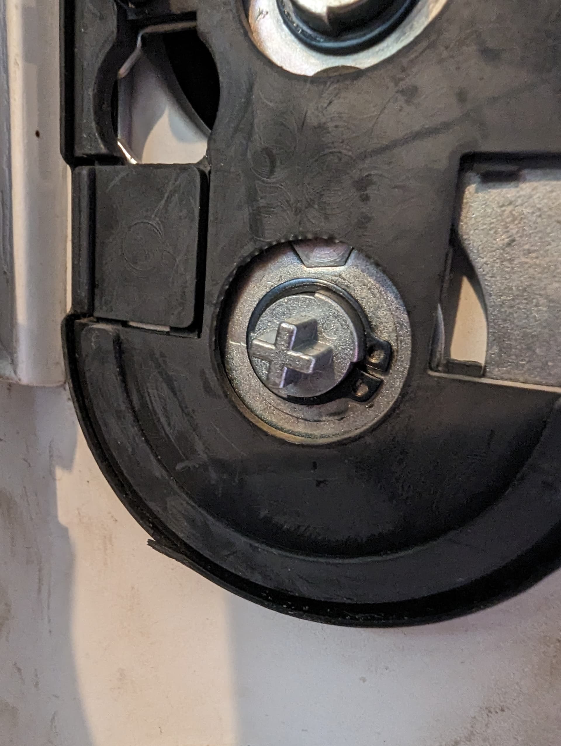

The next thing you should do is adjust the tension on the three mount screws that hold the back plate to the front plate. If they are too tight then you will create a binding friction on the bolt rotation mechanism. The plates that mount the lock to the door should have just enough tension to keep the lock firmly on the door but not so much that it creates an alignment problem for the rotator pin that extends from the lock mechanical actuator to the bolt itself.
Oh dang it… I just saw the video. Yeah that seems like a problem with the gear that actuates the rotator. To find out what’s going on you might have to take it apart further and see if there’s any broken parts or something has come off of a post.
What did I miss? It does make a sound like it’s got a missing tooth but didn’t see anything, seemed to be working perfectly fine.
Chances are a screw holding a gear in place is loose and so it’s not skimming a tooth it’s just like running underneath the gear… at least that’s what it seems like to me.

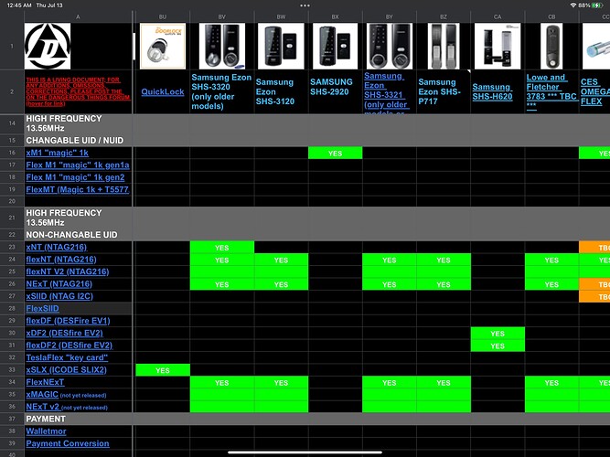

Thanks all. I’ve got a temp lock to put on while I try to take this apart further. If this isn’t something I can fix, can anyone recommend a good replacement that’s compatible with the xNT? I’m rather fond of this style lock.
have you checked
Briefly. I’m a little confused why the flexNT would work for some but the xNT won’t. Honestly it seems like unless I get the same lock I’m kinda screwed
I don’t see that anywhere in the doc but I assume it would have to do with range. Flexes are much easier to read for weak readers.
