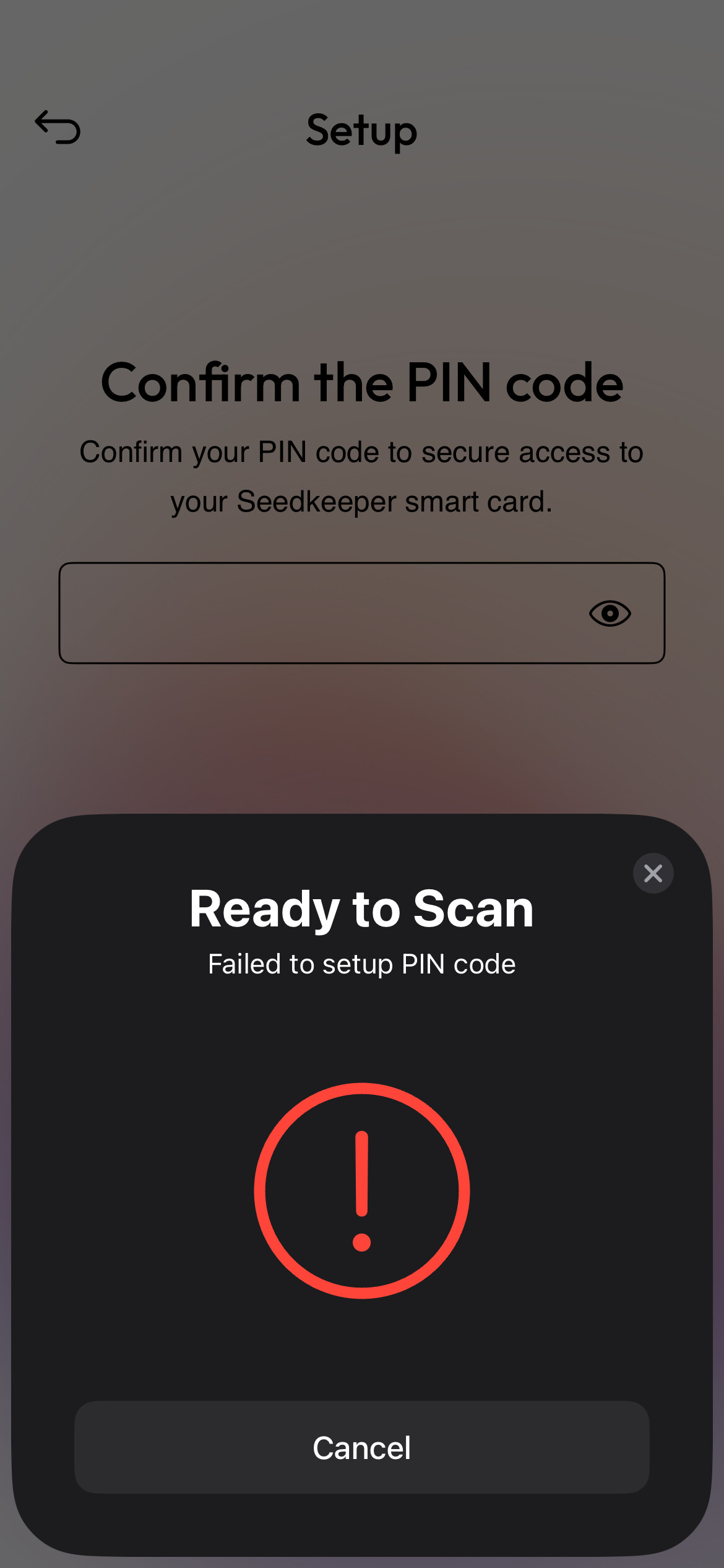

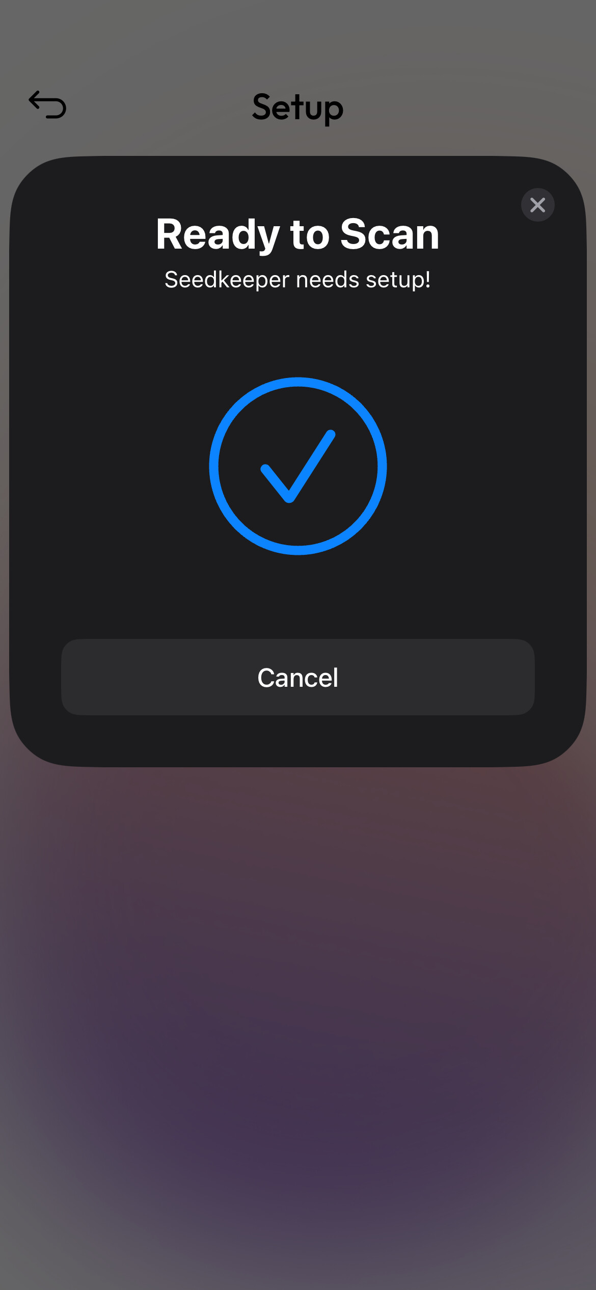

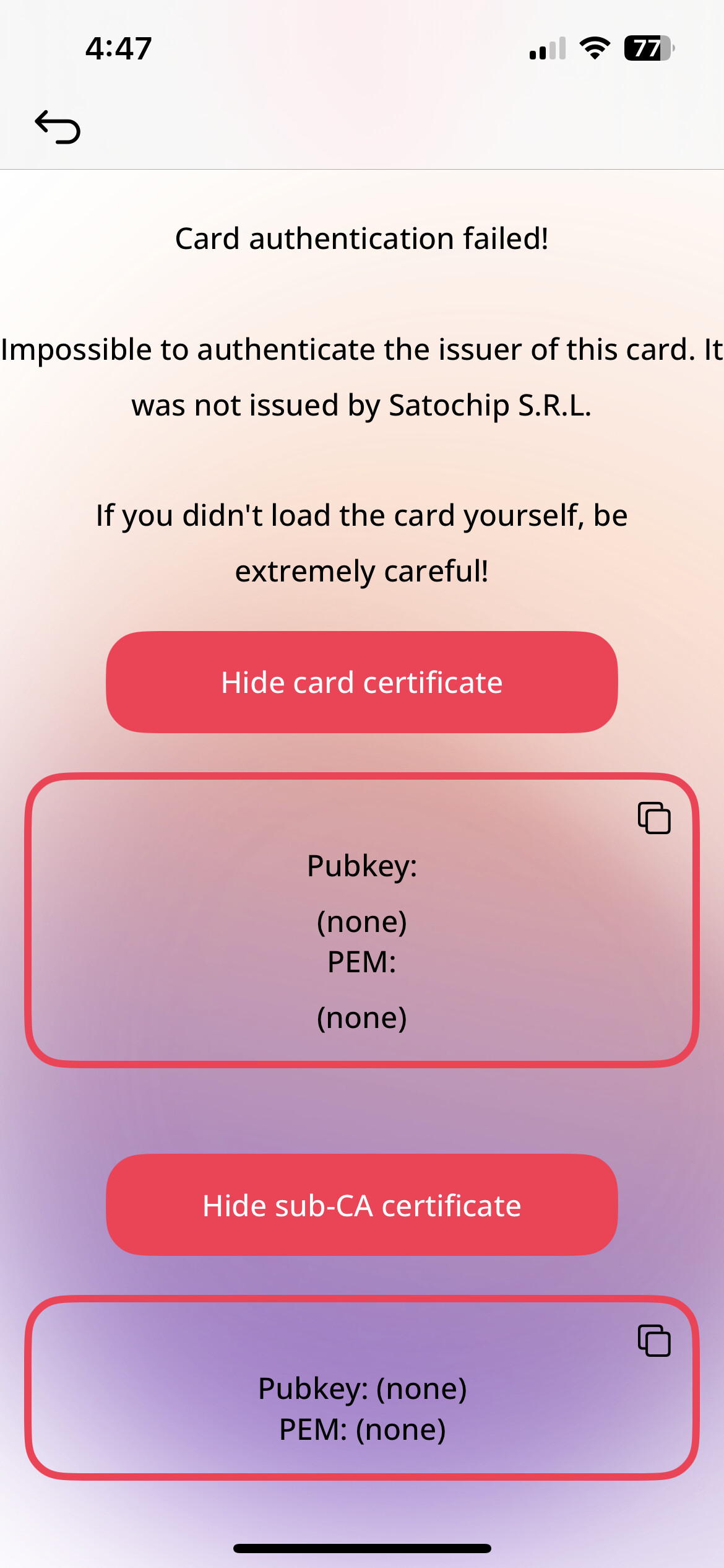

it reads the chip fine initially and alerts that it needs to be setup, then fails to setup. when looking at the reason why, it seems it’s lacking issuer authentication.
here is the initial scan that gives me hope
when confirming the pin for setup and scanning again, I get this error

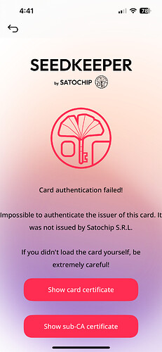

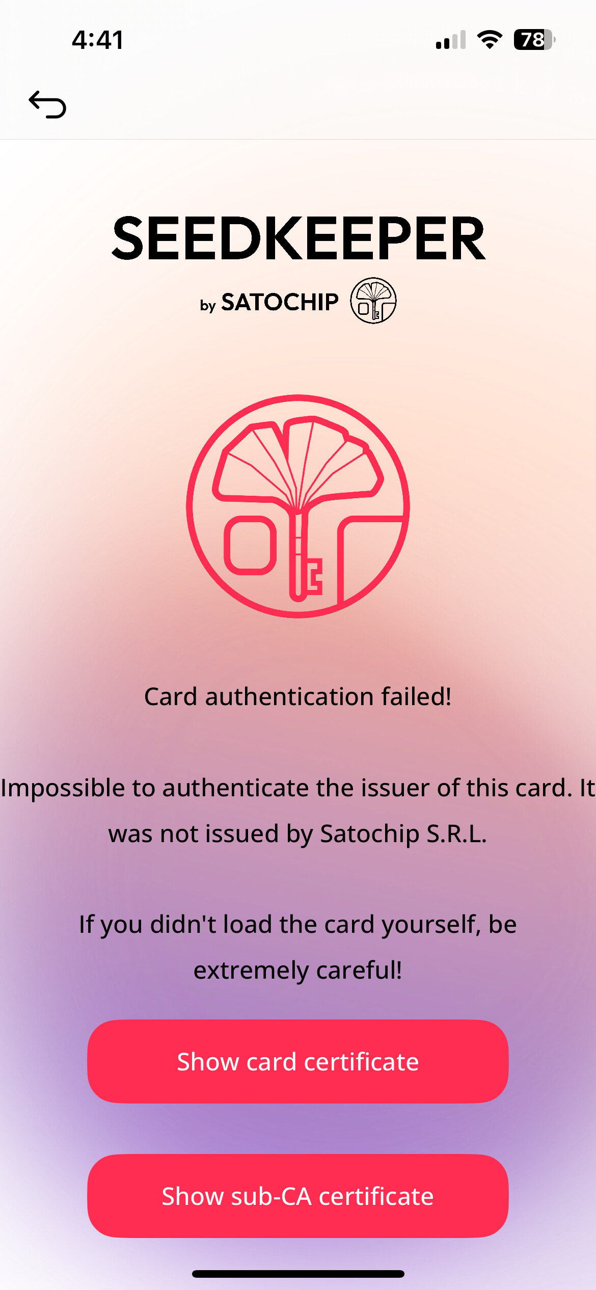

investigating the error more, it seems it lacks the authenticity of a real card

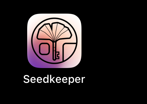

this was also the only seedkeeper app in the App Store that I could find, so I’m assuming it is
Satodime is the other app. Their naming conventions are confusing. SatoChip is the company (project?) as well as the name of one of the applets. I suspect that SatoChip is supposed to be SeedKeeper + Satodime.

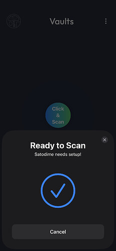

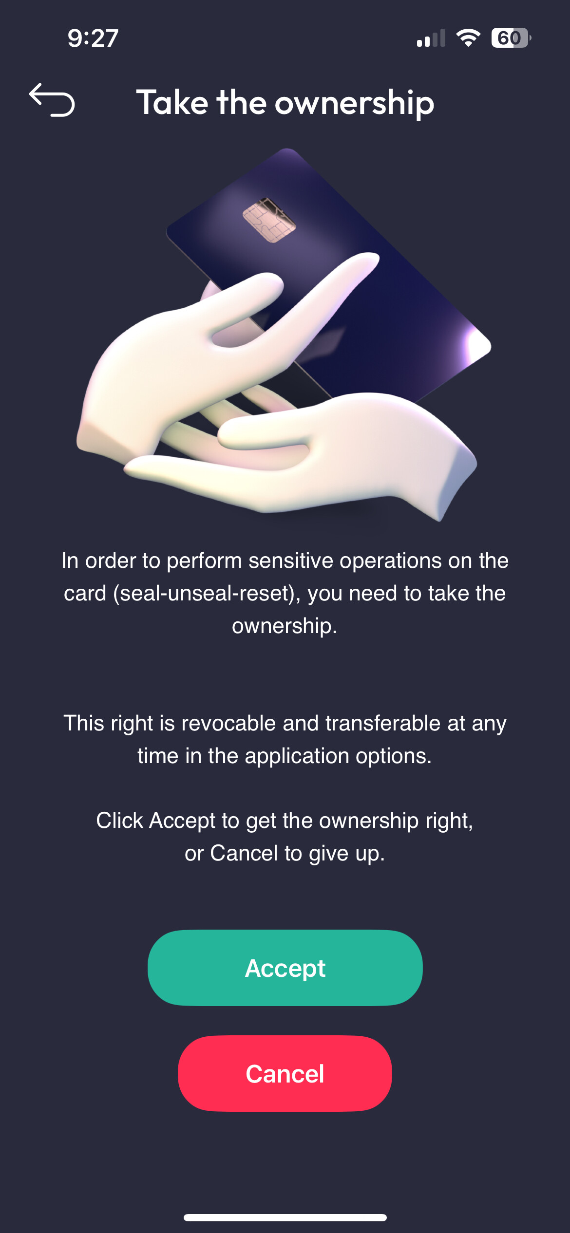

got excited there for a second haha i downloaded the satodime app, but same issue. first it scans, says it needs to be setup
asks to agree to terms bla bla bla, then asks to scan again
where it fails like before.

That’s just seedkeeper–the actual wallet appears to be part of Satodime, if i understand. SeedKeeper works fine. Satodime doesn’t install–it throws an error. SatoChip installs but doesn’t work with either mobile app so shrugs
Satodime is not supported on the Apex chips, as it is meant to be run on tokens which are passed around.

it’s really strange because when it finally did setup, it alerted me that it wasn’t a satochip issued card and to be careful hahah. anyways, thanks everyone for the responses, I have a feeling that this requires the perfect conditions and then perfect angle and timing when scanning and then some added luck from the universe. I’m happy to keep playing with it if anyone else wants this on their flex :slight_smile:

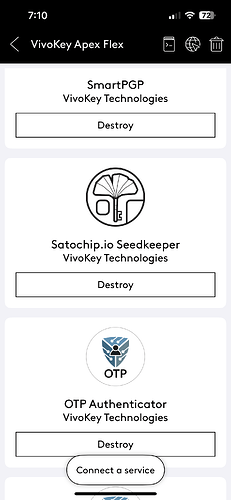

I’m not clear and what is what here (there is a version of the SatoChip app that is supposed to include SeedKeeper [SatoChip + SeedKeeper] which I downloaded from the repo–not Fidesmo–and installed on my test card–it didn’t play nice with SeedKeeper). You have an Apex, yeah? And you’re installing from Fidesmo? if so, there are two options: SatoChip.io SeedKeeper and SatoChip.io. To do what you want, install SatoChip.io SeedKeeper. Next, use the SeedKeeper mobile app. That works for me.
By works for me I mean:
  • I open the SeedKeeper app on my phone
  • hit the “click to scan” button
  • scan
  • it prompts for a pin, i enter one
  • it tells me i need to setup a pin and to enter one
  • then confirm
  • then click and scan again
  • prompts for pin
And then I’m in and can add secretts.

yup, i did exactly as you described earlier. there’s an issue when scanning the second time to confirm the pin.
after trying it 100 times, it worked once or twice, then after adding the secret and trying to read it, i had come across the same error. i had to again scan 100+ times and eventually got lucky once and could read the secret.

Edit: @StarGate01 also updated the app names and descriptions in Fidesmo to be a bit more clear.
Wait. So the Satochip.io applet that is available on the Fidesmo app works as Seedkeeper + cold wallet at the same time, but the cold wallet function would only work in a PC? Did I get it right?
Incorrect. Check the current names and descriptions on the Fidesmo app.
