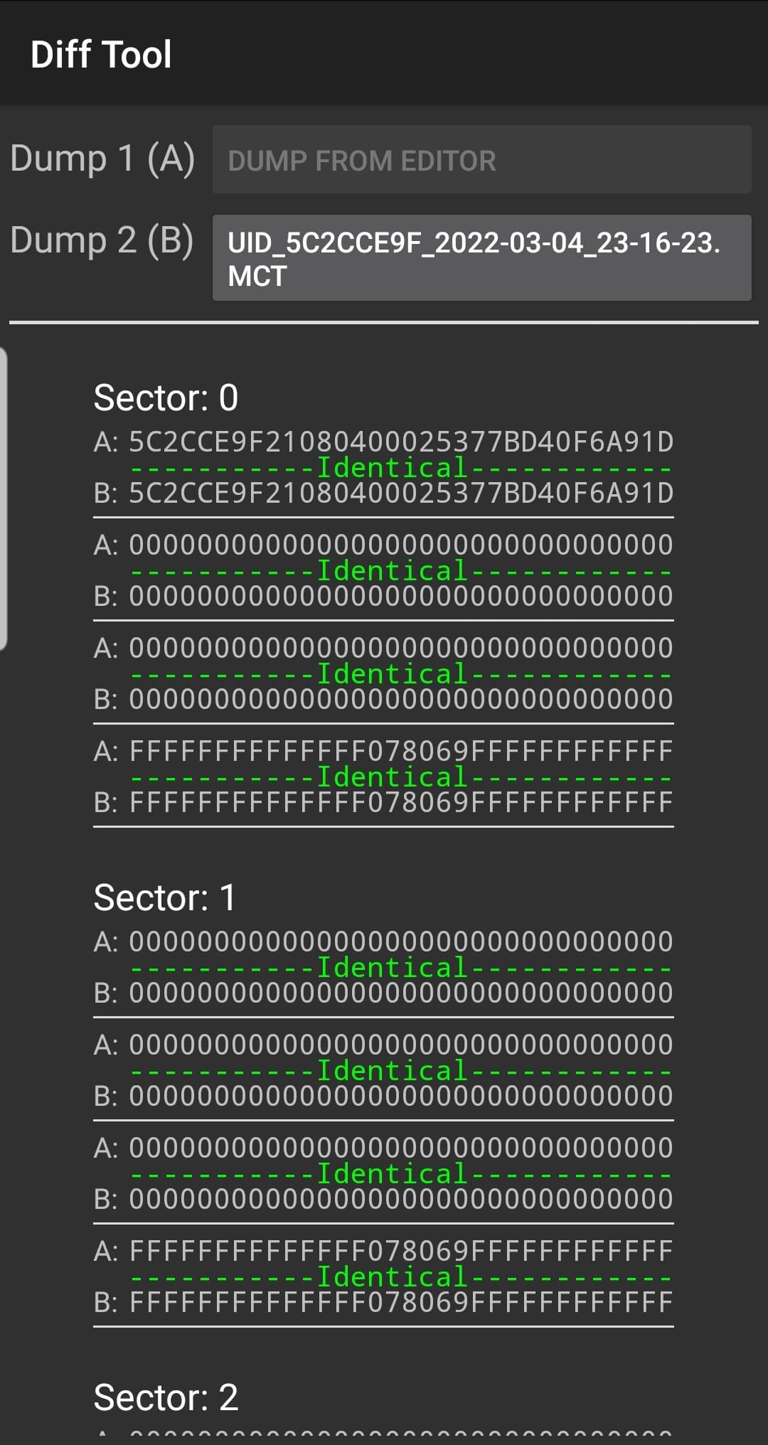

Thanks for the answer! I made a full dump. And all the sectors of the card and the clone are identical. I can’t say 100%, but it seems the scanner doesn’t even notice the clone. Although the original works.

The question here is - how did you make the full dump? If you used MCT to do this, and you did not have keys for a sector further down, like sector 9 or something… then MCT would not be able to dump it properly and it would not be identical.
