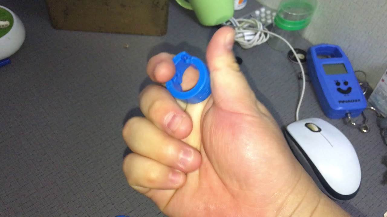

Interesting video of a guy testing the read range with a UHF bird ring tag, first alone, then wearing it around his finger: in the second test, the range is dramatically reduced:

This is the biggest issue. You can see this effect on UHF badges… wearing as they lay on your chest the range is reduced by about 80% … this is why schools that have these badges for kids must put uhf panel antennas directly over the door facing both directions so they are sure to get a 90% read rate on tags passing through… while if the badge was simply held out from the chest by about 12 inches (about a full wavelength) then range dramatically increases since the body is not absorbing the radiation.
The problem with UHF is that it is not a magnetically coupled system. It uses EM field pulse transmissions which sort of “bounce” off the tag… the method is actually called backscatter. Because UHF tags only get a super tiny fraction of the energy the reader panel puts out, and the fact the EM emissions are readily absorbed by water and reflected by metals, interference is a serious problem for UHF. Unlike coupled systems though, if proper conditions are in place, extremely long range is possible. Certain lab conditions set up by RFID hackers achieved over 100 feet!!
