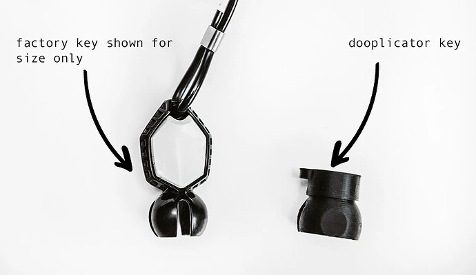

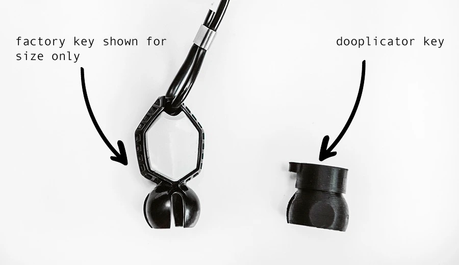

The key (upper Right in pic) snapped onto the post:
And here is a pic of the factory key, and a key made by a 3rd party, that is really just what I want to accomplish. I just want to figure out how to do it myself, instead of using this vendor:
