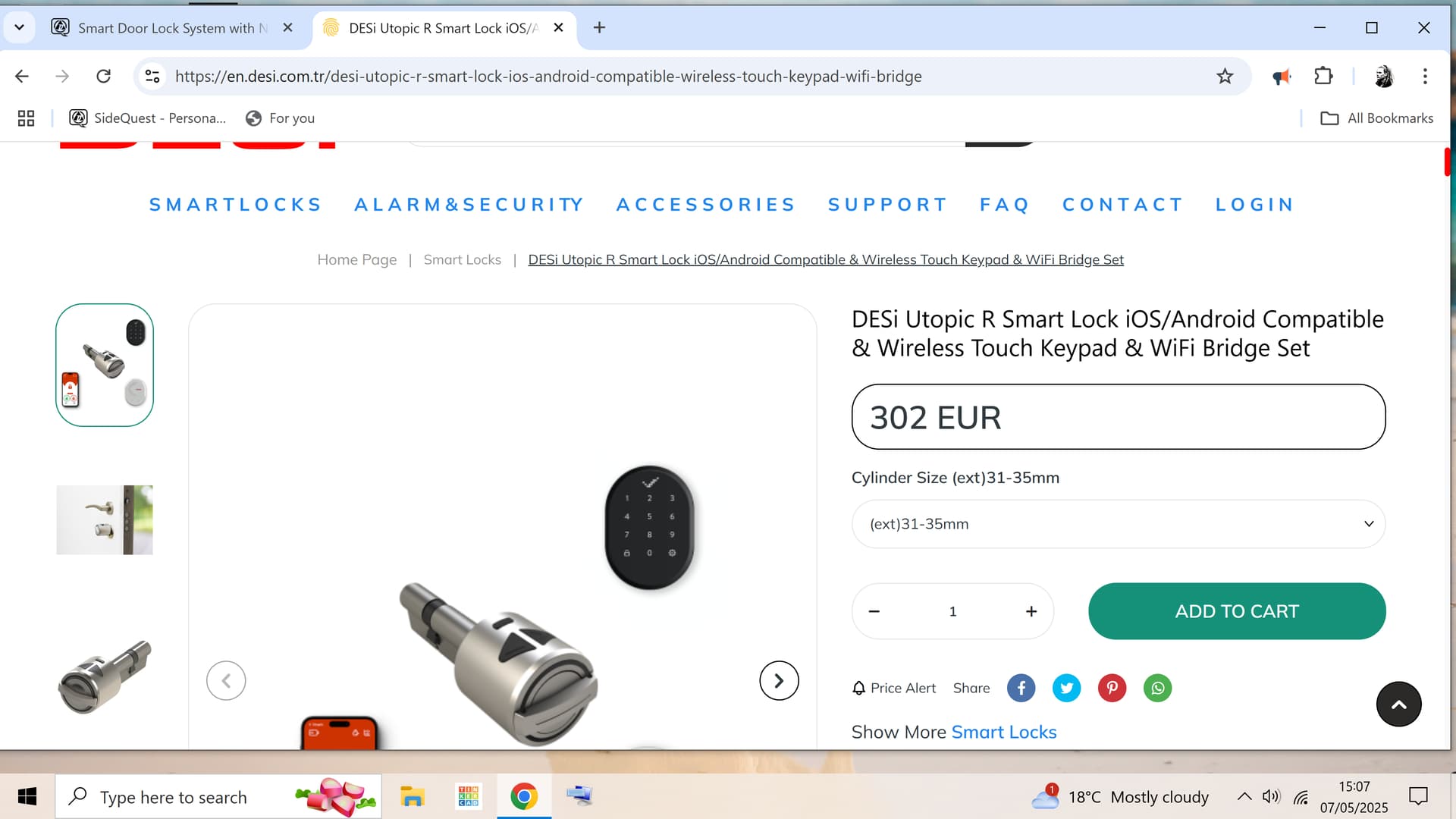

Thats such a great idea. If you need any help. Im on the arse end of such a project. Current Quest - DIY NFC Lock UK - #105 by Chimpofm
Thank you friend. This looks more organized. I was already using an electronic lock. I made an integration on it, but I definitely need to make a case with 3d print.
I was too cheap to buy one of those and would look jank if i try to add periferals to it. so i made one with standard 5mm to 8mm couplers and a pancake stepper. Thats where im at now. We also have code for a soft acsess point for wireless uid management. That May be usefull to you.
Remember… the “S” in “rfid” stands for security.
damn!! did you pay 300 bux for that?!
i need to up my prices lol
it is not too expensive when i bought it. by the way this is bundle not only lock. This is a Turkish brand. When sold abroad, the price may be higher due to customs duties. I think you can find a similar product in your country.
How is it powered, and what happens in the case of a power interruption?
If we are talking about Utopic R, it is incredibly easy to assemble. It has its own battery and can work for 4 months without interruption. I can monitor the battery status via the phone application. It can be charged with any powerbank or 5v charger.
I put a powerbank (20000mah) in the rfid reader system I installed. this powerbank will be activated in case of power failure. On days when I will not be at home for a long time, I turn off the system for security reasons.
it’s 150 bux now (only lock).
