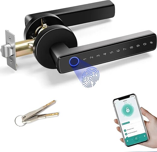

(****) Smart Lock - 5 in 1 with NFC
Smart Lock - 5 in 1 Fingerprint Door Lock, Password, Bluetooth Smart Locks, Biometric Identification Fingerprint Key Digital NFC, Code Locks for Home, Office, Hotel (APP Smart Management)
INTRODUCTION
Simple to install, good build quality, use it with or without app, multiple methods of opening

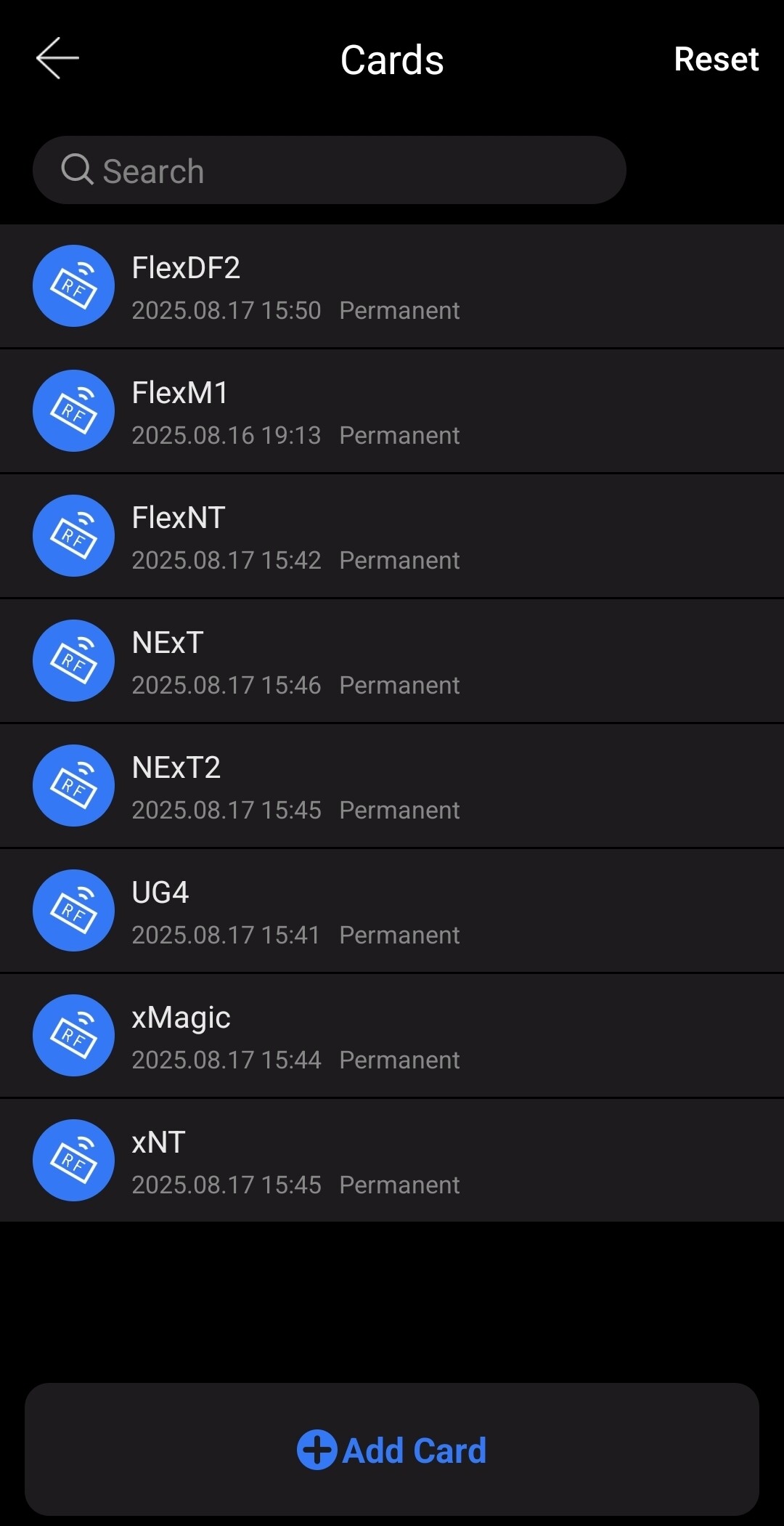

IMPLANT COMPATABILITY
xNT :white_check_mark:
NExT :white_check_mark:
NExT2 :white_check_mark:
xMagic :white_check_mark:
FlexNT :white_check_mark:
FlexM1 :white_check_mark:
FlexUG4 :white_check_mark:
APEX Flex :cross_mark:
Flex Secure :cross_mark:
TESTING INCLUDING READ RANGES
In reality, they all read and when you use it, you will make contact because it’s just easier, but generally, xSeries = Contact, Flex 5mm-10mm
TEARDOWN
N/A
LINKS & RESOURCES
PROs
• Feels like good build quality zinc alloy
• Multiple opening methods: RFID, Key, Fingerprint, Bluetooth, pin code (also CON due to security vulnerability)
• Quick install ~10mins ( Instructions look good if you need them )
• USB-c battery back up, to prevent lock out
• Universal fitting size for MOST (adjustable) and compatiable with left / right doors
• Works with xSeries and Flex implants
CONs
  • Internal doors only ( It looks like it could be used outside, but maybe only if it is mostly sheltered )
  • Uses 4 x aaa batteries - unsure of the life expectancy, Claimed about 3-6 months (8000 openings)
  • Multiple opening methods: RFID, Key, Fingerprint, Bluetooth, pin code = security vulnerability
HACKS
Other than a RSP sticker None attempted -
The Sticker does cover the numbers, and for the sake of realism, it removes the pin pad as a viable option unless you avoid those 2 numbers and have a 8 button option.
Possible Hack, you could tap into the battery compartment and add a Power bank supply.
EXPLOIT
Haven’t tried the common known one, and I like to keep that one one quiet, but I will do and update with the results
PRICE
USD$63
SUMMARY
All in all, a well priced, well made, multi purpose lock that is cyborg friendly

:star::star::star::star:
4 Star from me, Only because it needs a Repeater Sticker to be usable
With the Sticker
:star::star::star::star::star:
:heart: Special thanks to @hamspiced for the Repeater Stickers
Tested, no exploit.
