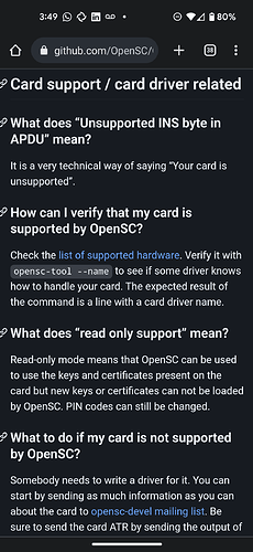

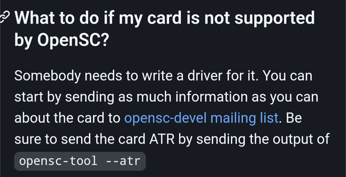

Found this…
Follow the rabbit hole, found this;
Seems there might be a limitation of your reader? Seems odd… but possibly?
@StarGate01 … possibly this?
OpenSC uses PKCS#11 and PKCS#15 afaik, which the PGP applet does not support. We might publish a PIV applet with these protocols sometime in the future.
