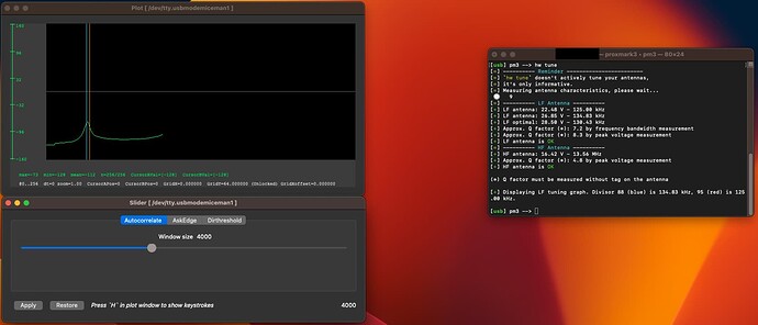

[+] Displaying LF tuning graph. Divisor 88 (blue) is 134.83 kHz, 95 (red) is 125.00 kHz.
[!] :warning: You appear to be on a MacOS device without XQuartz.
[!] :warning: You may need to install XQuartz (https://www.xquartz.org/) to make the plot work.

Okay so your install looks fine from what I can see. I also noticed this in the docu
In order to get the data plotting GUI working, you will need an X server installed on Mac OS. Download and install XQuartz from here: https://www.xquartz.org/, which should work out of the box after logging out & back in to your account.
May sounds stupid but did you tried loggin out and into your account after installing the xquartz ? I took a brief look at the code of proxmark iceman fork but it’s 2 am here so I may be missing something. Also my proxmark is arriving tomorrow so I can test myself and provide some more info. I will keep you posted
Sure enough, just needed to reboot :man_facepalming:t2:
Thanks for the suggestion.
