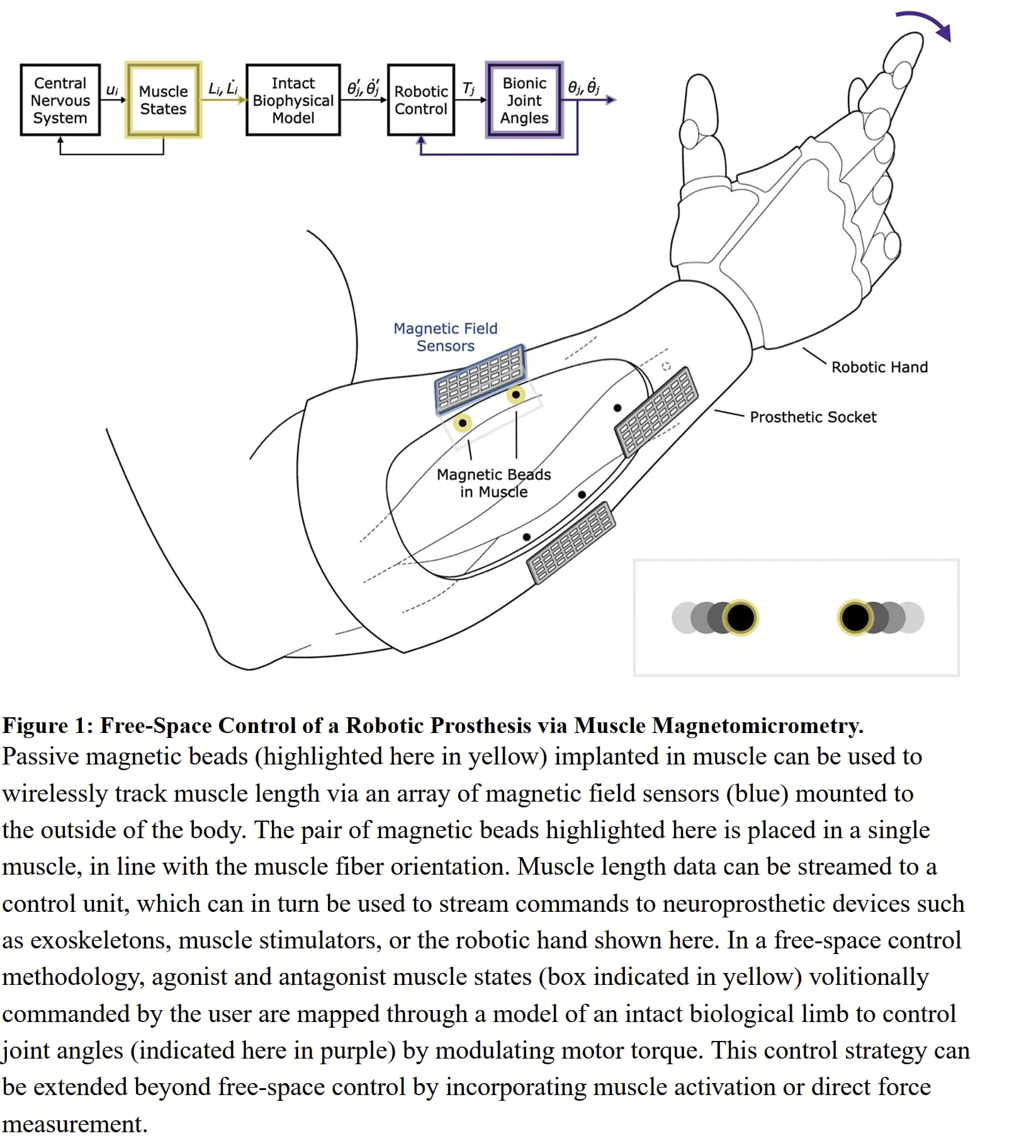

Study on implantable magnets for tissue sensing and interesting findings on biomagnet migration
I found this while browsing around and they explore anti-migration measures in magnetic bead implants as part of their paper.
nihms-1840724.pdf (1.0 MB)
The neat bit:
"The second closest magnetic bead pair, with an initial separation distance measured
at 16.7 mm, did not fully migrate, and was measured at a final separation distance of 13.8
mm at conclusion of the study. In contrast, beads at longer separation distances, above 21.5
mm, were resilient to migration at long timescales (n = 13), suggesting that these magnetic
beads can be safely implanted with separation distances above 21.5 mm. Notably, the bead
pairs at these longer separation distances actually increased in separation distance over the
six-month study (increase of 4% +/− 3%), possibly due to the growth of the turkeys over
this time period, though small changes in distance for any particular pair of beads could have
resulted from changes in passive muscle properties or small variations in positioning the bird
for different measurements.
Basically, there is actually a Goldilocks zone where the force of the magnets counteract the natural migration of the magnets in the tissue.
Just found the whole paper fascinating and thought I’d share.
