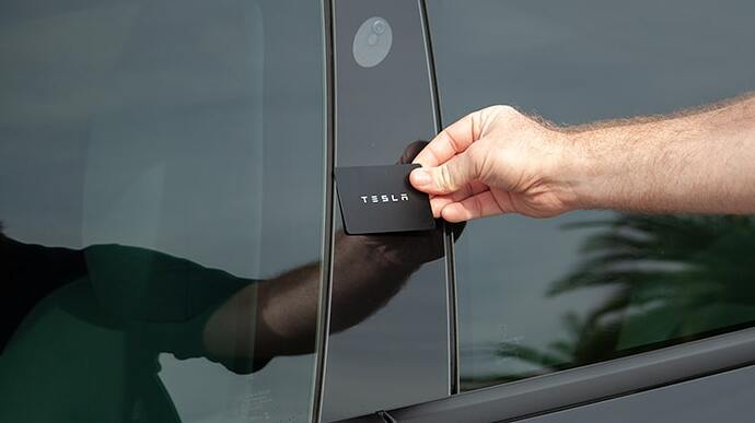

So I’ve had my Apex in for a bit now and registered it with my Tesla model Y with no issues! The inside reader is very easy to find. BUT I feel like a crazy person trying to find the right location on the outside. Does anyone have a model Y have a location I should put a sticker on? I feel like my neighbors are thinking I’m trying to break into my own car as I wipe my hand and try the handles for 15minutes before giving up and going inside just to try again the next day.
I have installed the applet, I did register it to the car, and when I scan inside the car it does switch to the Apex key. I just can’t get the right spot on the piller, or maybe antenna orientation? I assume it would be the exact same as the Tesla key implant.

You may need to hold the implant a cm off the surface to get a good read. Too close and there’s parasitics interrupting a good read. Depending on your install location, I would find another part of your hand to rest on the car that let’s you prop the implant 5-10mm off the surface, and then slowly slide down from above the reader point to past it. Very slowly though because it’s probably pinging on an interval.

I noticed when testing that that Tesla door readers will light up a FD card brightly for a second or two and then reduce power, same with iPhone. Presumably this is to save power but isn’t helpful with a chip/card/etc which takes some time to run it’s applet all while having no external means of knowing this is occurring.
I suspect this also happens when you present an implant so you might have more luck taking your hand/arm/meatbag away for a second and then going again rather than moving your implant around in the vicinity of the reader for more than a second or so.
