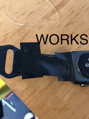

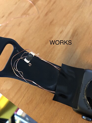

In the meantime, this is what I’ve done.
1: Melt a card in acetone, like you did
2: Extract chip and antenna
Now the tricky part. Carefully curl and fold the antenna, while repeatedly testing it on the car pillar to see what shapes and orientation still works. This takes a lot of trial and error before you’ll find something that works.
I then put that into my watch band with some simple electrical tape. If you need to have any curve to the antenna, like what is needed in a watch band that curves around your wrist, you’ll want to take that into account when doing the folding and testing)
Works well enough for now. I can’t wait for the Apex to come out!
Oh man that’s jank
glad you got it working though
I see it working and still don’t believe it LOL Congrats.
I tried that as well and was never able to get it to work consistently. May try spreading it out across the watch band like you show above. Thanks.

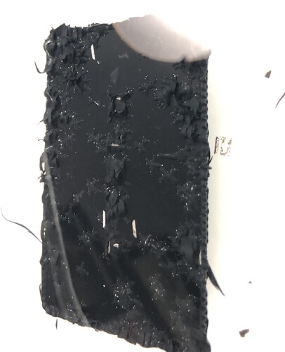

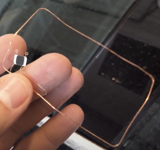

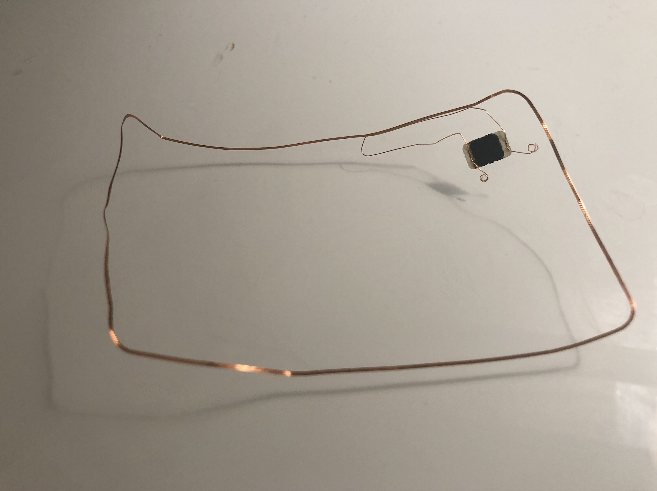

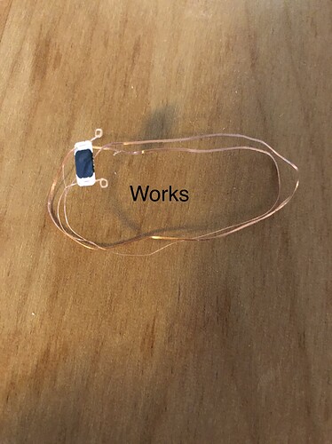

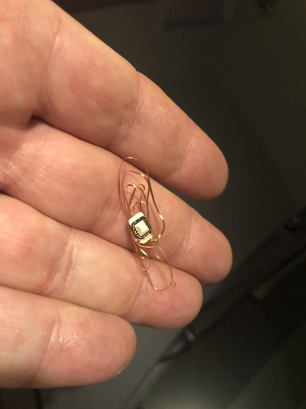

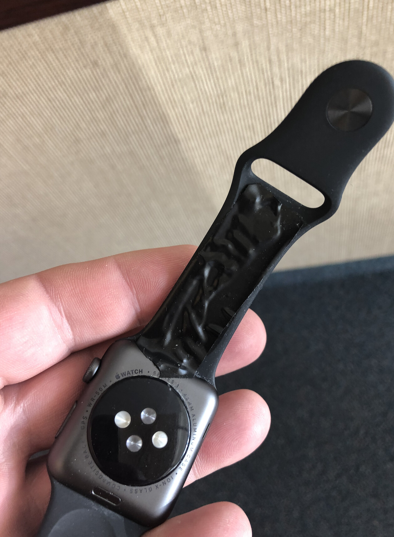

You inspired me. I was able to get it to work in very few tries based on your pictures and my previous efforts. Here are the pics. Thanks again for showing this. NOW to get it to wrap around a ring core so I can wear it as a ring. Hmmmm.
Looks like I’m limited to one photo per reply so showing the middle step. I’ll try and post the other photos in separate replies.
Proving the old adage “if it’s ugly and it works, it aint ugly” ![]()
I think I’ll co-op that adage. I like it. Thanks.
